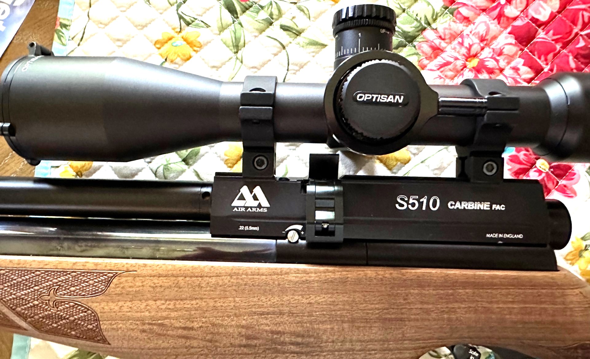

BKL (self-centering) low mounts will work swimmingly with that scope on that rifle. I buy mine off Amazon but they only offer them in singles, so I have to order two for a pair. I prefer single screw single ring for my air guns. They are drilled on one side to fit the screw in bubble level. Very useful when setting up on a bench.
BKL 303 0.6" Long Dovetail Scope Ring - Low - Single - for 30mm Scope Tubes - Fits 3/8" or 11mm Dovetails - Matte Black - Made in Texas, USA.​
