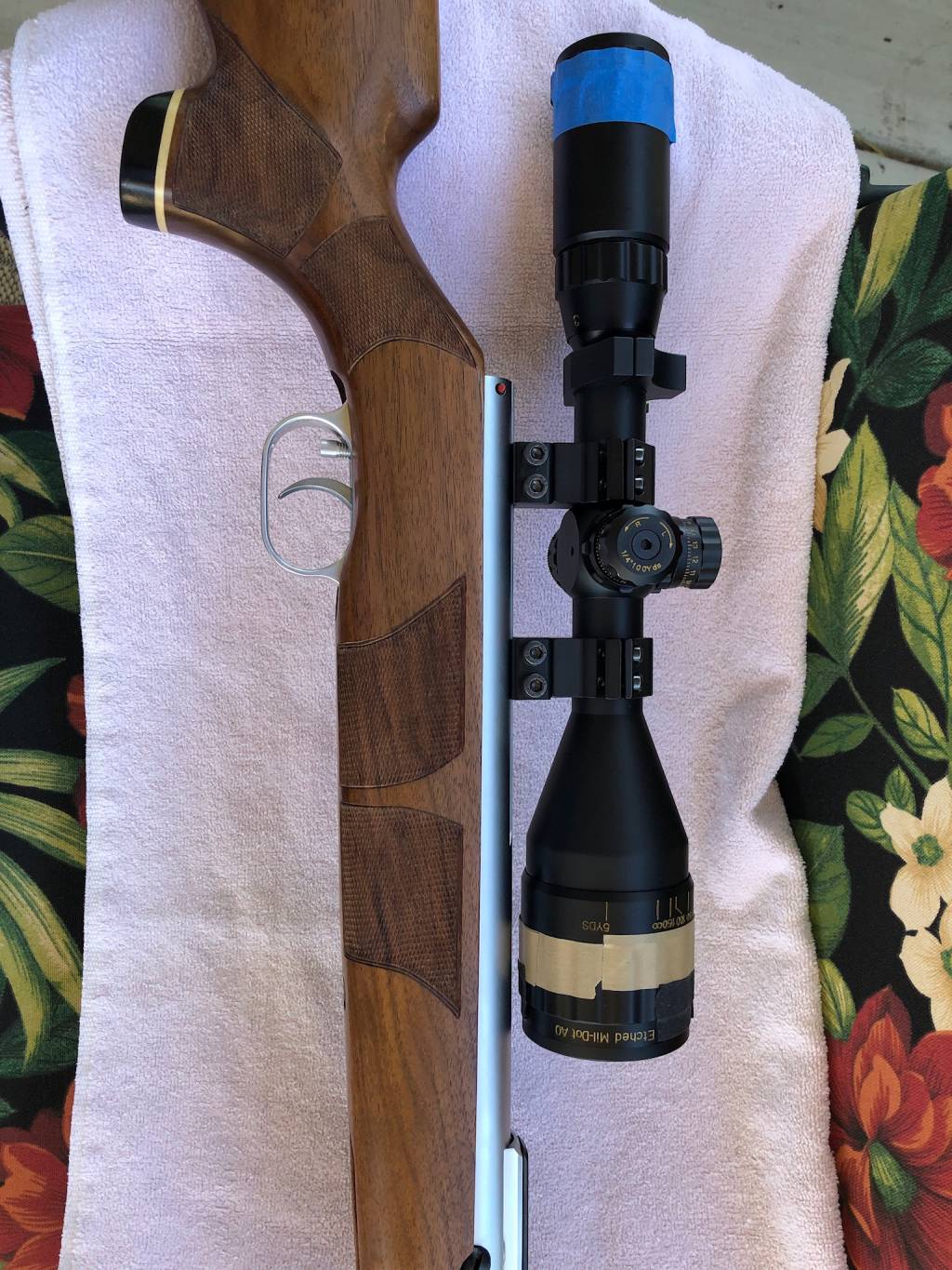

Flintlock....my Beeman R7 .20 with a Hawke Airmax 3-9x40 AO scope. The rings are reversed Hawke Reach Forward Match mounts which are also a favorite since I like my scopes to sit back some on my rifles.
