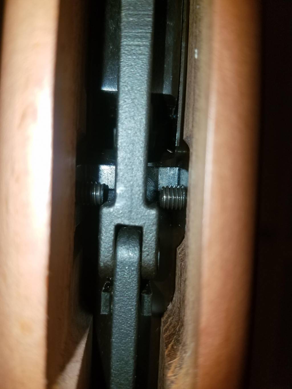

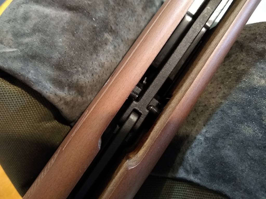

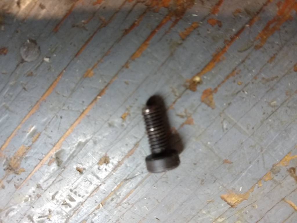

I think I figured out the problem with the low flyers on the Parrus. You guys who were talking about barrel lockup were correct, but not because of a dirty breech. Turns out that the two screws that secure the forearm of the stock to the action were impinging on the cocking linkage when it was nearly at full extension, and not allowing the barrel to close in a consistent fashion. If you look carefully at the picture you can see that the tabs that these two screws thread into were actually starting to bend forward a bit from the impact and pressure generated when closing the breech. I replaced to two M5 screws that were about 12mm long with a shorter ones that clear the clevis on the cocking linkage and shot the rifle, and while the vertical flyers were gone, and groups tightened up considerably the gun was now shooting about 10 MOA high. Apparently what I had written of as barrel droop was actually caused by the barrel not being fully closed. before the linkage collided with the stock screws. The "group" on the chicken represents what I was getting before the fix. After adjusting the scope for elevation I shot the group that you see on the pig. I shot both of these targets with Crossman Premier 7.4 gr pointed tip pellets.

Parrus owners may want to check these screw to see if they have a similar problem

Mine don't touch, but they are very close. There is no reason that those screws need to be that long, I'll replace them to be on the safe side of future frustration.
