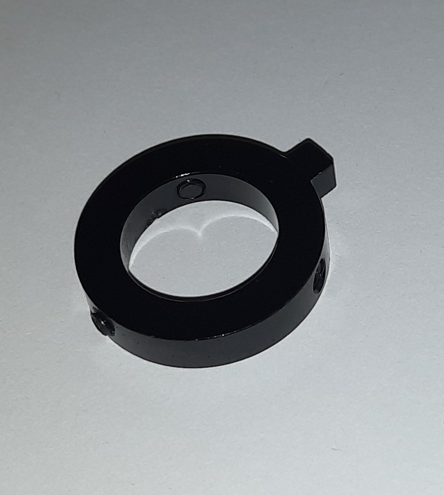

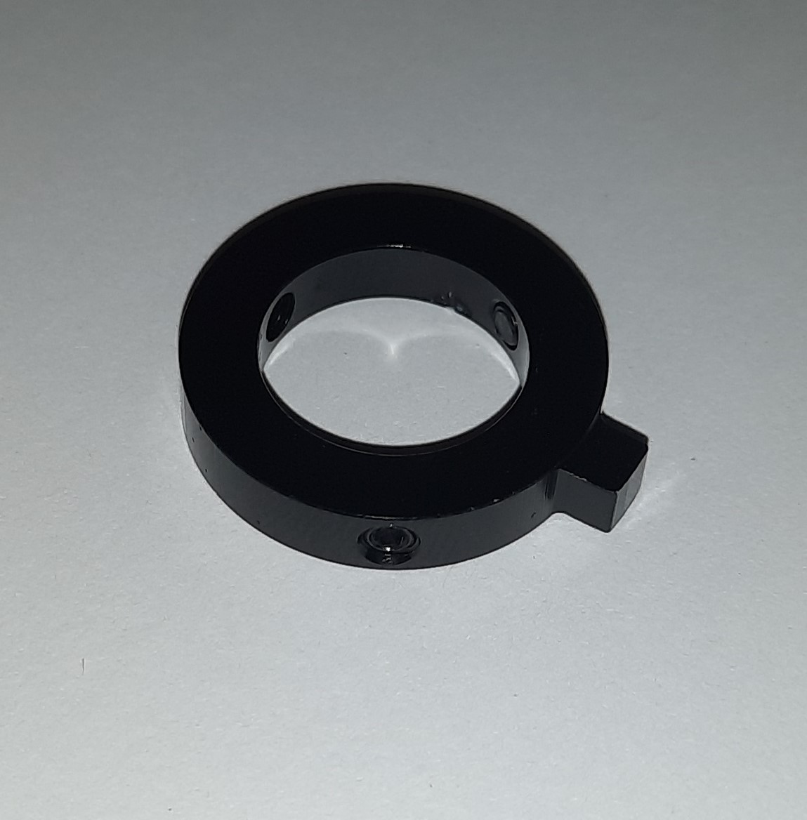

So, after watching a couple of videos on the Optical centering I noticed my windage adjustment had 5 complete turns and my elevation adjustment had only 2 complete turns.
I took the elevation turret cover off and found a piece that looks like some sort of zero stop or something.
After removing that piece, I now have 5 full turns of elevation as well. I'm going to re-install the scope and see if I can zero it now!
Here is the piece I removed.
Reactions: jarmstrong
