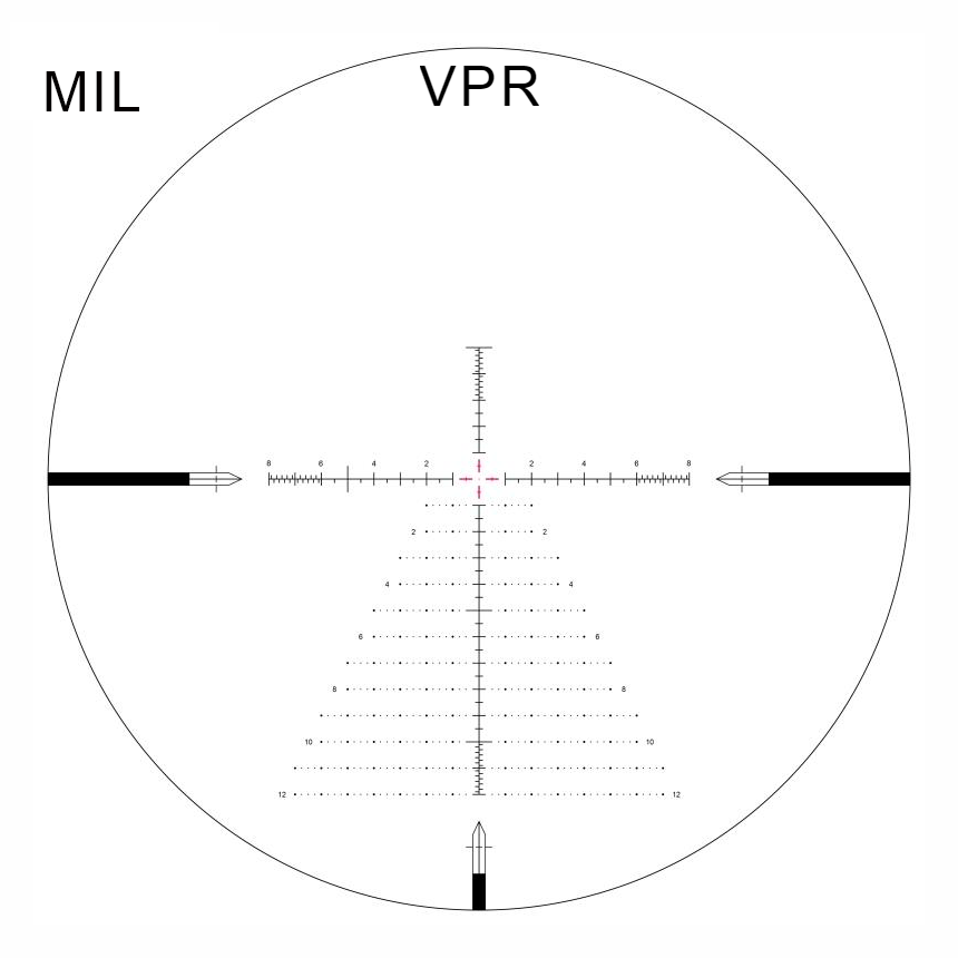

love the reticle on my arken sh4
christmas tree is there if i need it,
but it doesnt clutter my view,
as the windage dots are very fine.

yes the arken is what i would call standard type christmas tree,
that picture of the reticle makes the dots seem larger/bolder than they are.

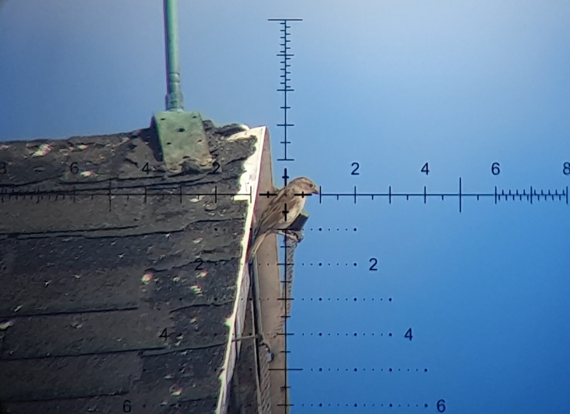

heres a scopecam image that shows my arken reticle,
christmas tree is there if you need it,
but it also doesnt just command your attention unless youre looking for it.
Looks good. 👍🏼
A ctually, I find very few FFP scopes with a 6-fold* or higher magnification ratio that do NOT have a gridded reticle (= Christmas tree reticle).
🔹I used to think like you: "If I need the grid, it's there, if I don't need it, it does no harm." 👍🏼
➧ However, since I started scopecaming I do wish I could buy big magnification ranges with a simple holdoff reticle (crosshairs with hash lines) — because in a video the dots DO clutter.... 😆
