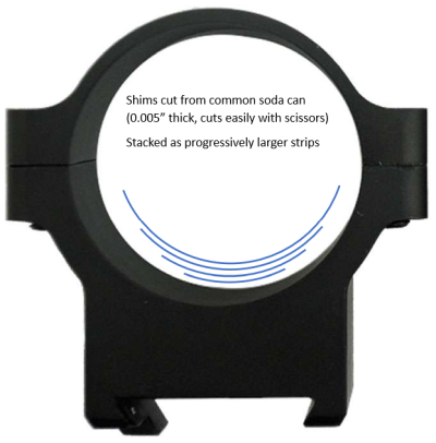

I used a shim cut from a latex rubber therapy band. It's about .008 when compressed and worked perfectly. Held tight. Latex rubber decomposes and won't last forever. But it makes a great shim and won't damage the scope. It's cheap and easy too.
