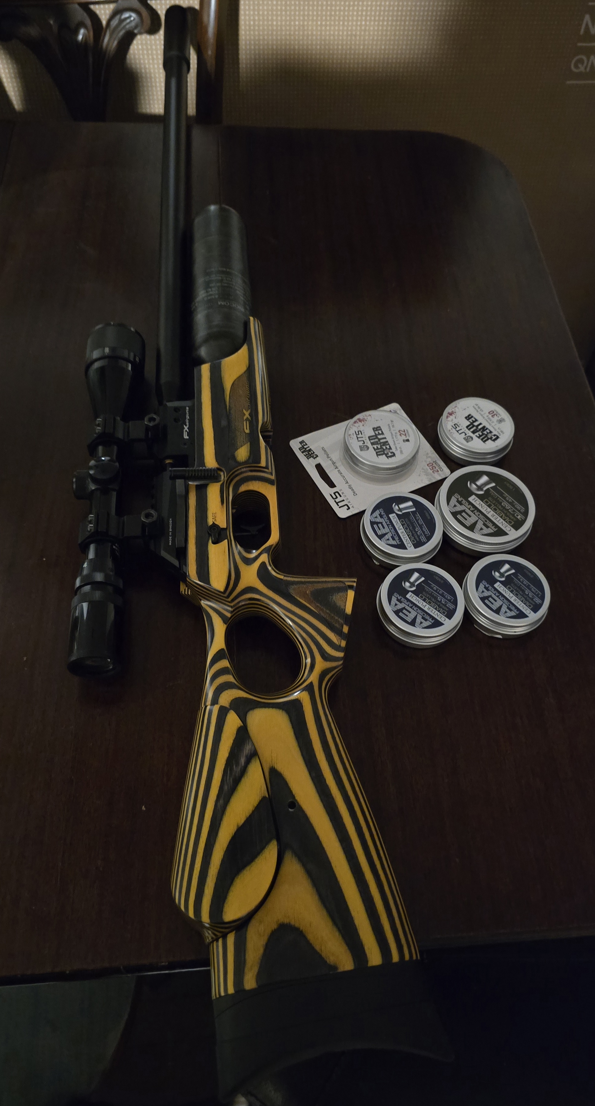

My rimfires aren't any more accurate than my air rifles. My most accurate rifle of all gun types is my Crown. It even beats the Kidd custom 10/22, so far.View attachment 527139
Love that killer bee/murder hornet stock!
It's a cool rifle. No doubt accurate. I couldn't hunt with it. I couldn't afford it. I bet I could buy a CZ457, a TikkaT1x, and a Bergara BMR for what you have into that rifle and a compressor. Probably enough left over for a scope and mounts too.
