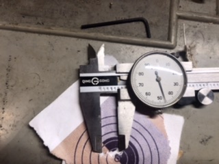

I just bought an Akela in .177 and have shot it out to 140 yards with the 13grain knockouts and the 15 grain nsa's My good scopes are on powder guns, so I was using a bugbuster 3-9/32, which has huge crosshairs at 9x. the best group is 7/16 at 50 with old brown box crosman 10.3's and a dime at 75 with the knockouts. So far the scope is limiting me.

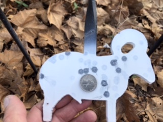

The 100 yard slugs went into a 1/5 scale ram center of body to neck, the 140 was about a circle the bottom of a popcan. Both of those were before the sear and linkage adjustment.

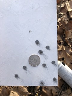

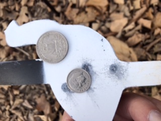

Slugs, 10.34 knockouts on the turkey at 75, ram at 100, plate at 140, targets 50 yards with 10.5 brown box.
bottom two on the plate and top two over the quarter were be picking the mildot to use.
