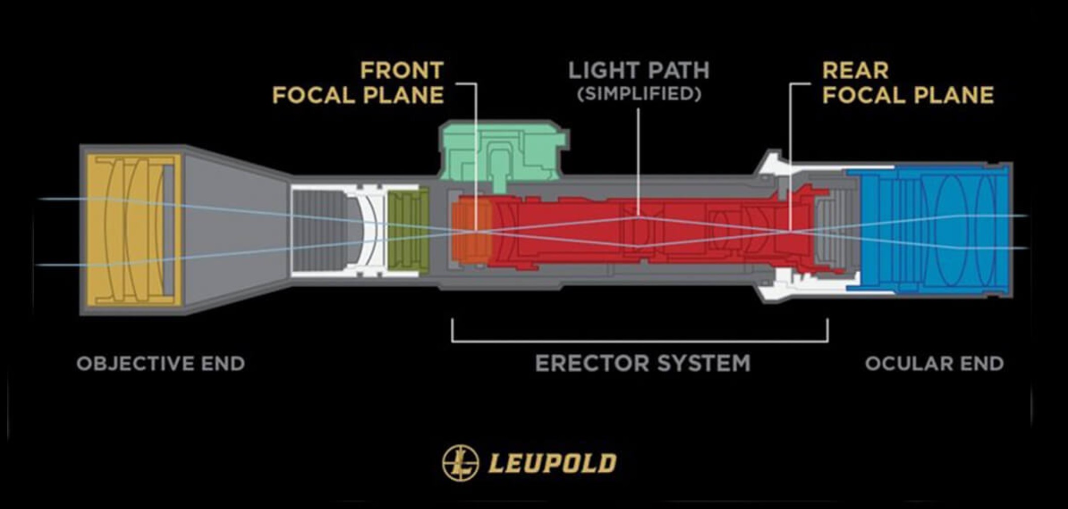

Measuring close to the front or center of the turrets in FFP scope's and more towards the eye piece on SFP scope's will get you a pretty good measurement for your ballistics app. If you want to fine tune it, do a fairly precise and verified speed and bc setting for the projectile first, then check/test the really close range readings/settings in relation to the dope chart numbers. The close range dope chart will have more feedback on the height number than longer ranges. Whereas a dope chart for longer ranges are more speed and overall drop/holdover critical.
