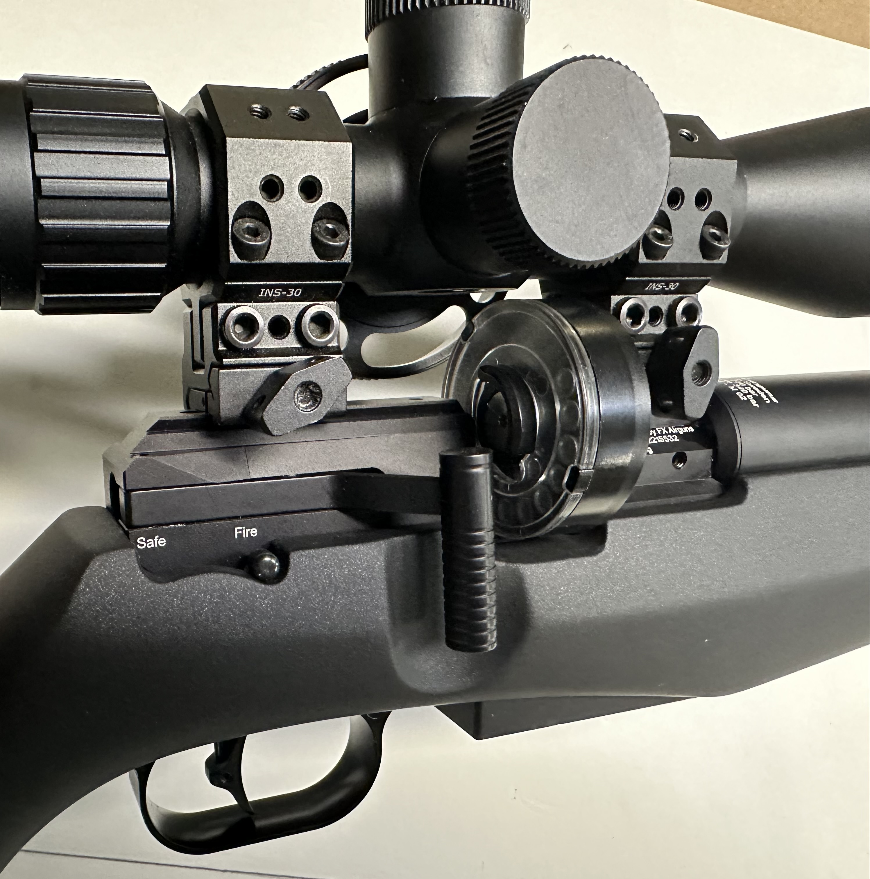

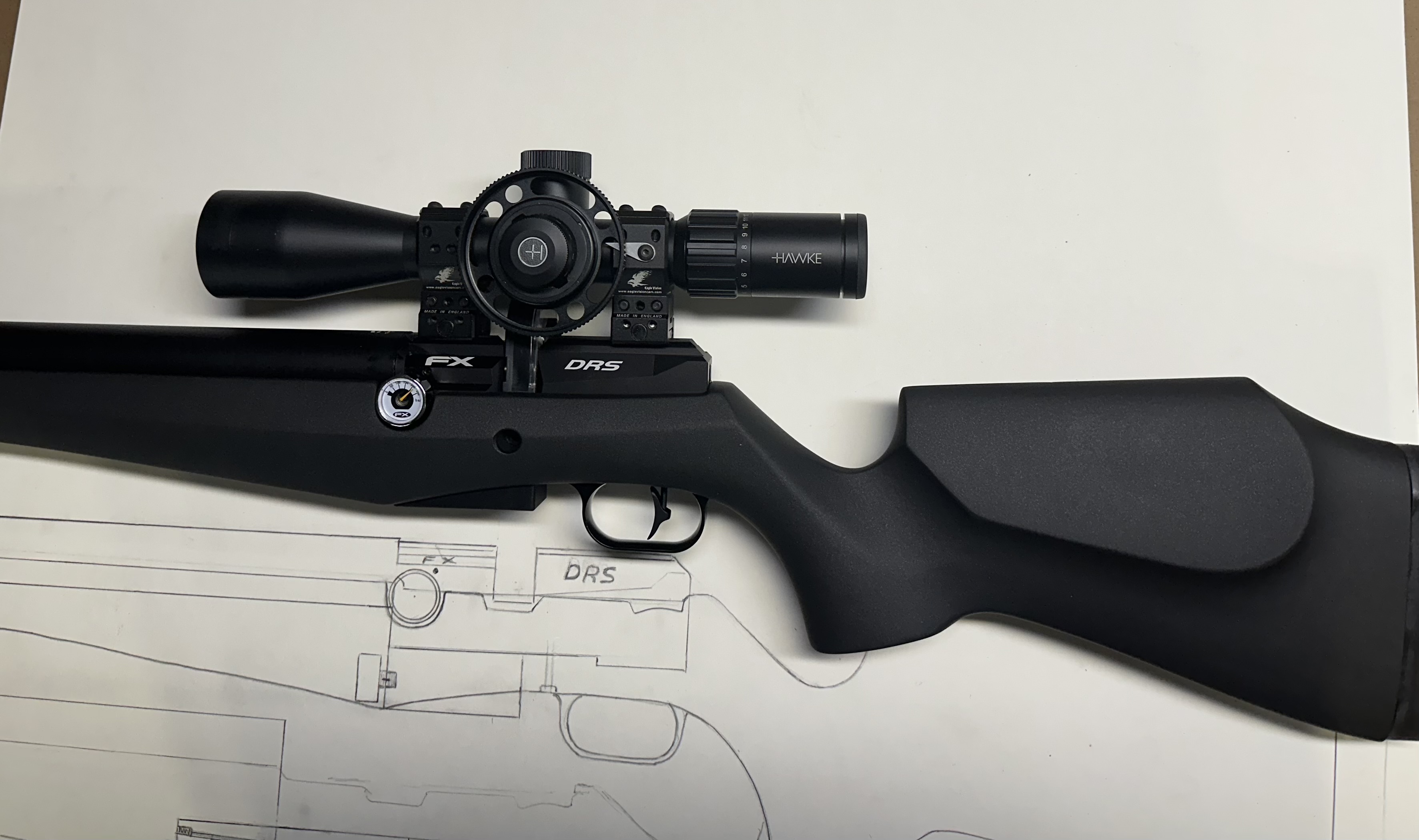

Got my DRS and mounted a Hawke 4x16 x44 Airmax compact scope. I was worried if the compact scope would be far enough to the rear for a proper eye relief. But with the scope mounted centered on the receiver the 3” eye relief is perfect. I used a pair of Eagle Vision scope rings I had with a 11mm adapter. With this setup you can still get the Dreamline larger magazine in (see picture). For me the scope could be a 1/2” lower but I may want to use the larger magazine some times. We will see how this rifle is finally tuned and used for.
