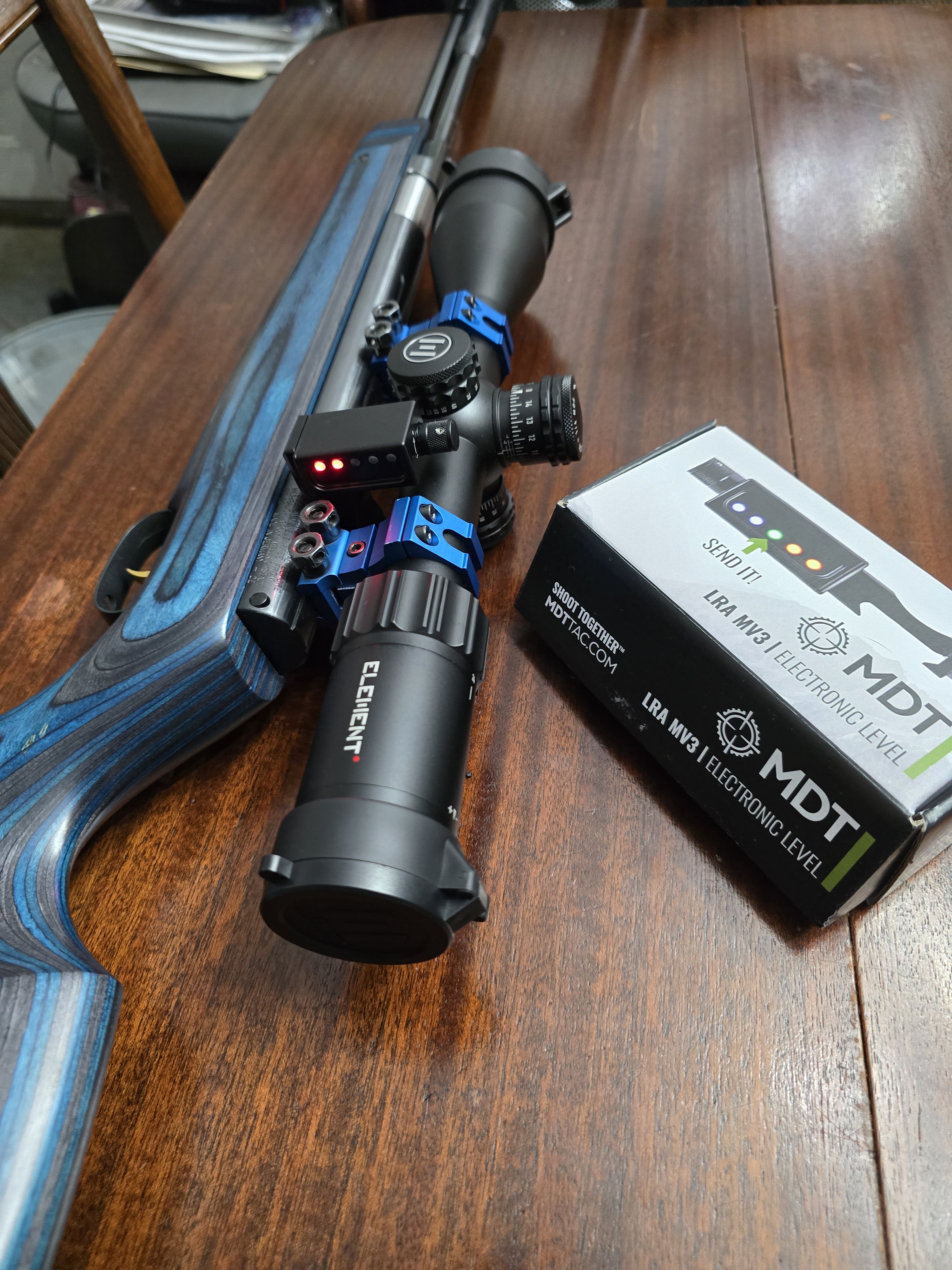

My first was a Bushnell 3X9 with an adjustable objective. The ring around the AO came loose but I caught it before the tiny screws fell completely out. The AO was damaged so that it would no longer focus at any setting.
Then a week ago I had accuracy issues with My Element and noticed my eyepeice was loose. So I boxed it up and had a replacement in four days. I assume that it was springer damage but I don't really know. It was never dropped or hit, and had about 5000 rounds on an HW98K.
