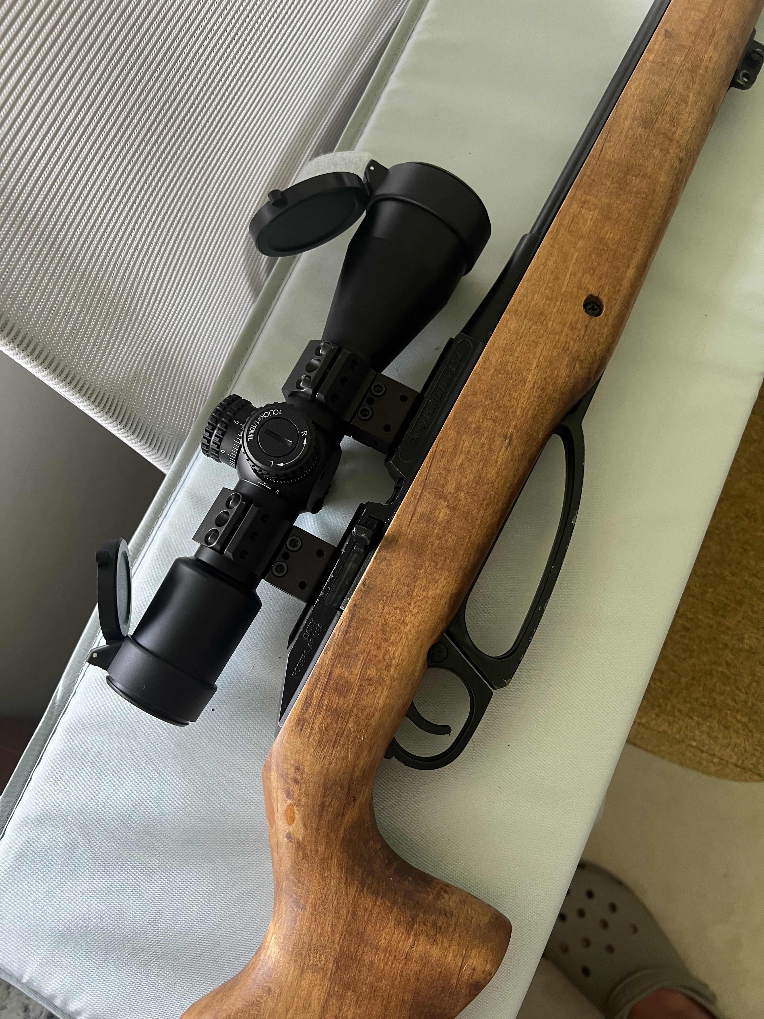

Anyone ever use these type of scope ring adapters?
I recently picked up a Arken scope with a 34 mm tube.
Id like to install the scope on a rifle with a 11mm dove tail...
Not many options for scope rings.
I see adapters like these, and unfortunately, it might be my best option.
Anyone have a better idea?

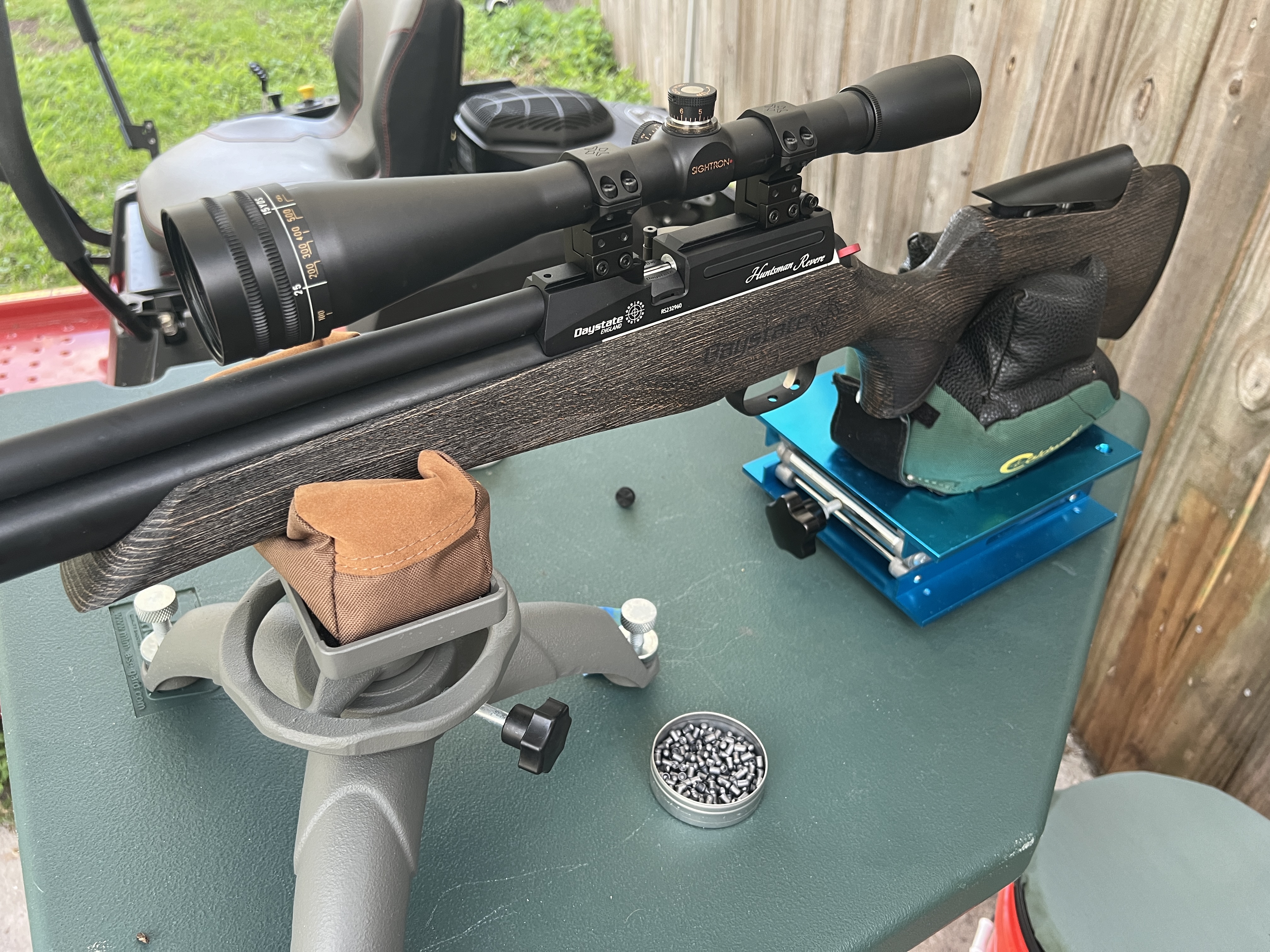

They don’t have the layer of cushion.
I have them in
1” dovetail
1” pic
30mm Dovetail
30mm Pic
I use them on PCPs. I have FX No Limits that sit in my airgun toolbox now because I prefer the Vector. They have worked flawless for me.
