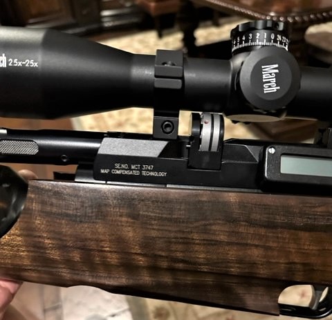

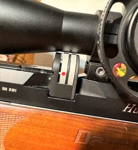

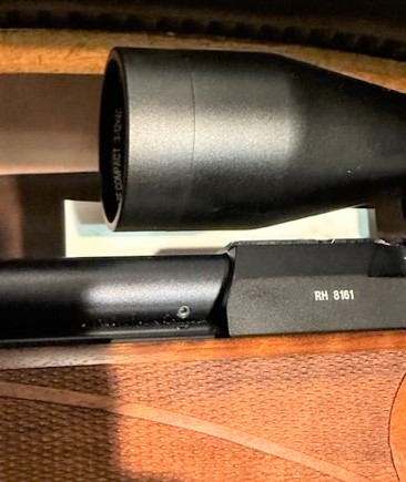

For dovetail mounting I really like BKL self-centering rings. They come in 1" and 30mm. I have 30mm low mounts on all of my dovetail rifles (Daystate, Air Arms, and BSA) The older Daystate mags just fit with minimum clearance on a 40mm objective lense or less, though this scope has a 42mm front objective. My Huntsman has a 40mm Hawke objective and you can see has plenty of learance for the mag and objective with the low rings. With Air Arms and BSA, where the mag is fully below the dovetail, I have the low ring BKLs with 44mm objective Optisan scopes mounted with plenty of clearance between the shroud and objective.
