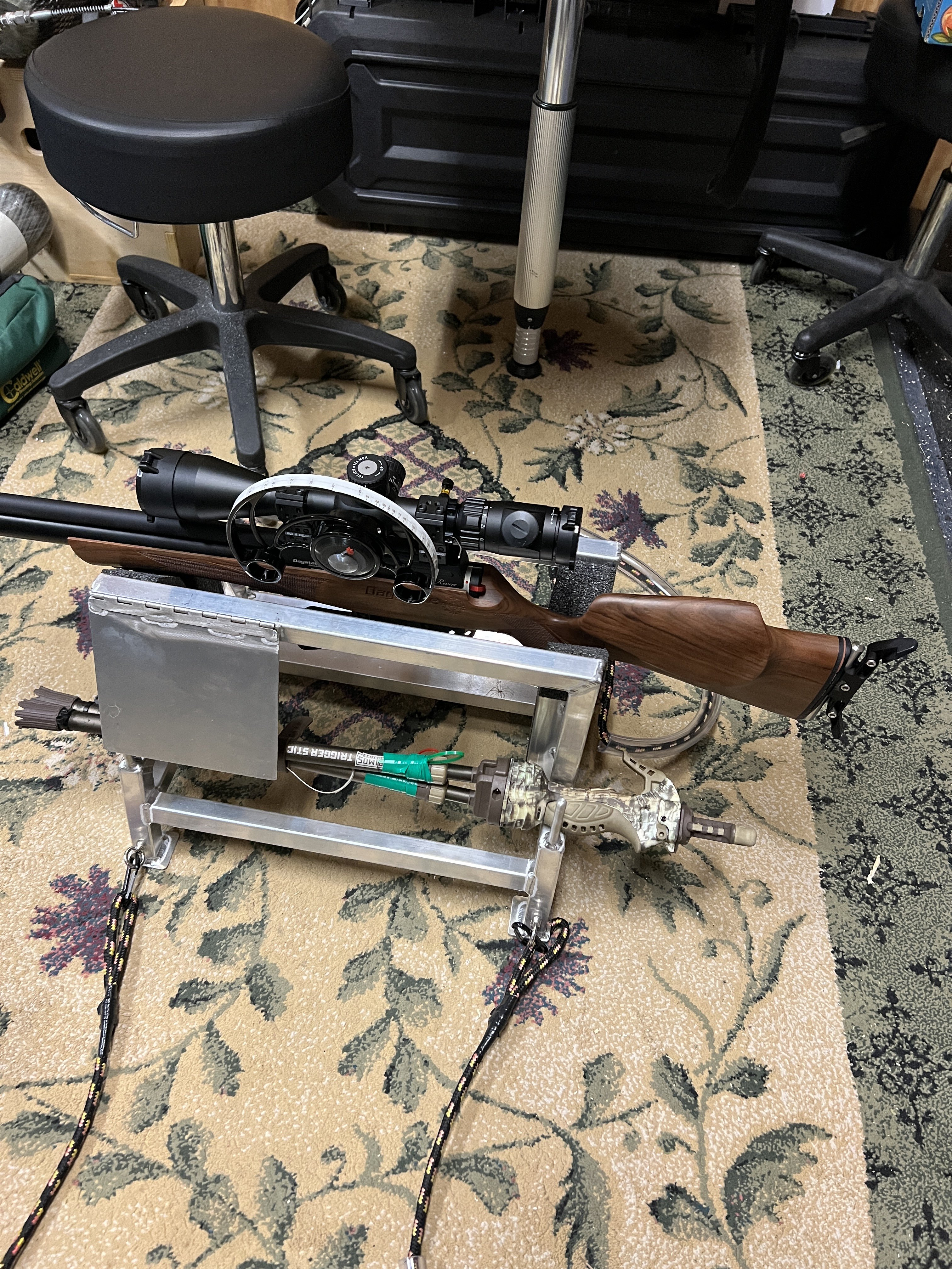

Don’t ask me why or how this came to be, but someone may be able to shed some historical light on how this came to be. Currently we / I take a scope that can focus as close as 10 yards and using the parallax adjustment I mark a large parallax wheel at 1 yard increments for point of focus out to 55 yards. You really need to try field target as it’s really quite fun AND very challenging!
Notice the large ranging wheel in the picture
