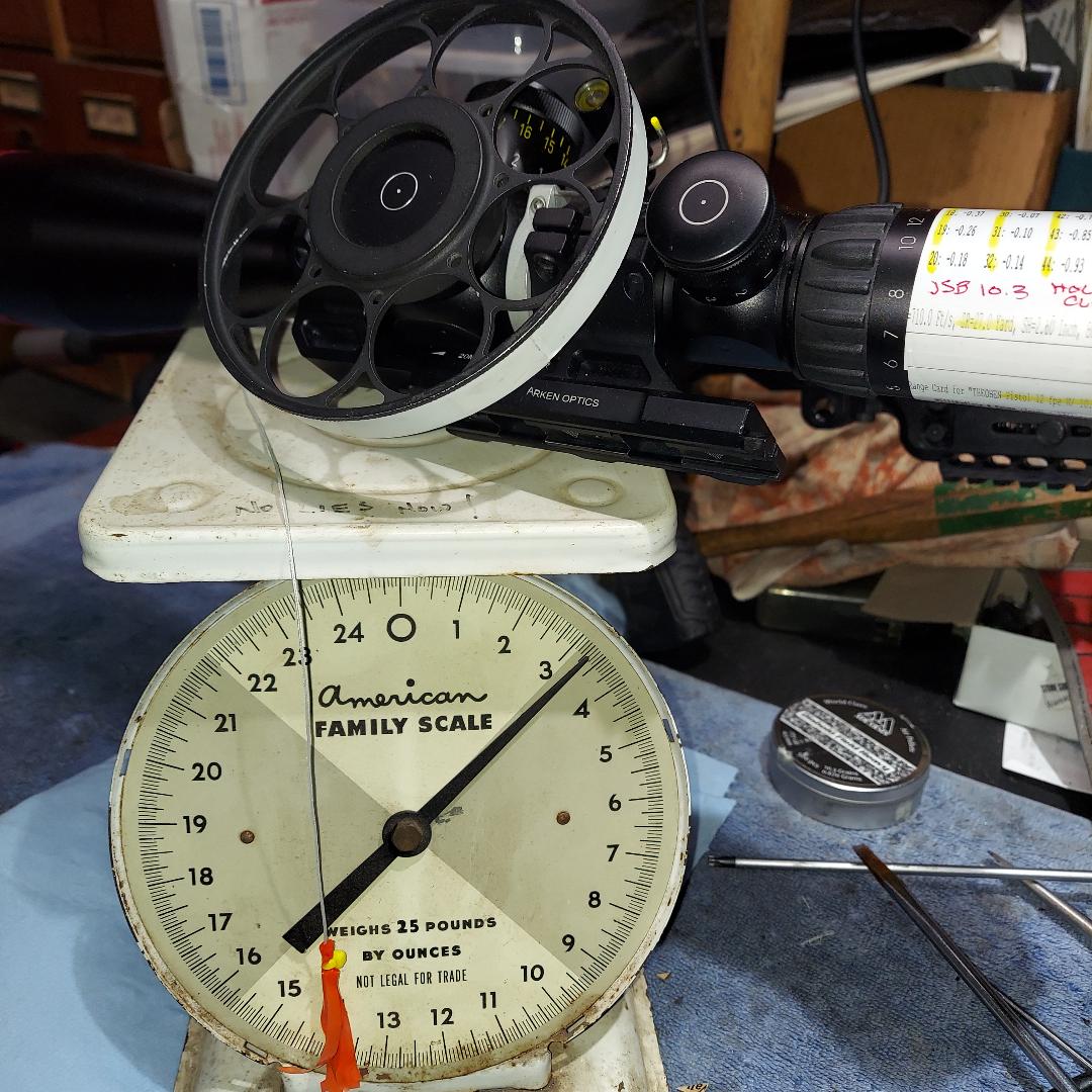

34's are generally VERY beefy & weighty. While they generally will be brighter due to larger glass and more area threw tube for light transmission, the cost is WEIGHT !!!
Shown is a SCHMIDT*BENDER 5-25x56 PMII with a ARKEN 20moa one piece mount, 5" Side wheel being An absolute BEAST at 3 1/4 pounds !!!!
Clarity & Brightness ... Never used better & That attribute comes at a COST $$$$ Literally :cry:
The 34MM I had weighed 41.5oz just the scope, so it wouldn't take much to push it over 3lbs.
