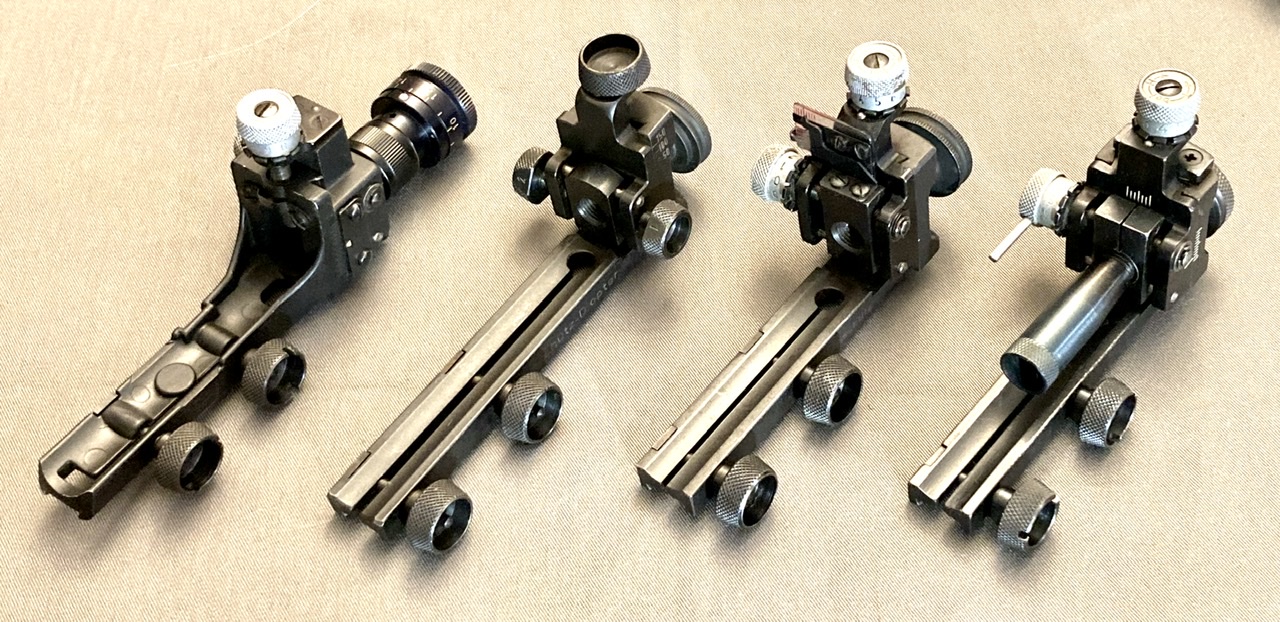

For reference - Anschutz sights, left to right: 6705 (alloy), 6700 (steel), early and late 6702 (steel):
Note...the iris on the 6705 and glare shade on the late 6702 are add-ons, not part of the sight.

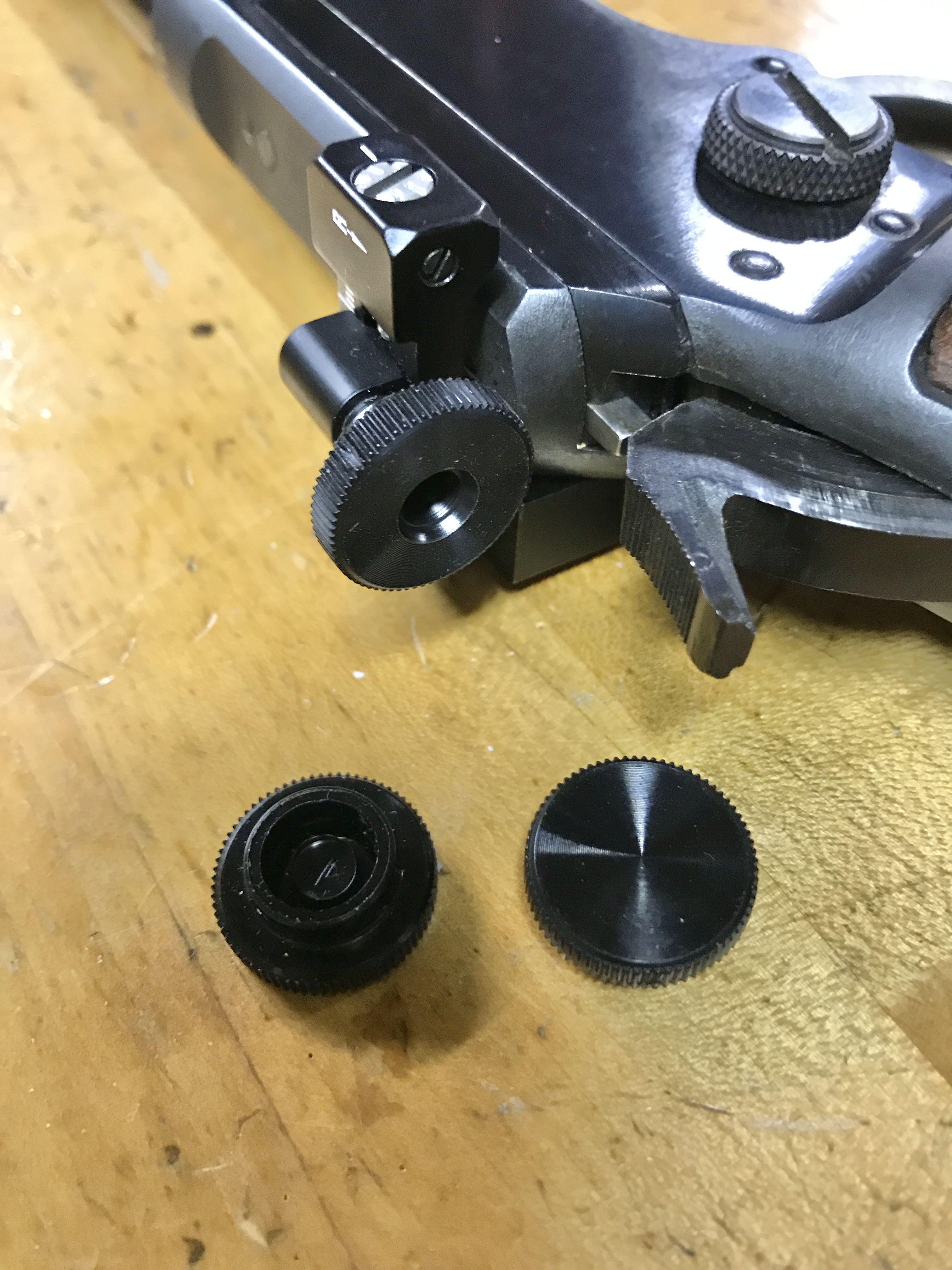

Here is my solution shown on a Marlin 39a. It is a 0.050 aperture drilled out to 0.063 and pressed into a plastic knob adapter for a 1/4” cap screw. The adapter has obviously had a hole bored through it prior to pressing in the 3/8” OD aperture. It gives the right size aperture for a receiver mounted sight, and shades the peep hole as well. Doesn’t look bad either! For hunting in low light I use the standard 0.093 aperture.
That's an outstanding idea sir and I will blatantly copy it myself.
Well done!

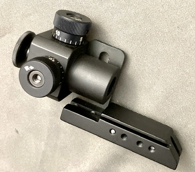

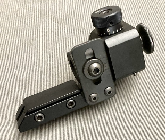

I have a TS1 sight, and can recommend it without reservation.
Fits 11mm grooves securely, and uses the standard European eyepiece thread, so can take any accessories made for that. It has a HUGE range of vertical adjustment, so might adapt well to some pretty long-range airgun work? And if you don't have 11mm rails, no problem...an interesting feature is that the body can be removed from the base, and its built-in front glare tunnel fitted into a 1-inch scope ring!
I suspect the base is made by BKL, and the body might be inspired by a very pricey sight made by Gehmann in Germany (check it out: https://www.gehmann.com/en/590-Compact-rearsight/GEH100562 ).
The adjustment knobs work in reverse of most sights (turning the knobs clockwise moves elevation up and windage right...odd, but no biggie). Also it's a bit on the big and heavy side. But overall, an innovatively designed, well-made, and very versatile unit.

Just to be clear, the TS1 sight is not made by Gehmann - I was just speculating it may have been inspired by one of their models. It's made in the US.

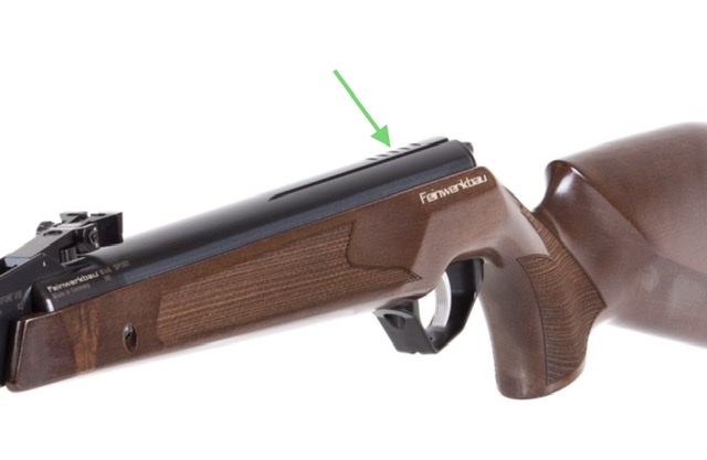

BUT...looking at photos of it, I'd guess the scope rail spacing is the same as the old FWB 300 match rifles - which is a bit WIDER than 11 mm. In my experience, Anschutz sights WILL NOT FIT, without some damage to either the sight or gun. So your options are:

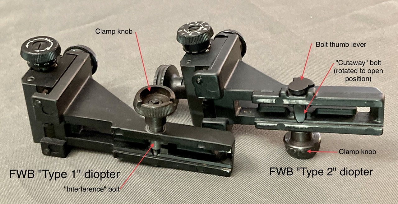

4. Best of all would be...Feinwerkbau's own diopter, as made for their old match rifles. The shallow transverse grooves between the Sport's scope rails are actually for the retaining bolt on these sights (which also acts like a scope stop - as Bear-of-Grayling noted - to keep the sight from moving).
There were two variations of these sights. Either will work. (NOTE the earlier "interference" type bolt must be screwed ALL THE WAY OUT when taking the sight on or off, and you must be careful to line it up with one of the transverse grooves. Otherwise it can ding up the finish.)

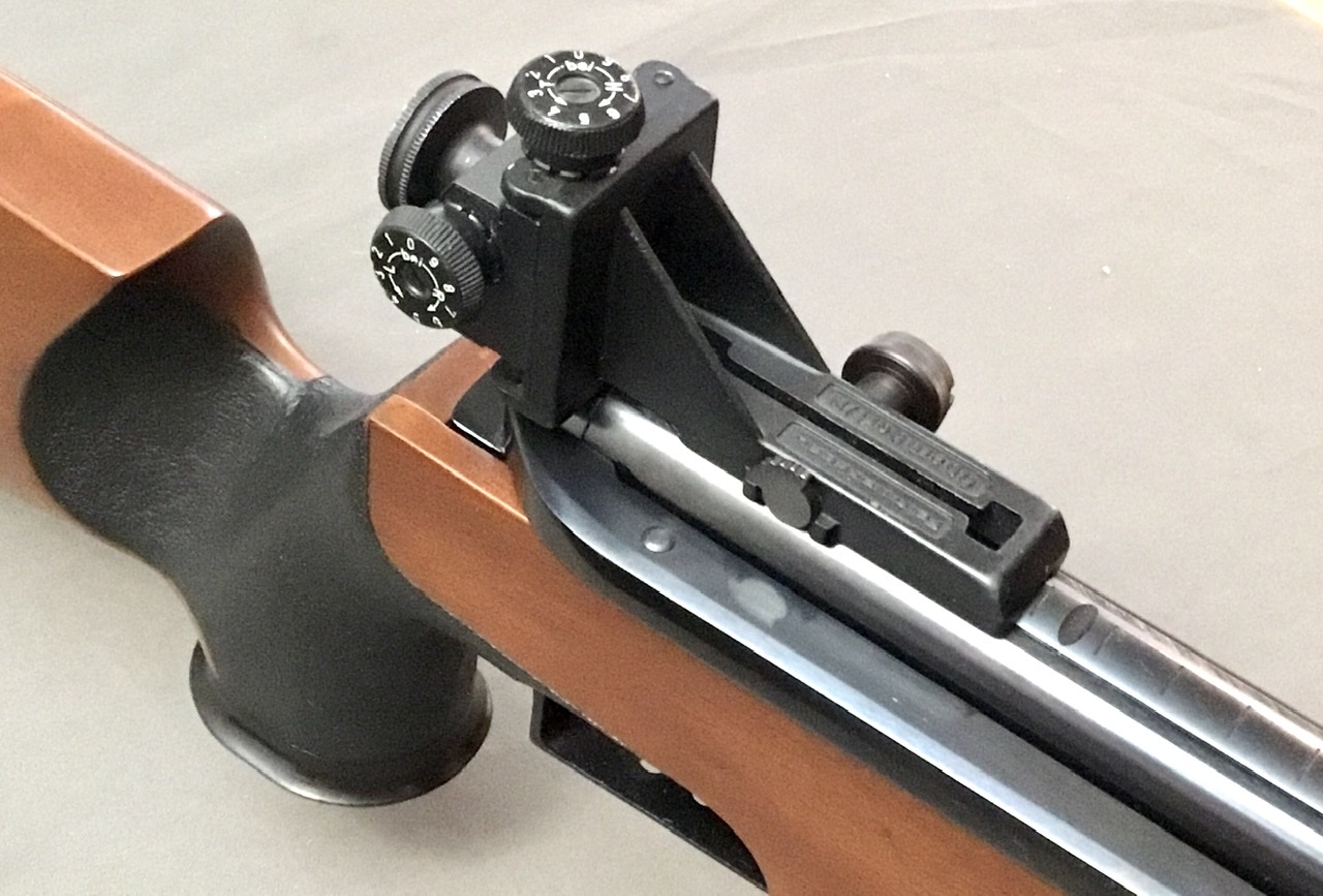

The only rail that seems to be absolutely standardized is Anschutz. I have rifles from the early 70s to 2022 and they all measure 10.93 - 11.00mm in width. Makes it so much easier to fit a sight. The Sport rail is more narrow than the FWB 300s, but just slightly wider than the Anschutz. An FWB diopter, I have two, fits very loosely. It is possible it could be overtightened and made to work, but I wouldn't recommend it. My Anschutz sight, the one with the plastic scales, is a very tight fit and actually cannot be fitted beyond the slotted portion of the base.
The Sport also has a very low sight line, around 0.700" from the rail, which presents another problem. The Anschutz sight cannot be adjusted that low. The FWB diopter looks like it might be able to adjust low enough, but then it doesn't fit the rail properly.
The Williams FP should work, but you may need the GR version to be able to adjust low enough. Another option is the WGRS 54 which does appear to be able to be adjusted to the correct 0.700" height above the rail, but that should be verified. I know it has been used successfully on some HW guns. It is also a nice trim design that would be a good match for the aesthetics of the Sport.
