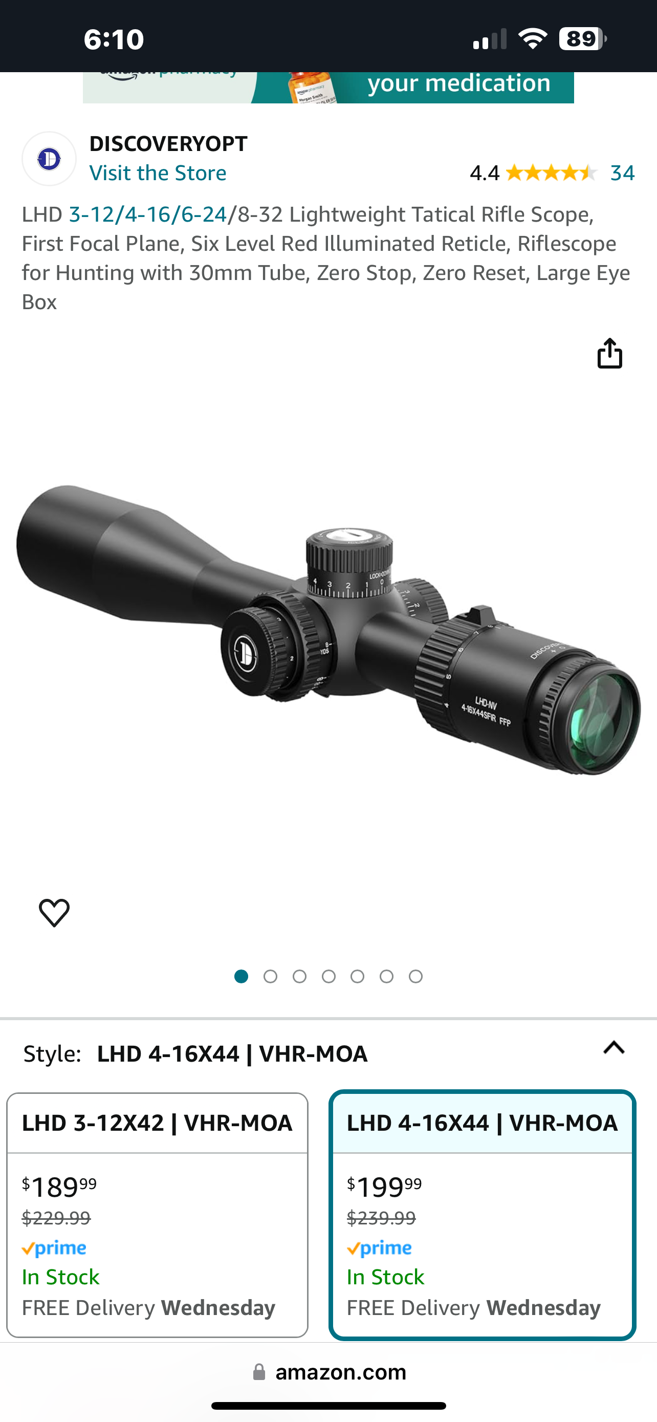

I also have this scope that I really love. Wouldn’t be afraid to mount it on the Magnum. Check out the quality control process on YouTube. Quite the beating each one gets before getting the stamp of approval.
