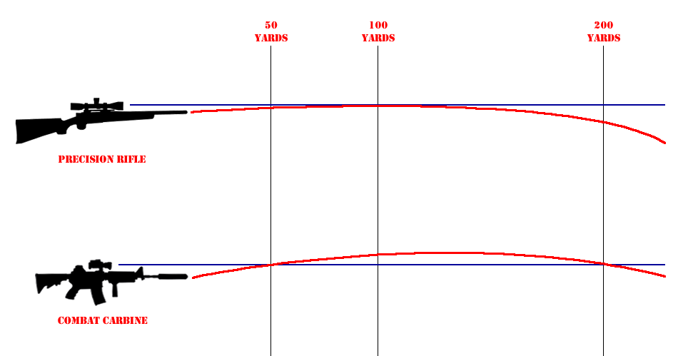

this one doesn't make sense to me. I would think having it lower would help. I just cant visualize it. I would love to see a diagram of how this works...It helps with the hold over on longer shots. If you look at videos of field target in the UK where they shoot 12ftlbs they have super high mounts on top of risers.

The following diagram was created for a different topic but it works to illustrate the point being discussed here. The top diagram represents a scope mounted low. At near distances, the pellet's red trajectory line and the scope's blue line of sight track closely together. But at a distance, they diverge quite a lot.I would love to see a diagram of how this works...
