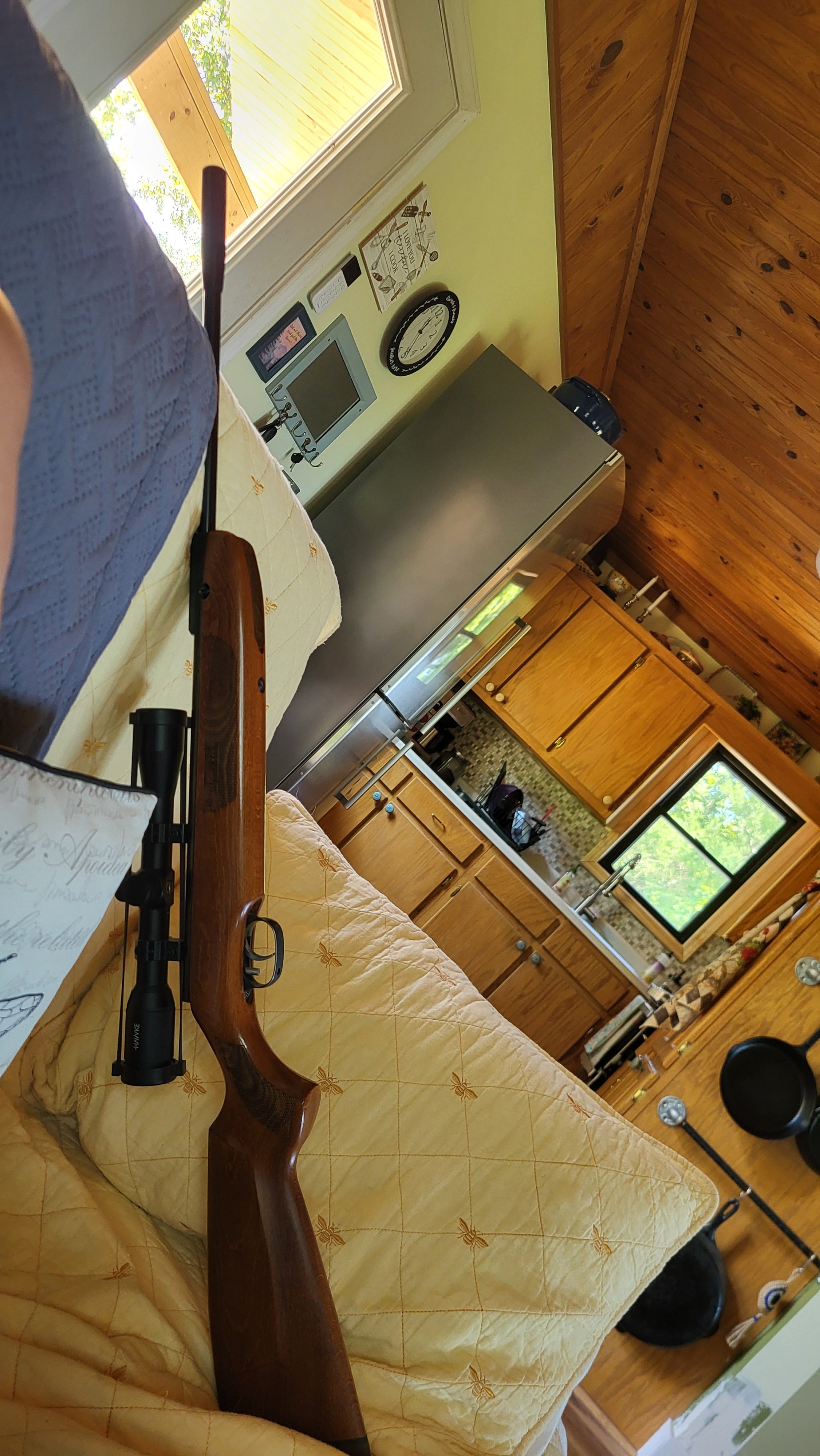

Greetings-I have been taking my time and learning about air guns reading your posts. I come from shooting sporting clays and hand guns. My first purchase is a HW 50s which I have now shot about 150 pellets through. I have noticed most of the names for scopes that seem to be popular, I am not a hunter, just plinking and casual target shooting, I have a powder burner Anchutz 22 with a Leupold scope, great shooting combination. In contacting Leupold they make a Freedom line of scopes with one. 3-9x33 for .22 and air rifles. Why do I not see more of these being used? Your experienced, knowledgeable thoughts would be appreciated. Thank you in advance.

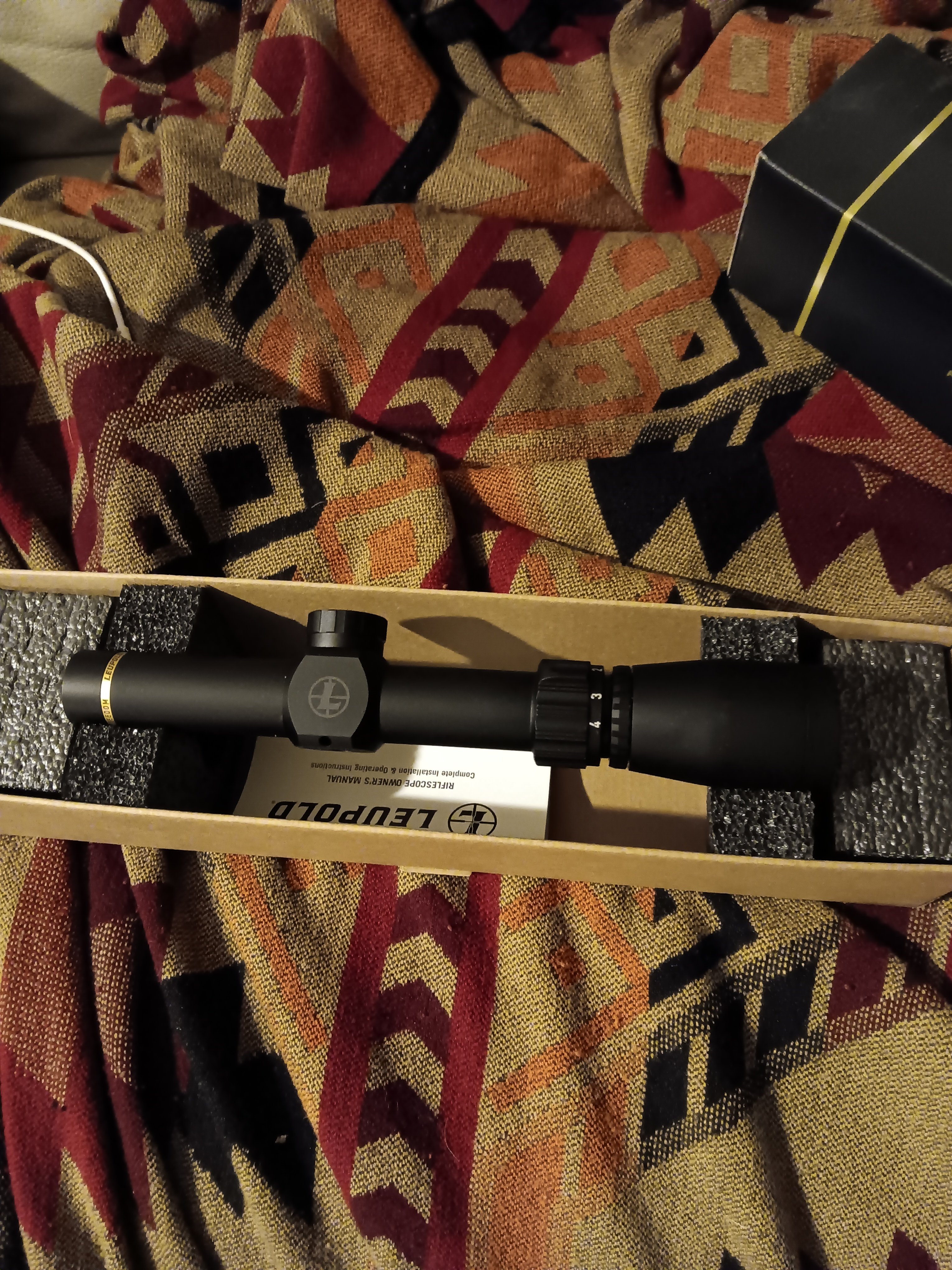

I have a few Leupold EFRs and they are a great combination of excellent glass, full parallax range from 10y to infinity, durability, and warranty.
The one downside for me is the lack of holdover reticles. I mostly see dot and duplex reticles which are not useful for handling the big change of POI from 10 to 100y. First focal plane is very useful also.
I think some shooters stopped supporting Leupold when they took most of their manufacturing overseas.
Still others left when the Leupold custom shop closed and has not re-opened.
I suspect others may prefer a larger scope overall for more light collection and still others want a wider magnification range or side focus knob. New scope designs seem to have all of those things plus what the Leupold offers. Unfortunately Leupolds new scope models lack parallax adjustment inside 50y so that pretty well kills their usability for airguns.

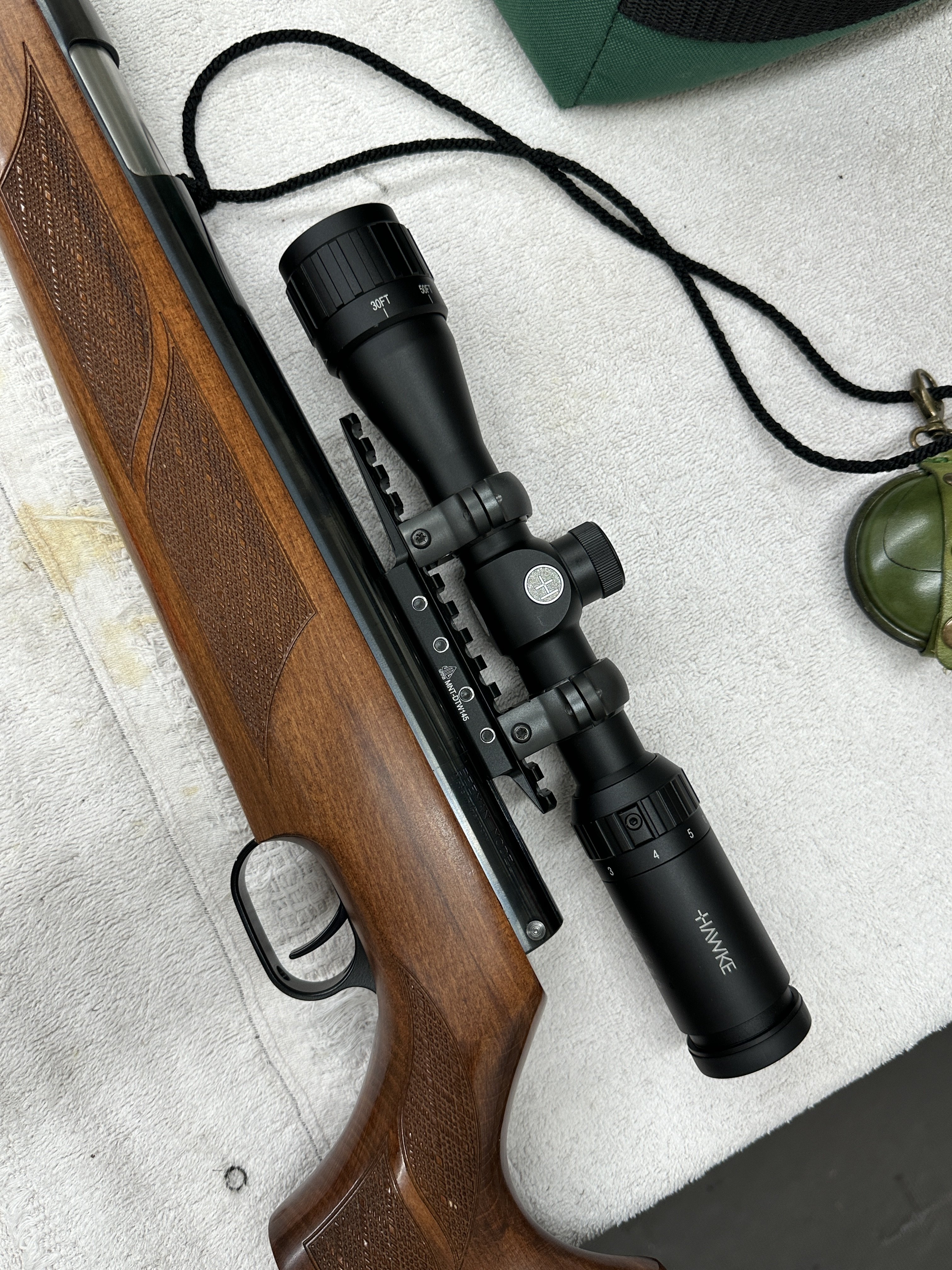

Excellent rifle choice! One of my favorite Weihrauch rifles. For the HW50s I suggest the Hawke Airmax 2-7x32 with a BKL 260 one piece droop mount. I have this combination on five HW springers and recommend it. Very light and very bright.
Springers are very hard on optics. Hawke has a lifetime warranty that I have used before. Very simple return process and I had a brand new scope a week later.

On my HW95 I have a 32mm Hawke vantage and low Spotsmatch 4 screw rings. It's perfect. Sits 1/8" above the barrel. Perfect cheek weld. No slipping EVER. Same on the HW97 only medium height rings with a 40mm scope. Solid as a rock. The only mounts I didn't have to fiddle with constantly. Sportsmatch is what I'll buy from here on out. Rock solid and they won't break the bank.
