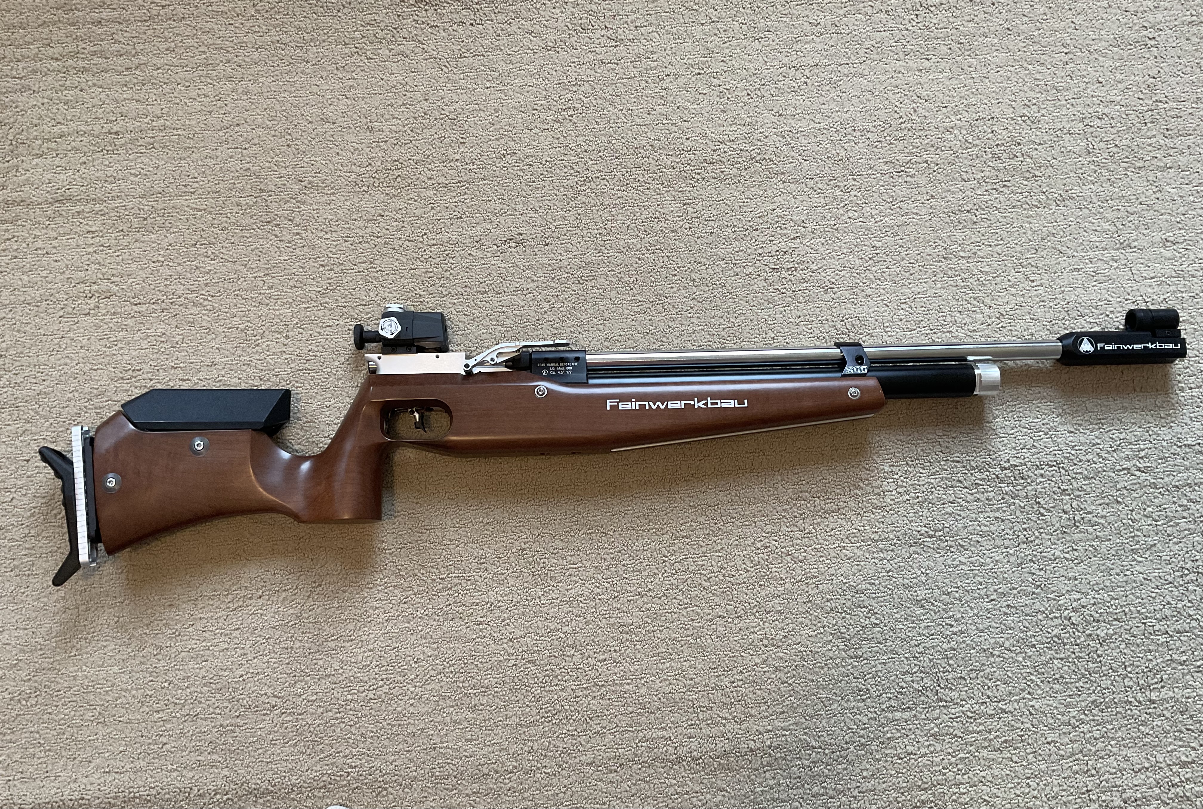

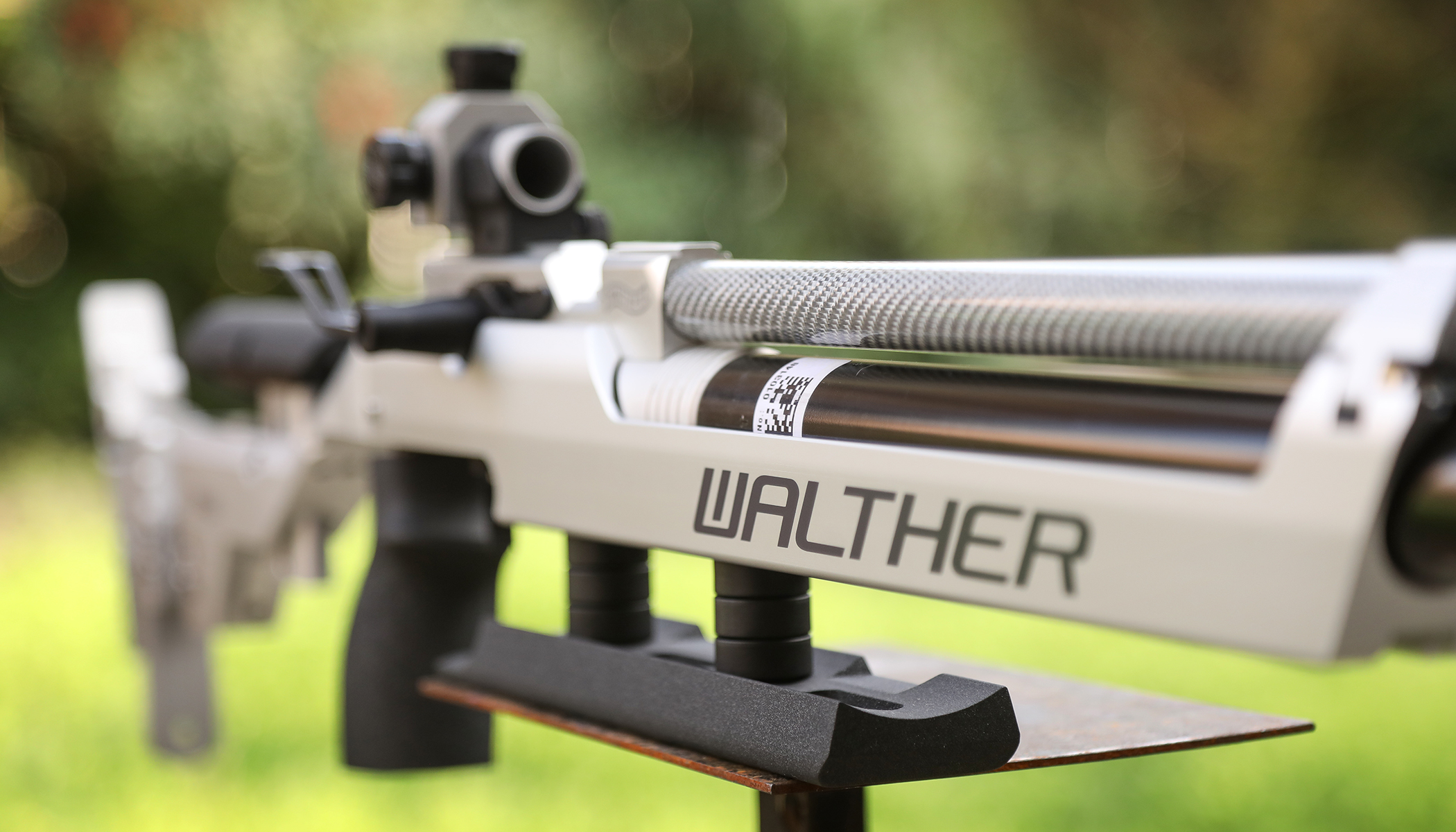

Hi Steve,

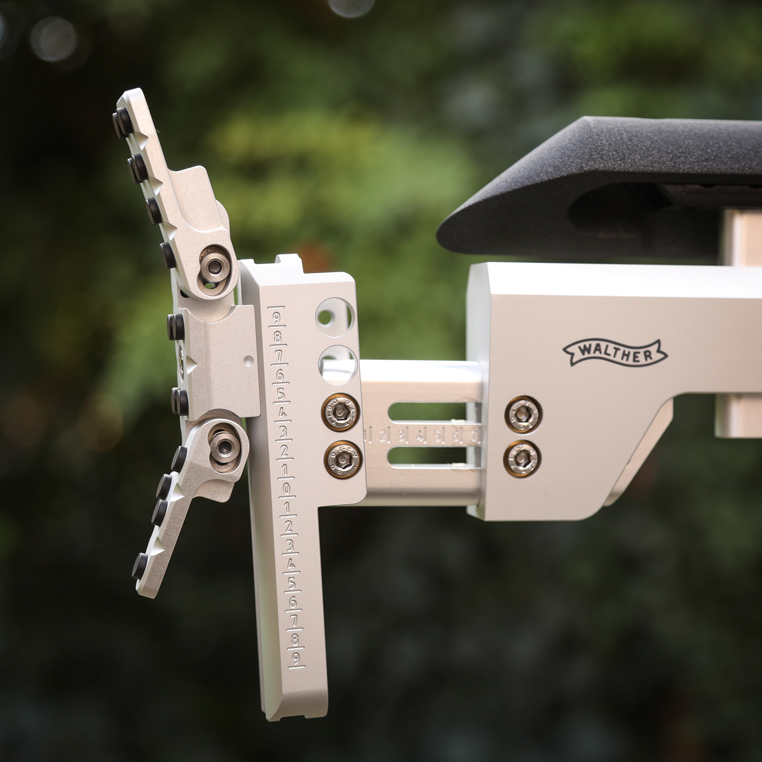

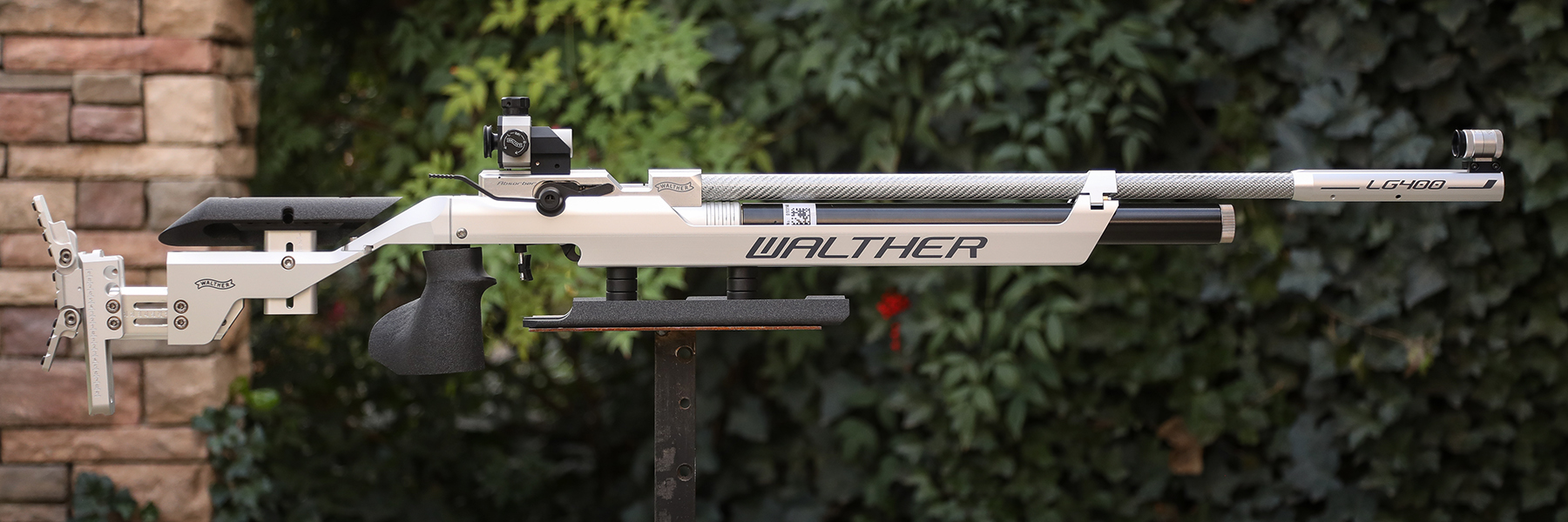

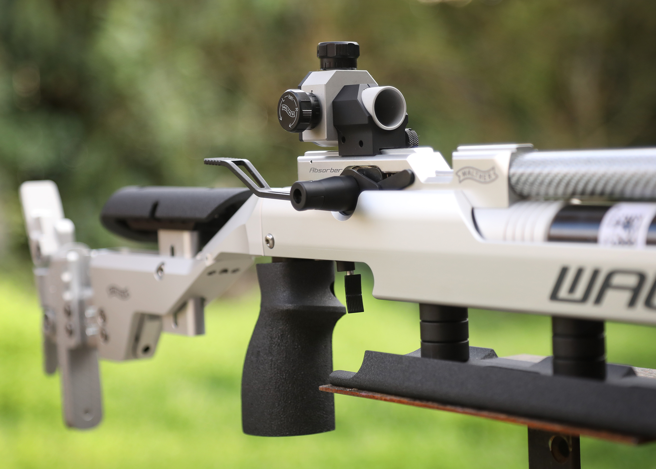

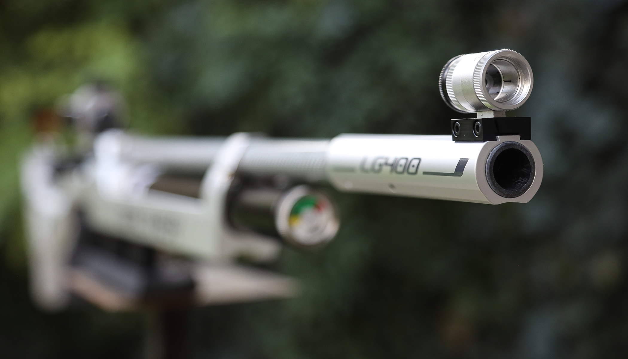

Here are some photos of my new toy. I pulled the scope off a couple days ago to shoot targets for the Casual Match on the Gateway forum so you get to see the factory provided sights in these photos. The two photos of the targets are from when I was using the scope. These are 5 shot groups at ten meters and 20 yards.
KennyView attachment 542264View attachment 542268View attachment 542266View attachment 542265View attachment 542267View attachment 542269View attachment 542270

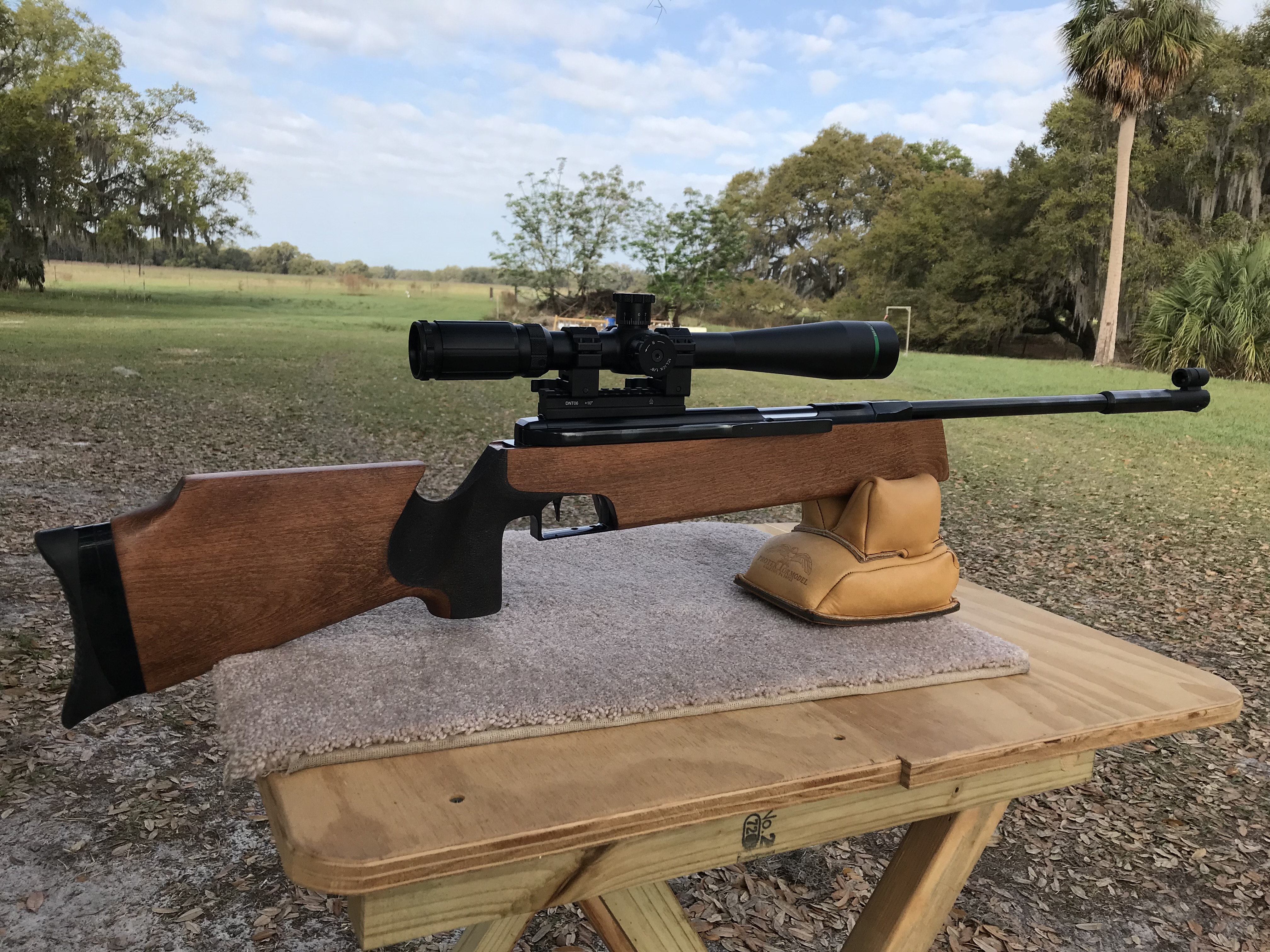

As much as I enjoy shooting iron sights I recently put a scope on my FWB 300 S. Originally I thought I’d just try it for a little while then put the original diopter sight back on. But I’ve learned that it’s a lot more fun to be able to hit tiny targets that I couldn’t even see before with the stock sights. I even moved back to 46 feet, the max I have in my basement. Where I live it’s the only place I have to shoot without going to the club. Makes this wonderfully accurate rifle much more versatile to me. View attachment 542030
Nice. What scope are you using?
Reactions: Steve Milbocker

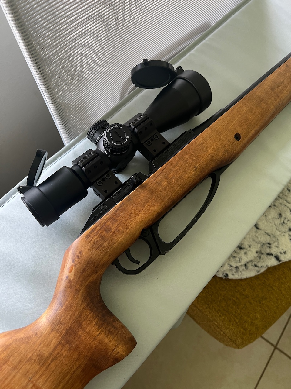

I put a few different scopes on my CMP rifle.
That was a Veyron 10x. The high adjustable rings allow for minimal scope adjustment.

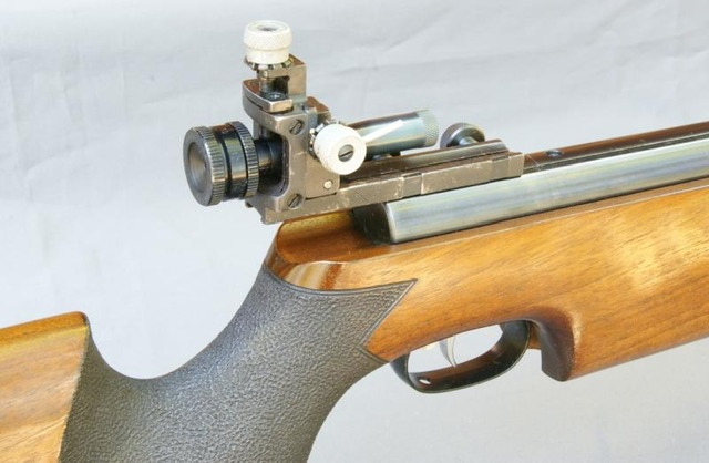

You don't need a scope - just an eyepiece that lets you adjust the rear sight's aperture size to fit that pesky real world existing outside of a well-lit 10-meter range :). Then you will discover how marvelously accurate and versatile such precise sights can really be.
You don't need a scope - just need an eyepiece that lets you adjust the rear sight's aperture size to fit the real world outside of a well-lit 10-meter range. Then you will discover how marvelously accurate and versatile such precise sights really are.
Thanks, The 510 would definitely fit my needs. I would love to expand the usability of that Feinwerkbau.
Reactions: MDriskill
Gehmann and Centra are the two biggest makers of those items - you might enjoy looking around on their sites. The adjustable opening lets you find the aperture size that best balances focus depth-of-field against brightness, whatever the lighting level is (most OEM eye disks have a fixed opening of about 1.0mm which, again, is great for the range but often too small elsewhere).
Note the irises are of "stacked" modular construction. You can add colored filters, a polarizer, or a 1.5x magnifying lens, in any combination of 1, 2, or all 3 (at rapidly escalating cost of course!), but again - just the simple adjustable opening is a huge plus.

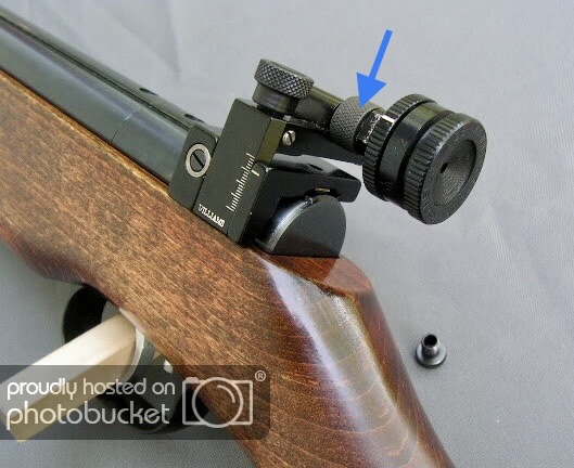

Note that Merit makes similar units for US-made sights. Gehmann also offers their units with US threading, or you can get a simple threaded adapter to fit the German eyepiece thread (9.5 x 1.0mm) to the typical US one (7/32" - 40). This is my favorite solution, as it lets you use a single iris on most any aperture sights out there. (Caveat: this works perfectly with a standard iris, but reduces your field of view with a lens, since you're looking through the US sight's smaller hole.)
Pic is an older Gehmann iris on a Williams sight, using the adapter.
