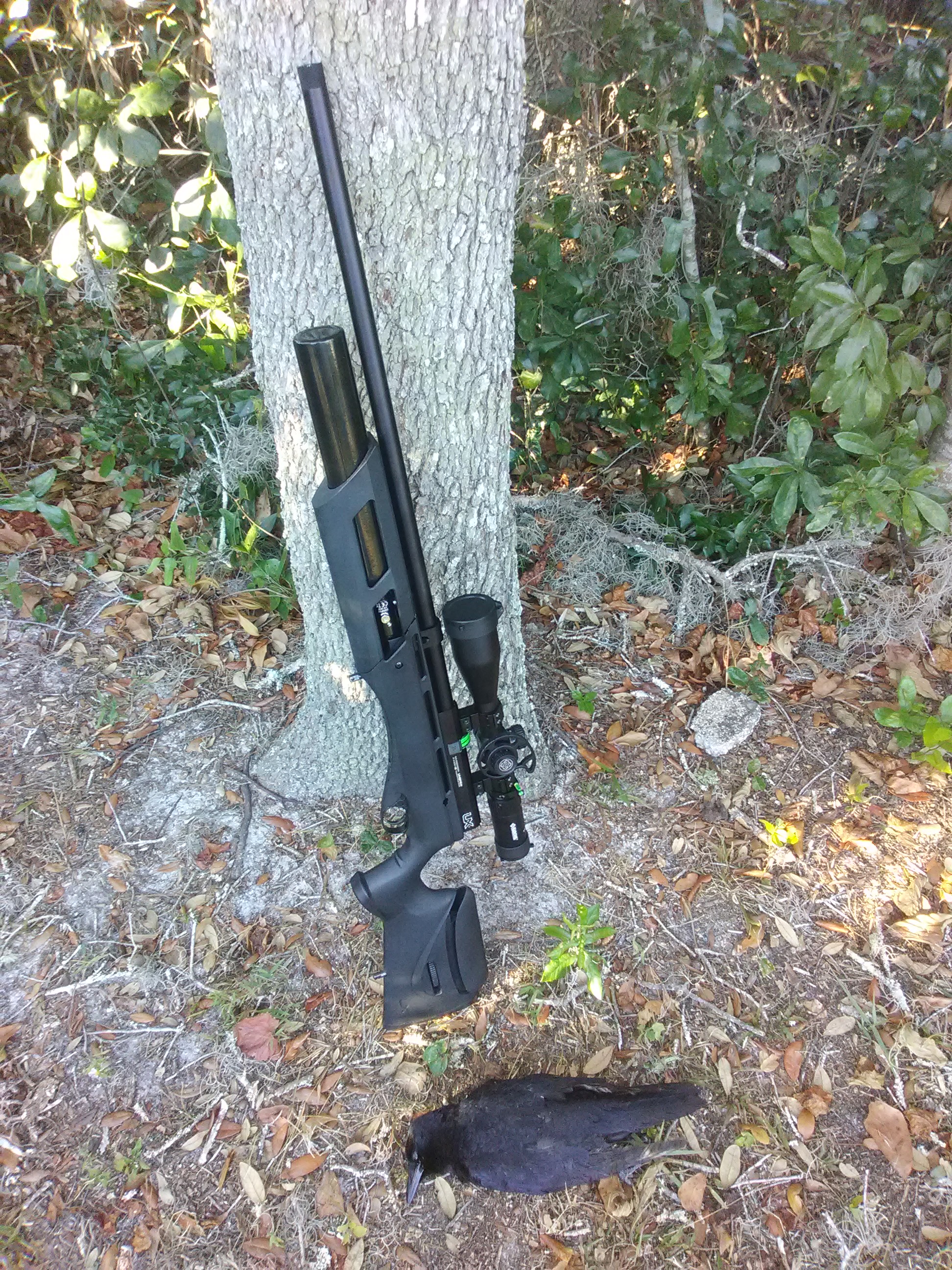

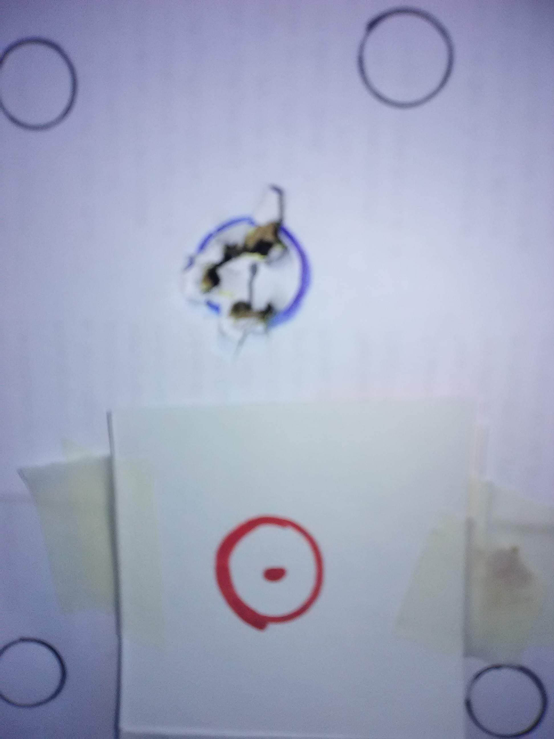

Accuracy suffered after upgrade to 2200psi regulator and larger tank. Modified to externally adjustable HS, but no joy, so set aside. Cooler Florida weather brings increased PCP attention so decided on a fresh start. Thorough cleaning, re-lube and fastener tightening, in addition to further HS tweaks, resulted in today's 50yd group with JSB 33.95s. Set Gauntlet on outdoor gun rack and got Snowpeak M60B .35 for target work. Guess this guy didn't get the no-fly memo, landed in the tall pine behind my house and started squawking, Gauntlet took care of business. WM
Subsequent chrono testing reflects JSB 33.95 MK2s @ 790 FPS, SD 3.61, ES 13 for 47 FPE. Topped off tank during multi-PCP Yong Heng fill session last evening, length and weight of Gauntlet still blows my mind. WM
