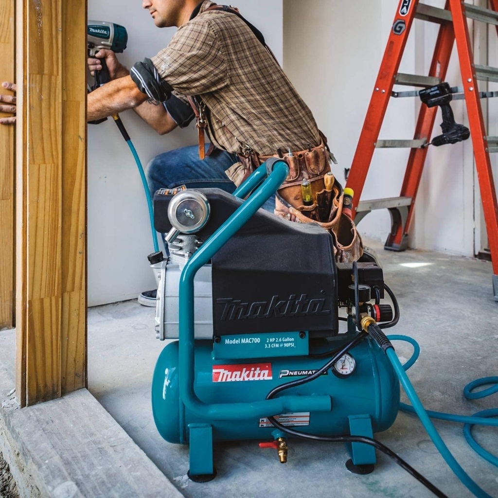

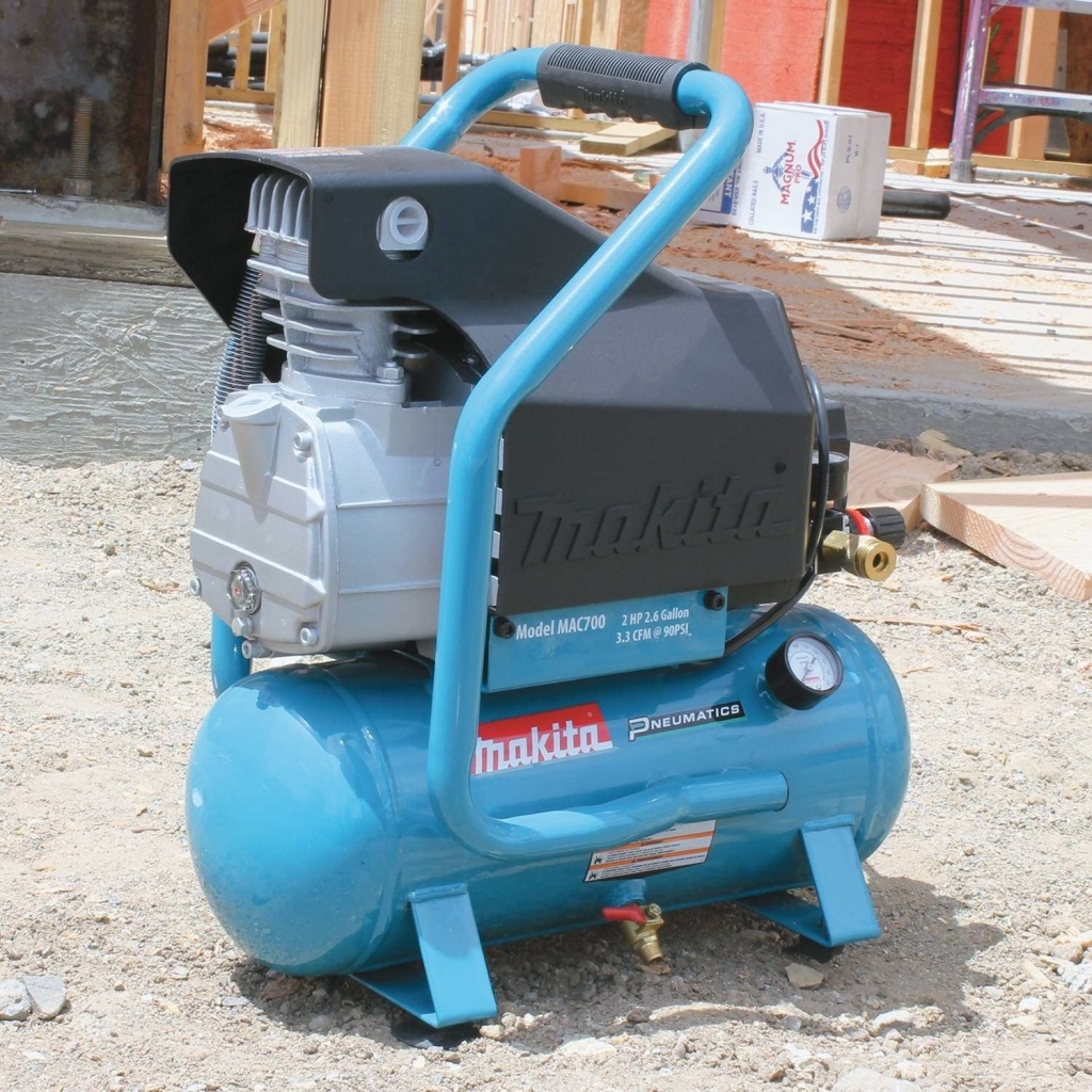

Looks like Makita has a YH as well:
https://www.amazon.com/Makita-MAC700-Big-Bore-Compressor/dp/B0001Q2VK0/ref=sr_1_13?dchild=1&keywords=mechtech+air+compressor&qid=1591744538&sr=8-13
Thought it interesting it's using an input filter as a LPA compressor. Crank case is just a touch different but physically it looks the same. First picture seems to be unboxed and everything installed. Second picture seems to be before the air filter and oil breather are installed. I wonder why the HPA version of the YH's don't have air filters?
