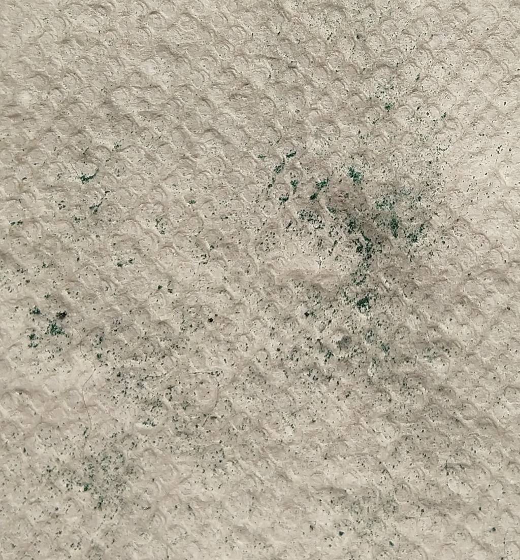

To demonstrate I subjected a large Scotch-Brite pad to repeated stress after placing a waffle-weave paper towel underneath so the waffle pattern would contain any debris. Under magnification green Scotch-Brite particles become visible. Although tiny, the particles are just as abrasive, and with the high pressure of a projectile grinding them against the barrel the effect is pronounced, as many airgunners eventually discovered.

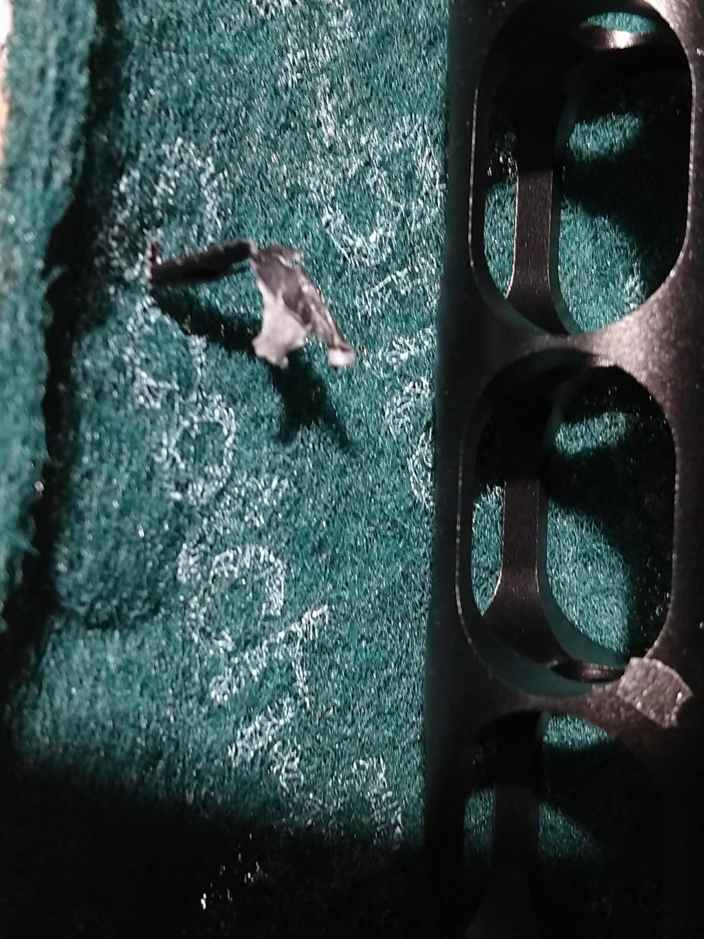

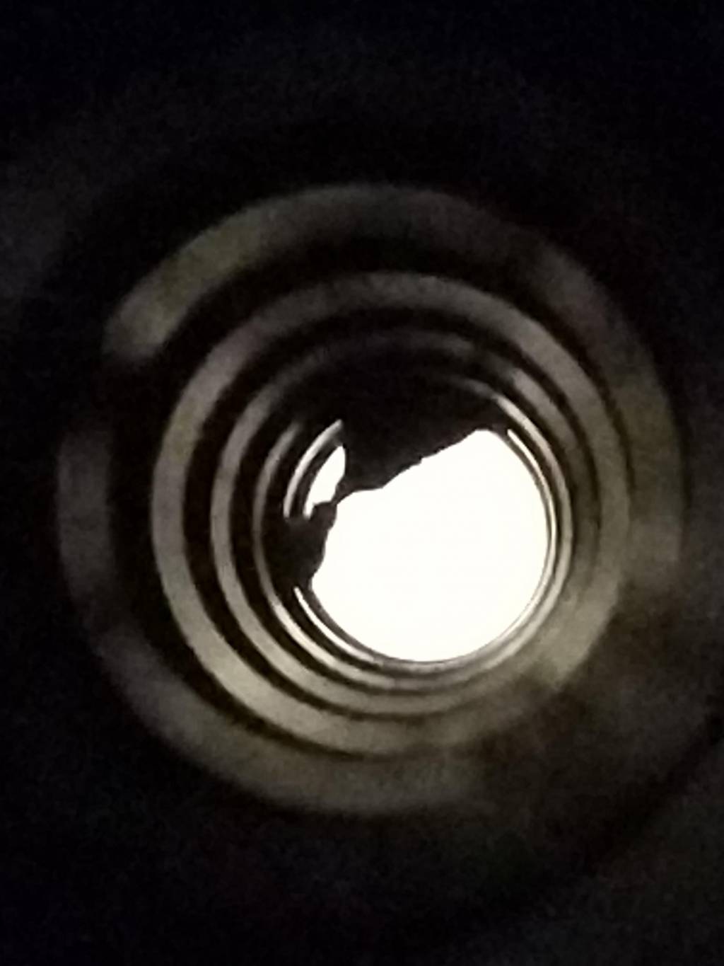

If you wash pellets you're already aware of lead particles left over from the manufacturing process. In some areas there's also rain, and small parts of leaves carried by wind, and bugs, and so forth. Here's something I found looking through the end of a suppressor recently:
Let's take it apart for a closer look:
From what I can tell this is part of a pellet tin wrapper, tightly lodged in a scrubbie.
