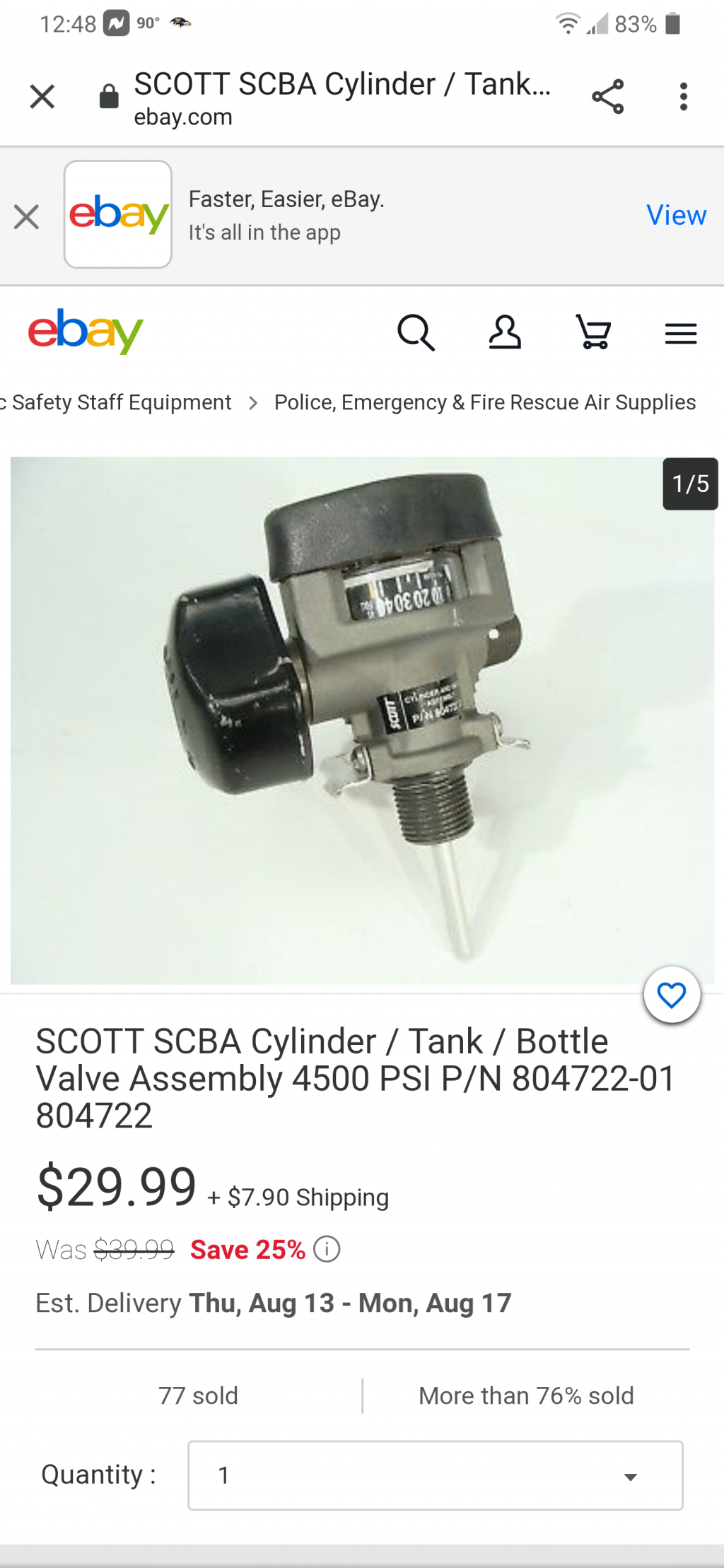

I have three Scott scba bottles without valves. The openings are 5/8 in. instead of 7/8 in. Anybody know where I can get 4500psi 5/8 in. valves? Don't recomend the California store please. Any where else? Thanks.
Ebay Ebay Ebay for all things tanks- get it right from the source. Email the sellers- some of them will respond. I've gotten valves on Amazon too ship very quickly
What is the full setup necessary for using SCBA tanks as a fill station? I have two Scott 60min 4500psi tanks on the way and need to know what else I'll need to fill my FX Crown. Thanks
Regulator valve assembly (CGA-347 valve) for each. You can get these all day on Ebay from $30-$100 depending on how new you want it. (Shamboozi has the valve assembly post above off Ebay)
