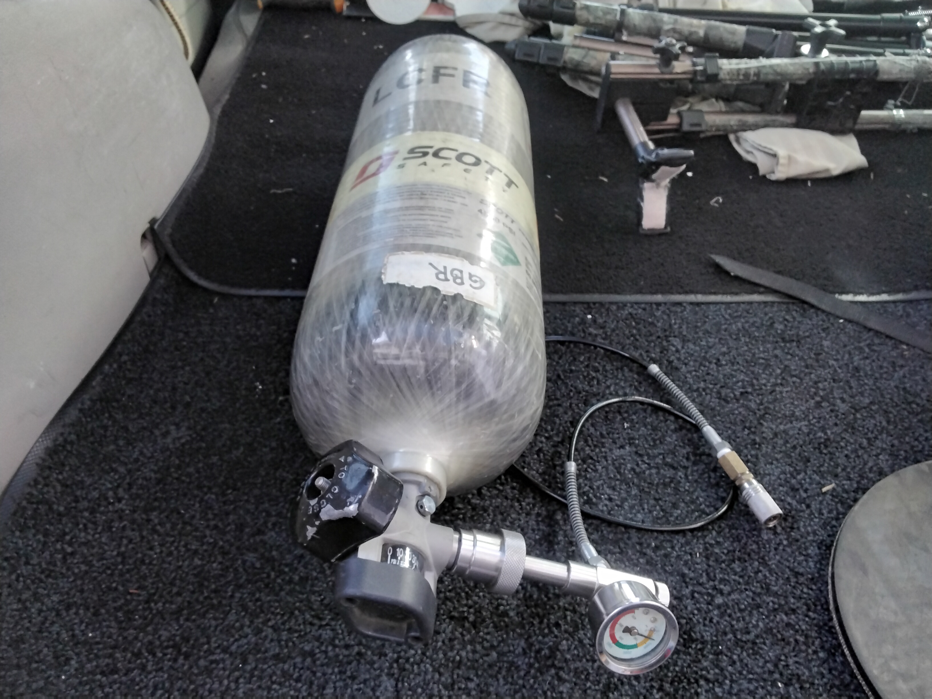

I've got one along with a fill station but the gauge built into the valve leaks.. and I tried getting a new valve but mine is a odd size.. just a little bit more than 1" diameter threads..I gave up on it..
will be interesting if you figure something out.. mine is all aluminum and wrapped around the main body and neck.. flat bottom so it stands up like a welding bottle..
I gave up on it since it is expired and the gauge leaks.. so if anyone is interested in the fill station and or the bottle, let me know.. I paid I think around $75 for the fill station and it was only used to put 500# in the tank to only find out it leaks..
id like to have a tank, but at this point I'd probably rather get a new one..

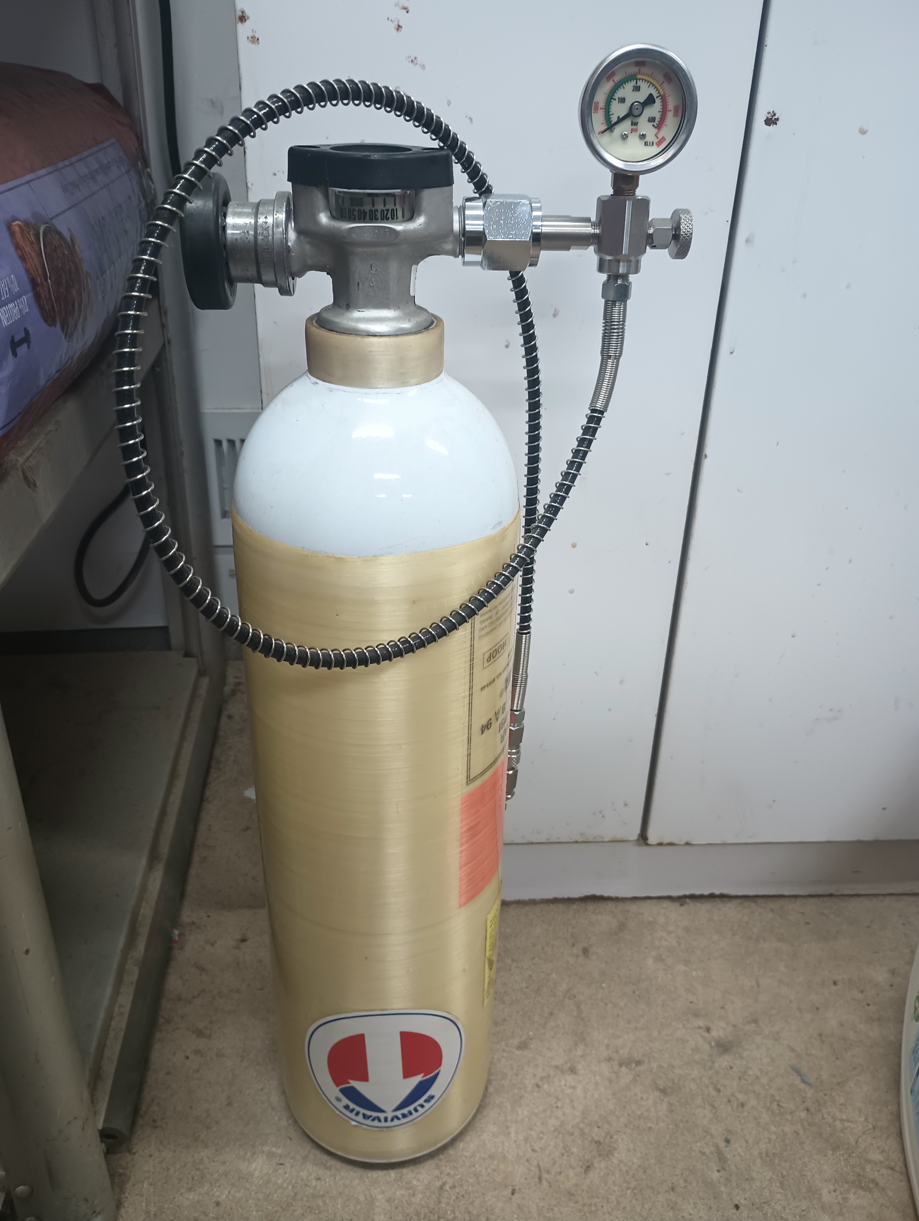

Thanks Gerry52 I did not now the factory tank valves would fit as there is no thread size mentioned on e- bay maybe I could contact the seller. The newer fill stations have 2 gauges , and and a fill nipple. I did not know the old factory valves were useable. I am learning still. Can you post a pick of your setup , so I can see how you did it , , and do you know the thread pitch on yours as the one a above is just a little more then 1 inch , and mine is 5/8 flare.
markhooper the guage itself leaks , or where screws into the valve ?
the gauge built into the valve.. the tank pressure gauge.. so l put 500# in it and turned the valve off.. first try it leaked between the tank and valve a lot.. went to the scuba shop and of course they won't work on it but no problem getting the tank to valve o ring. put it in with some silicone grease and sealed up fine.. so I filled it up to 500# again and it has a slow constant leak at the pressure gauge you see in the valve.. fill station is new and no leaks there.. so the tank gauge leaks with the main valve turned off..

I use the stock valve and gauge and a fill set from air tanks plus. I pulled the spring out of the valve mechanism and find it easy to modulate.
So, let me see if I understand correctly. You have Scott tanks but no valves on them? If you'd post pictures it would clear things up in a flash. Not sure if you want to replace existing valves or have tanks with no valves.If you have existing valves that WORK you can just get a CGA347 fill adapter off Ebay & be done with it. My 3 fill adapters have functioned GREAT for 8 years. BTW, how OLD are these tanks? Carbon fiber or all metal? Again, Pictures please! Also, sometimes with new guys the incorrect terminology is used & becomes confusing to us trying to interpret.
Here's my setup:
