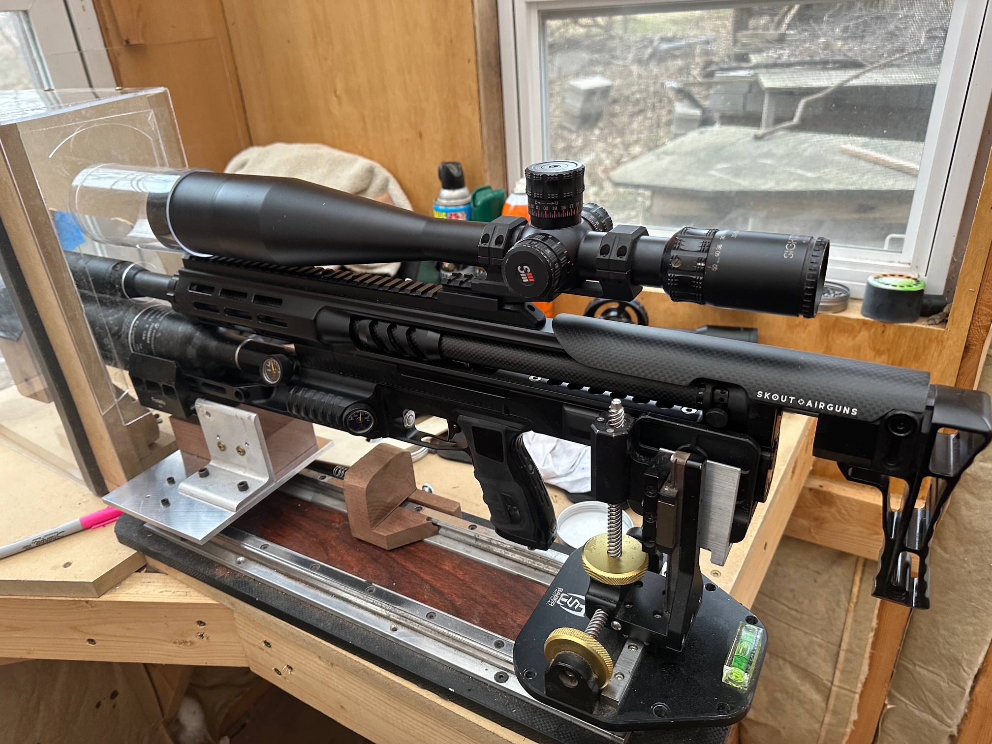

These pictures are using the settings from the factory except for the release trigger. The on of the rifle is in my bench rest configuration. It has a box on the front that fits the open window but seals out the cold from outdoors. The shed is heated to around 75 degrees and you get an awful mirage from the scope without it being in the box with cold air.
