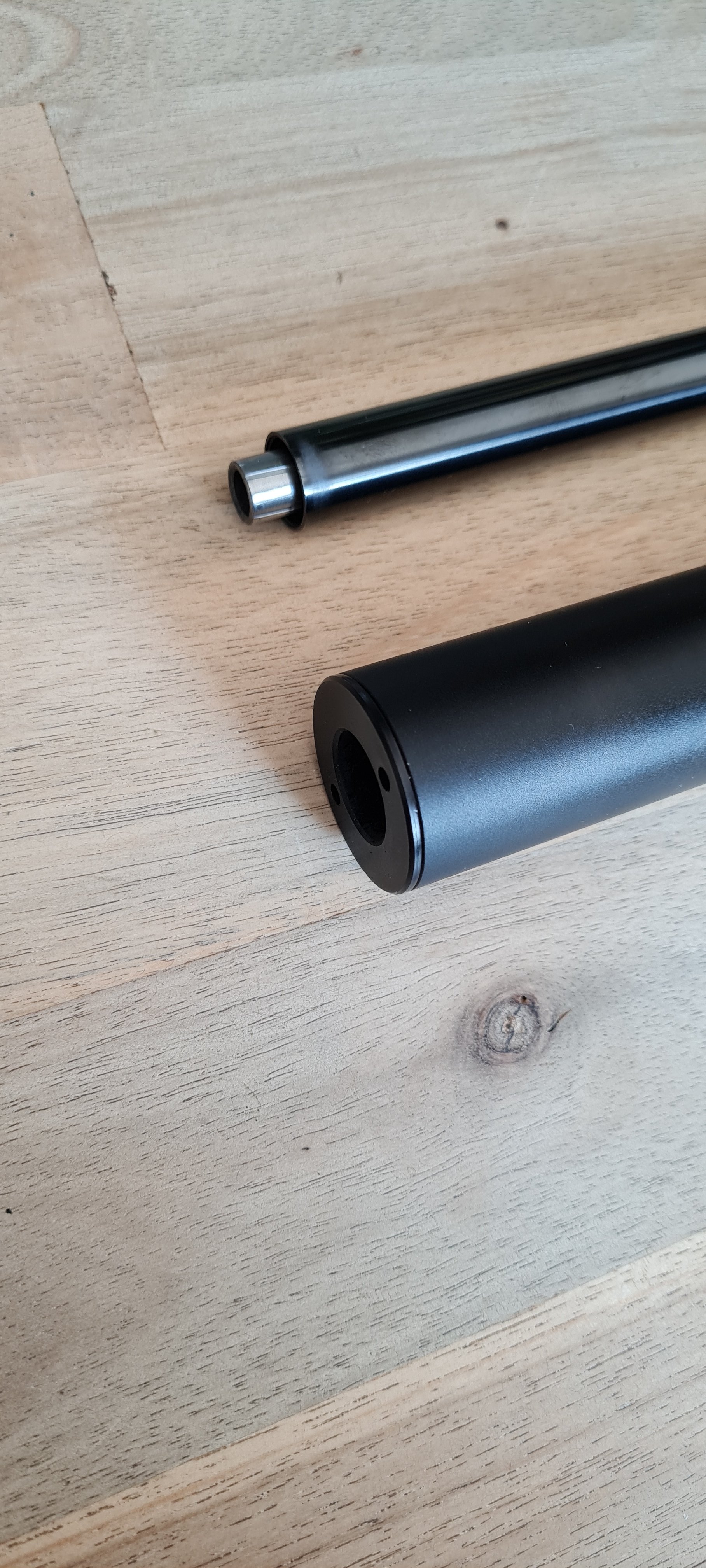

Screw stuck in shroud
Hello, its was time to clean the barrel of my Maverick. The screw for removing the barrel is stuck in the shroud. Any Idea's to remove it.

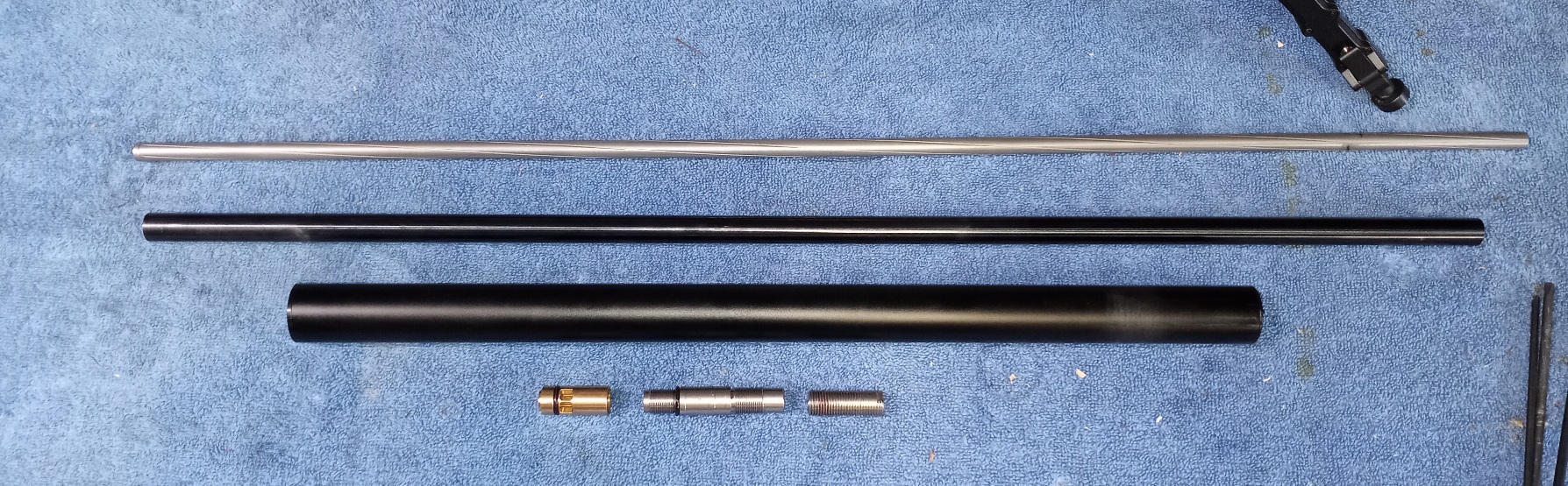

Here are all the pieces of the liner, barrel, shroud assembly.
I reassembled my barrel/shroud and left the liner lock in the shroud then worked on getting that nut out without ruining it.
My solution was easy: I added a drop of blue locktite to the barrel threads, no liner inserted, threaded it onto the liner lock and let it bond.
I picked up the shroud/barrel combo and gave it a smart twist ccw and the liner lock nut popped loose and came out with the shroud.
Clean up the locktite and resume your day.
*Pro-Tip: When torqueing the liner lock, FX recommends 1/4 turn past finger tight. The shroud must have less torque or it will pull the nut off again.

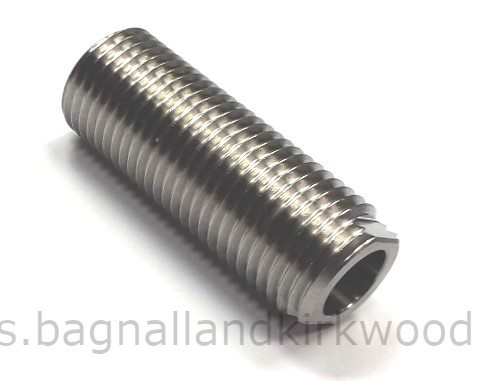

Because the liner lock has to be torqued on the end of the barrel/liner when reassembling. If the liner lock is left in the shroud, you cannot torque it properly.

If it were me lol == Leave the barrel assembly locked and secure in the rifle
+ Screw it all back together and take a hair dryer and heat the end of the shroud all the way around evenly a pretty good heat so you cannot grab it and continue holding with out burning haha.
+Then take the rubber backing of a computer mouse pad wrap it around the shroud and continue to tighten it together until the piece in the end of the shroud housing breaks free from The end cap piece that has the liner nut captive haha.
+as you continue to do this it will unscrew the end of the shroud piece and you will have access the the liner nut or you can do it the way firewalker described with the loctite above.
Best of luck to you. I have done it this way I described above numerous times with success always. (y)
