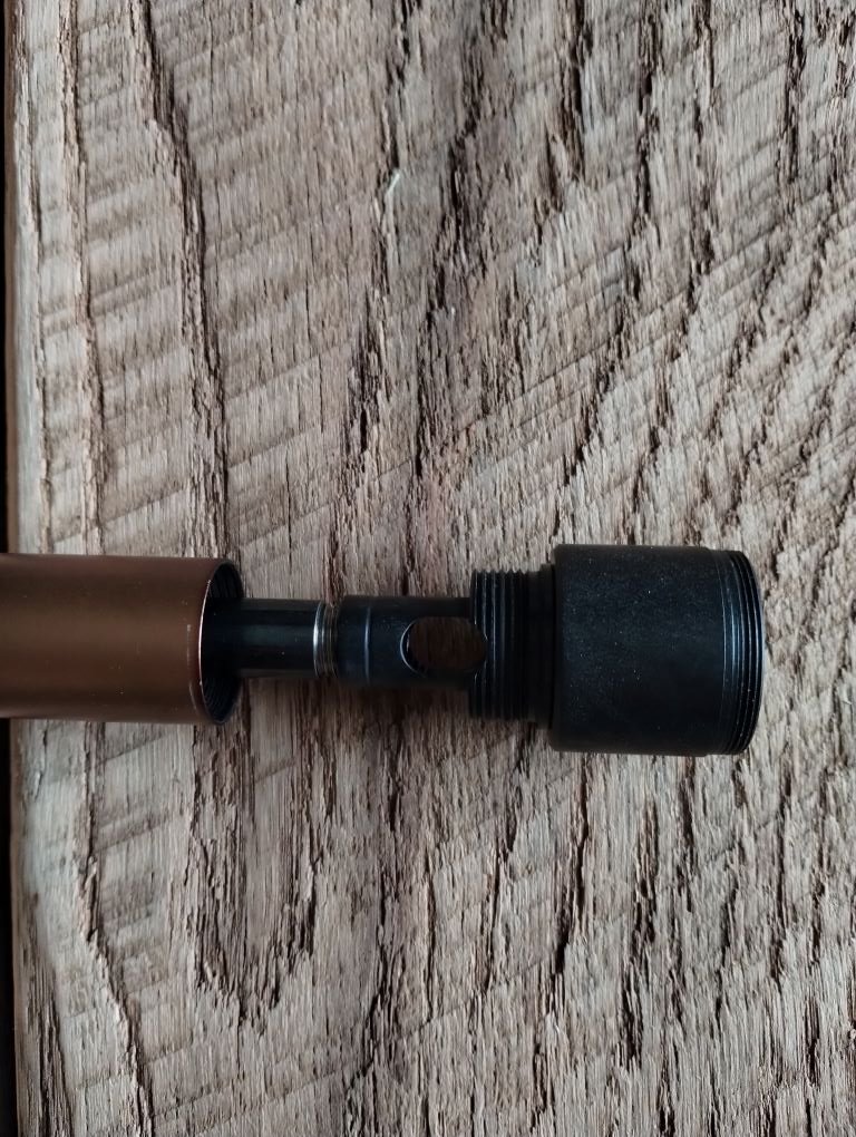

did you get it out yet? lol. This is a method I have used a lot in the past just checking .If it were me lol == Leave the barrel assembly locked and secure in the rifle
+ Screw it all back together and take a hair dryer and heat the end of the shroud all the way around evenly a pretty good heat so you cannot grab it and continue holding with out burning haha.
+Then take the rubber backing of a computer mouse pad wrap it around the shroud and continue to tighten it together until the piece in the end of the shroud housing breaks free from The end cap piece that has the liner nut captive haha.
+as you continue to do this it will unscrew the end of the shroud piece and you will have access the the liner nut or you can do it the way firewalker described with the loctite above.
Best of luck to you. I have done it this way I described above numerous times with success always.
