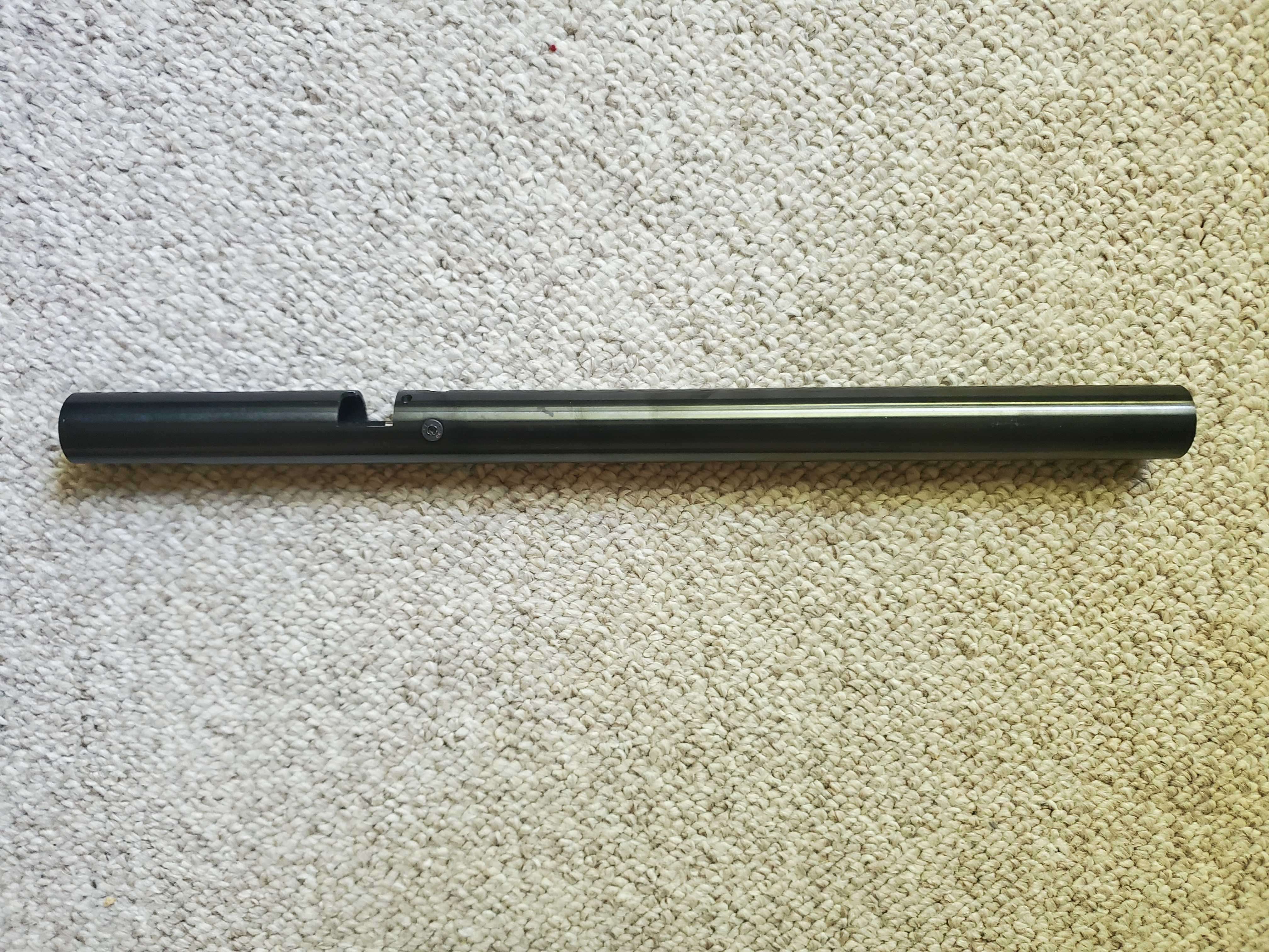

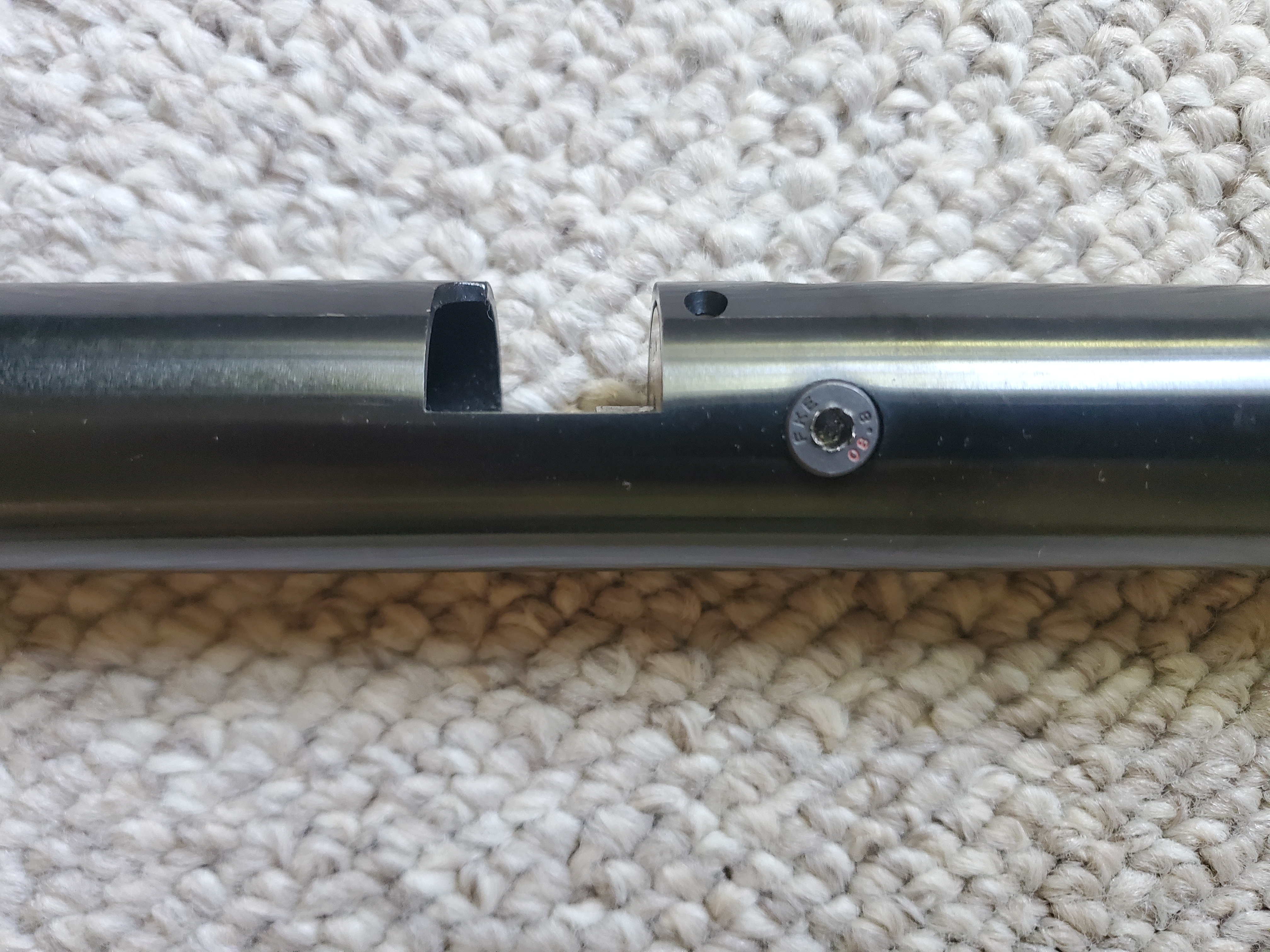

If I cannot get those screws out then I cannot change some very important o'rings.

Try Kroil and let it sit, then tap the screw with a small hammer lightly .. Do this several times.. If that does not work try a propane torch and heat up the area around it..
I agree with this approach. If the Kroil doesn't work the heat from a propane torch or a heat gun will penetrate the metal down to the threads. If Gamo used a staking compound for a thread locker it will take more heat than normal to loosen it. The valve is metal and the barrel is steel so the most the heat can do is ruin the o rings. Do you know anyone with a Tig welder? It's possible to tack weld the wrench into the damaged screw. You'll waste the screw and the wrench but it's nothing ventured, nothing gained at this point. I've managed to removed some severely damaged fasteners with the tack weld method. Silver solder is a second method if a Tig welder isn't available. The extra heat will help loosen the threads on the fastener as well. Just my 2 cents.
Today I made another attempt to get the first valve screw out.
This time I used a heat gun and heated up the screw for3-4 minutes.
I was unsuccessful removing the screw.
I think I need a better flatehead screwdriver.
I also managed to burn out my heat gun which is now completely dead.
In total I have spent 3-4 hours just trying to get out a single screw.
But I am not giving up.
So, backyard and legit mechanics alike are often aware the best or damn near the best penetrator is a 50/50 mix of acetone and Alphabet org fluid. UGH here we go again. AUTOMATIC TRANSMISSION FLUID. Personally I would have hit it with some heat. If that doesn't work, drill them and use extractor. If that doesnt work, completely drill them thru and then tap the holes for larger fasteners.... I'm not a fan of helicoils, but that can be a solution as well.
Either way, someone somewhere is a major dick and used ALL of the red loctite.
Also, given that you could not get the thing quiet, I wouldnt be surprised if it had a breech or valve leak all along. Just maybe got worse.
