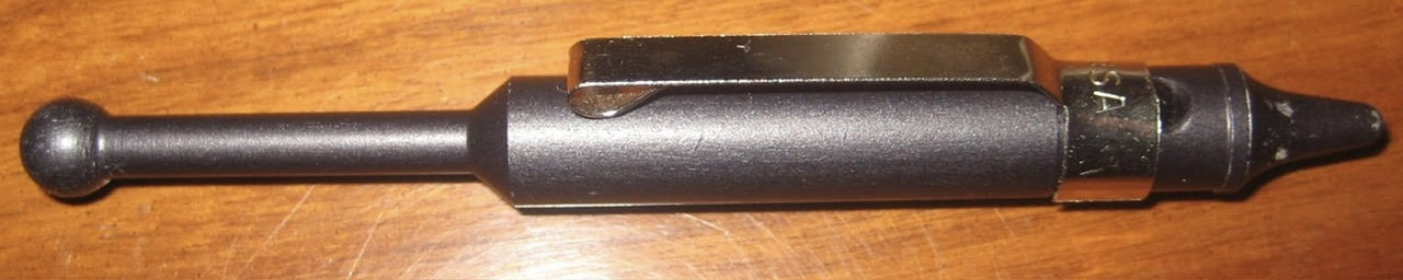

My Webly Vulcan required the Pell Pen to seat the pellets into the rifling because the relief in the breach wouldn't hold the pellet allowing the pellet to fall out before closing.

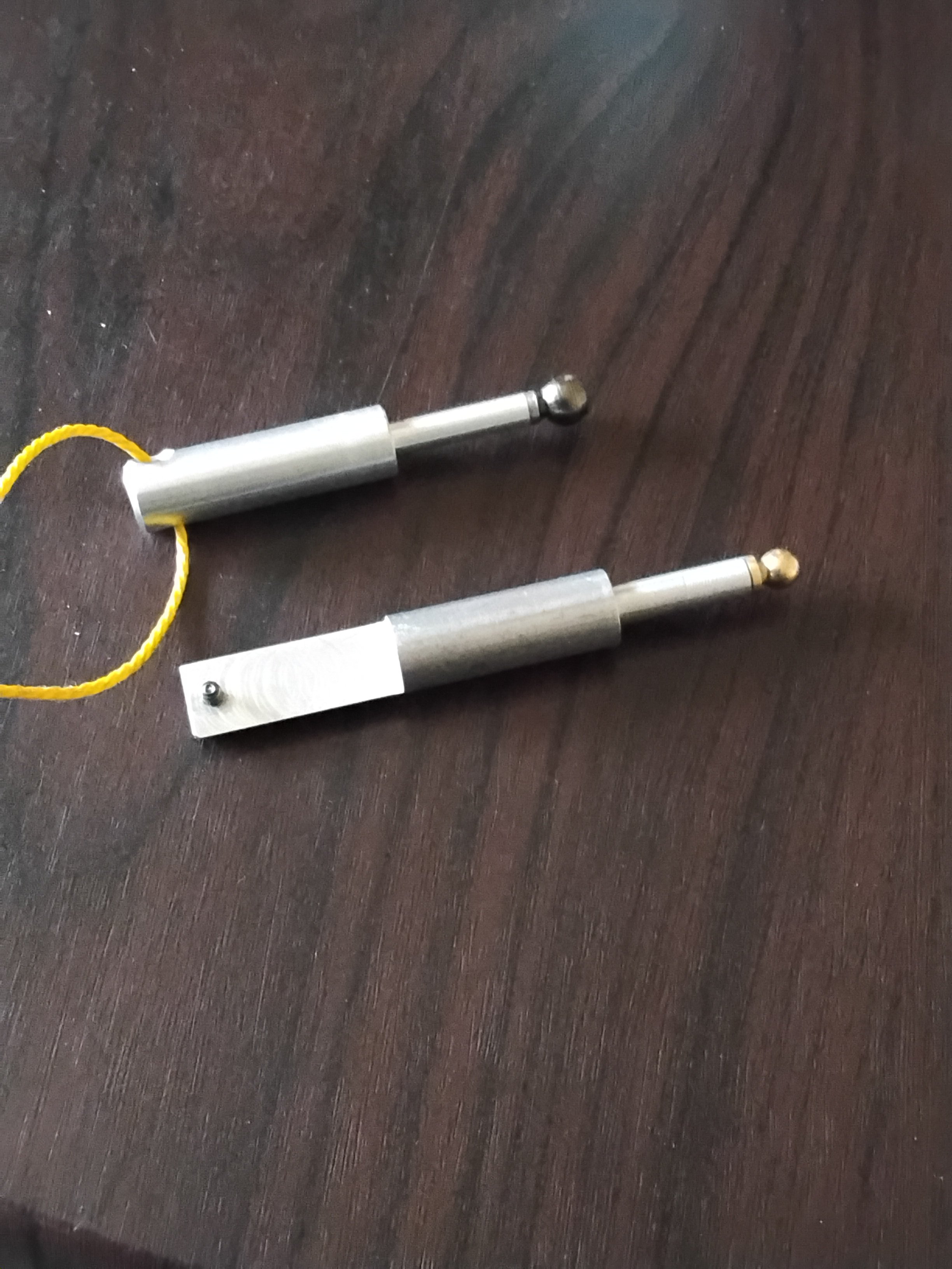

A stiff pellet seated with a ball would seal up dandy. A skirt expanded too much may cause erratic start pressures. So some pellets may benefit from a seater and some may not. Head diameter, barrel diameter and skirt thickness might change the seating friction and thereby the strategy.
I use my thumb and try to get things uniform as I can. If a guy was serious about it he would test his best pellet with some creatively shaped seating tools that offered a range of depths and skirt expansion. It might make a good pellet better or a cheap pellet best.
