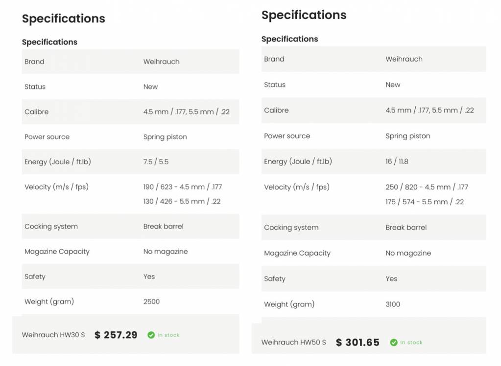

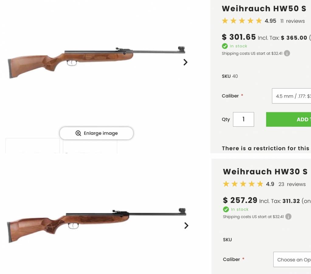

I just picked up a HW50 from Krale. I paid $354 delivered for it and a tin of H&N FTT pellets. My only regret is just ordering one tin of the pellets. I am extremely pleased with my HW50 and will most likely pick up a HW30 soon. FYI - Krale has the HW30 for around $300 delivered and their service is excellent.

I am stuck on their order page, it won't accept my standard US address, asking for an additional house number. How did you get past this? Thanks

I just put in my numerical street address where it lists house number. For example if my address was 1234 Main St., I listed 1234 for the house number. You will also need to upload your Drivers License at the end of the transaction, I think they use it to verify your old enough to purchase an airgun. You might want to look over their pellets also, it shouldn’t cost you any additional shipping and the prices are extremely good. Let me know if you need anything else, you can send me a PM so I don’t miss your question.

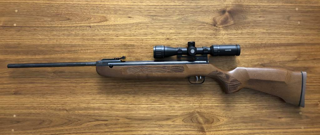

To be honest it’s simpler just to throw a scope on there than to mess with a diopter. A scope with good strong clicks, I recommend a Hawke for a springer. I use a Leupold 4x28 with old fashioned friction turrets on my R9, no clicks but it’s super duper light and low profile, makes for a sweet woods walking rifle.
You are looking at the best choices. For your backyard the HW30 in .177 or the HW50 in .22 would be perfect. Let your caliber choice pick the model. Pellets are at optimal accuracy around 650 to 700 fps. With neighbors close by you should try to get around 600 fps. The HW30 in .177 gets around 625 fps and the HW50 in .22 around 575 fps. The peep sight is a great choice also. Keeps the package light and handy. I would also recommend that you just buy a new one. These two models are everyone’s favorites and can be difficult to find in nice used condition. If it’s a bit vintage and nice it can easily be as much or even more than a new one. Good luck. Welcome.

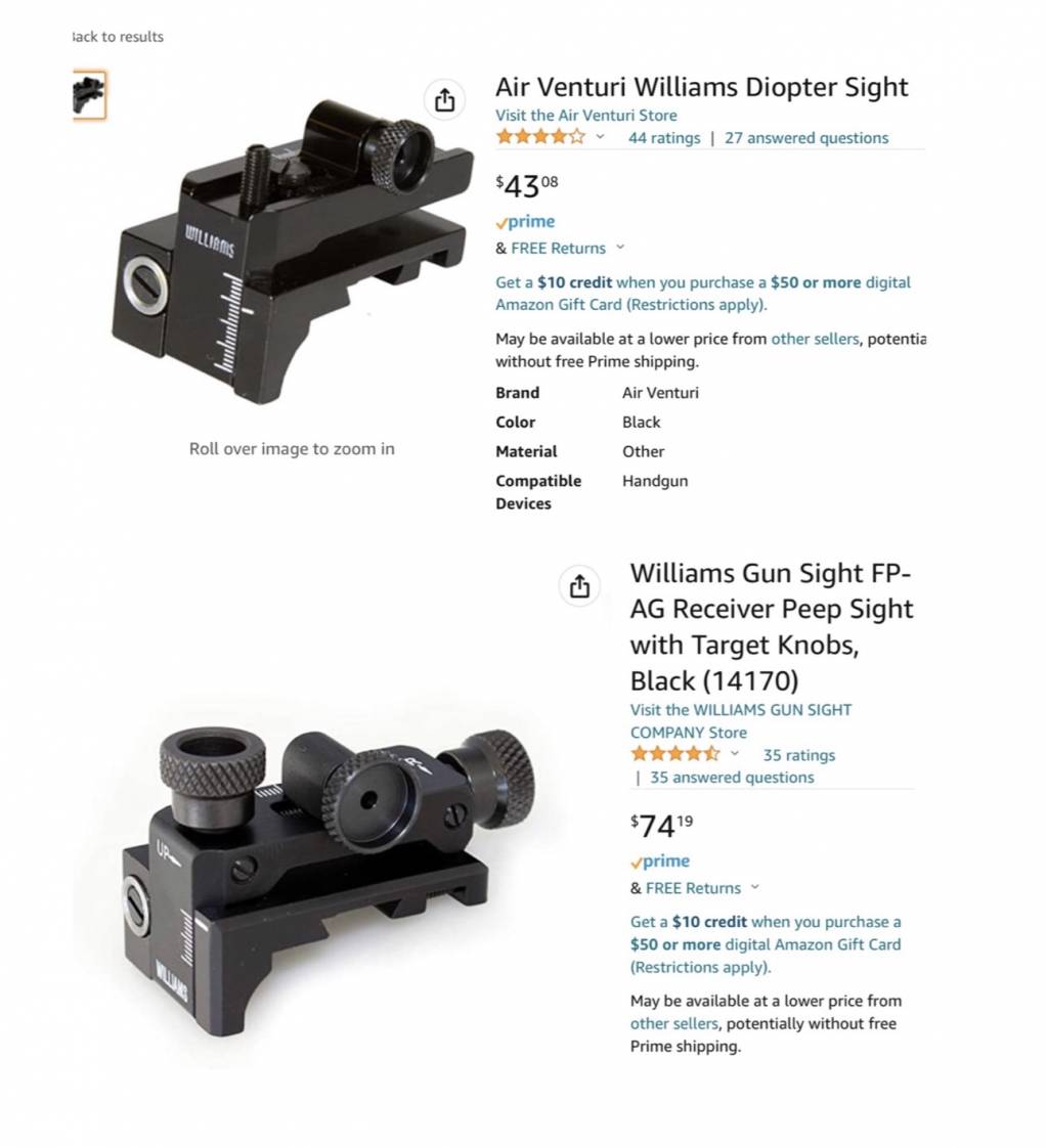

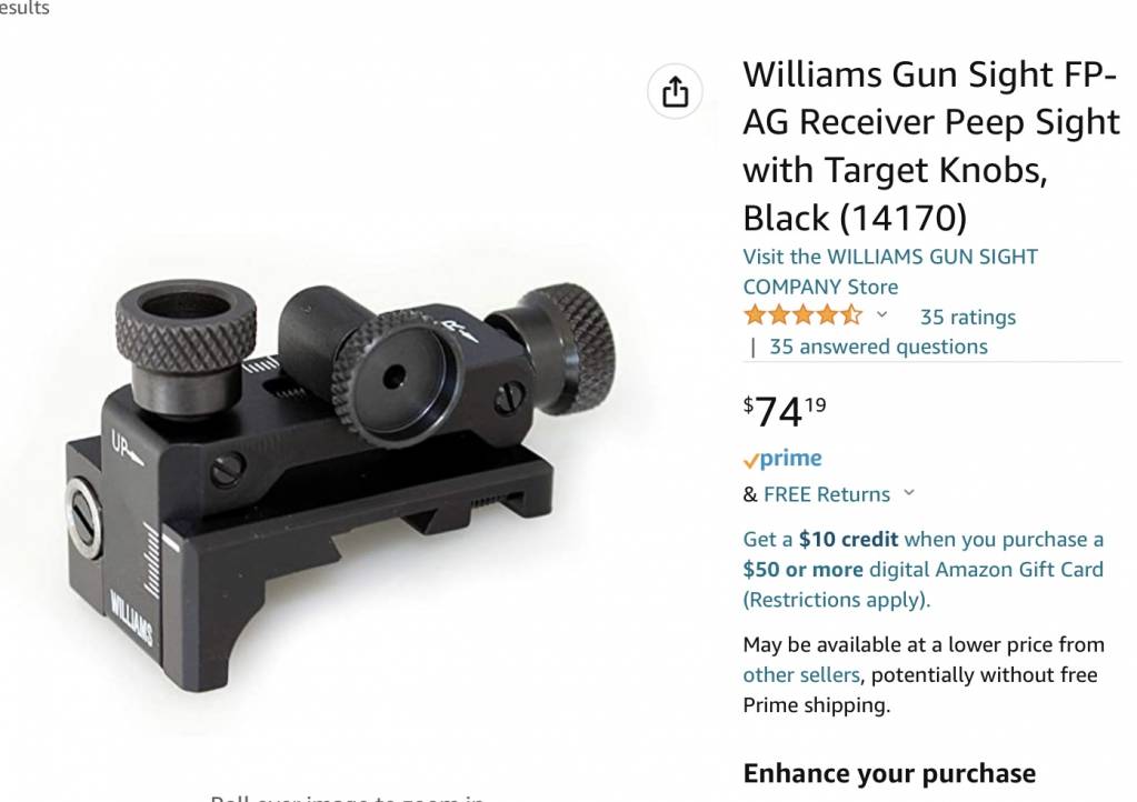

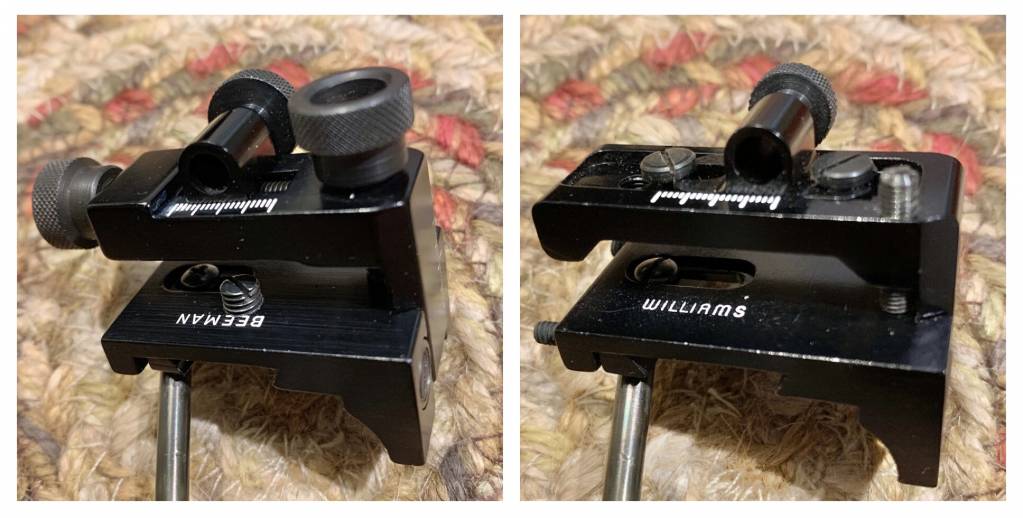

When it comes to the peep sight, I would recommend the the Williams with the target knobs. It’s a bit more expensive but very easily adjustable. You can quickly make a few klicks to your known backyard yardages. Also you should drill and tap a stop screw so the diopter stays put. It will slide rearward without a stop screw. The guns receiver is set up for the stop screw. Here is one with and one without the target knobs and one with and without the added stop screw. One says Beeman but both are made by Williams.

Awesome info, much appreciated! Thank you I'll have to look around for that one
