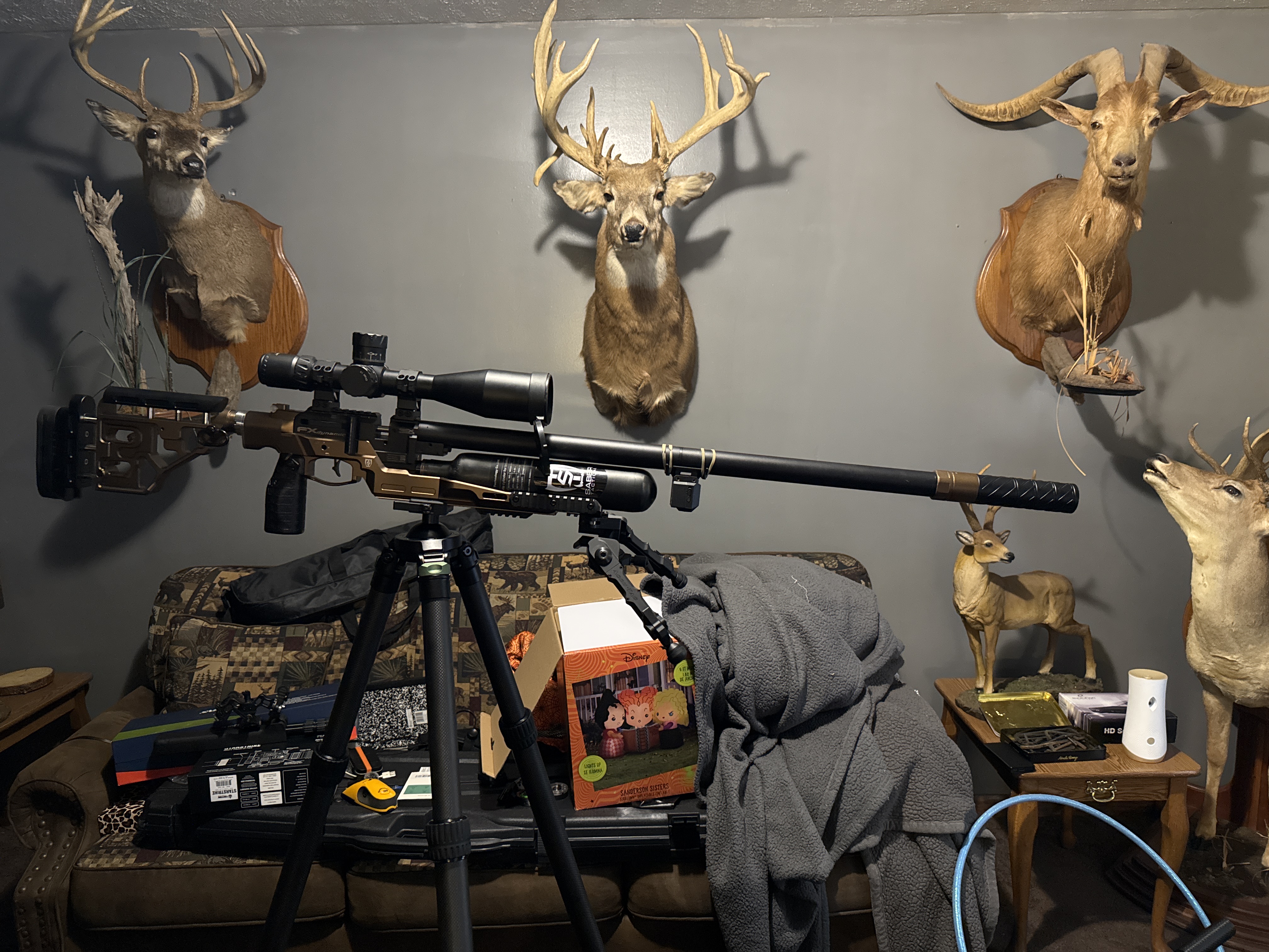

I have it shooting consistently at or above 210 ft/lbs with NSA 142 gr and dialed to the max.
My gun isn’t stock I put the saber tactical chassis on mine also. Only issue with it is they haven’t made the safety switch yet so I have no safety. They said it should be available any day but I love it
Reactions: MicMack
Beautiful setup there. Love the background!

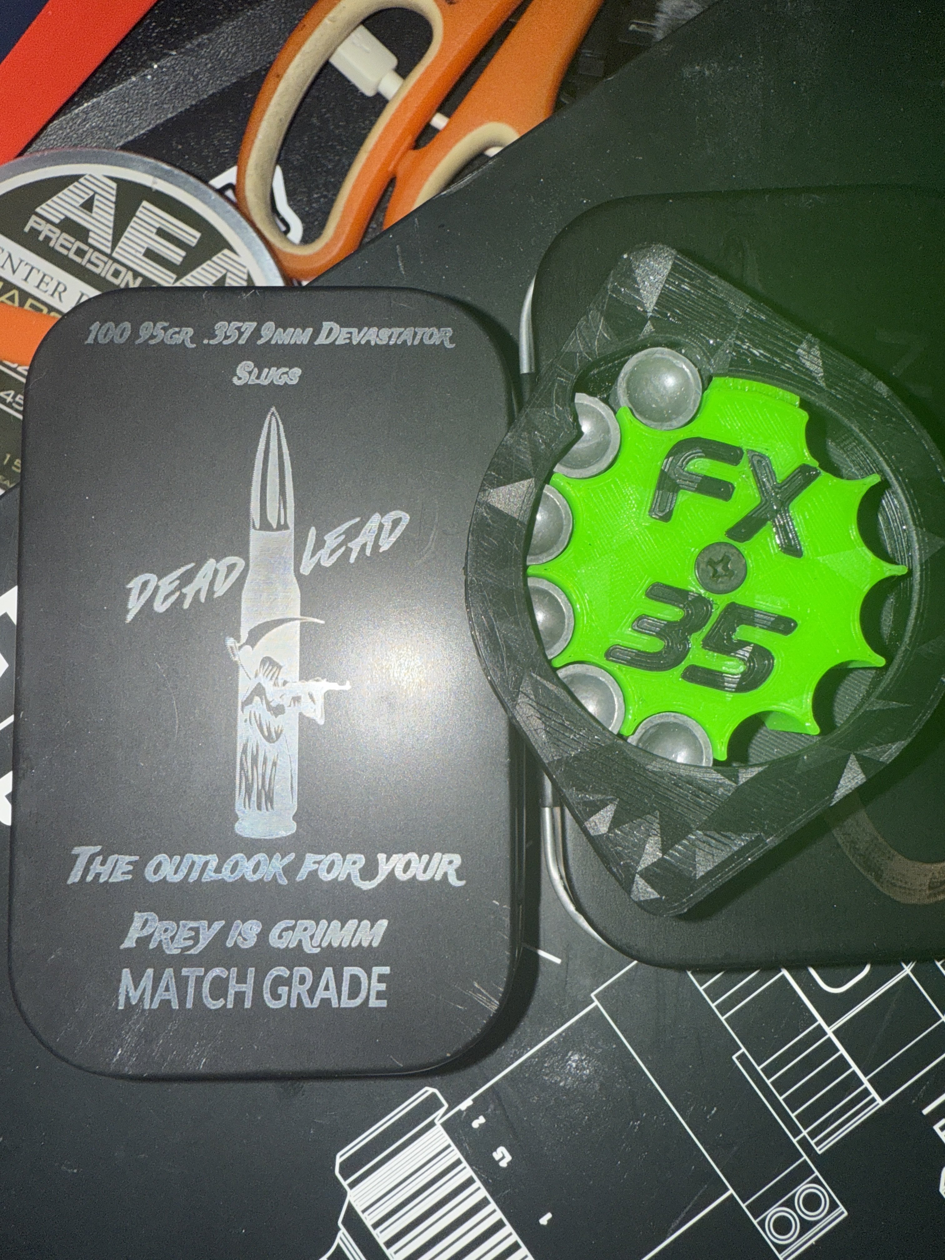

Thank you man. We are all new to this I think even though I have been doing it for 5 yr it’s still a learning experience. I’ll give you a helpful tip and that’s the pellet shop that place has helped and taught me so much and with them not being a huge company yet everything is so fast. I don’t have to wait for days to get a reply to a simple question. The ammo is also the cheapest when they run the deals. I recently started shooting dead lead slugs through my dynamic the 95g are perfect. They aren’t cheap but I hey are good also you gotta buy the orion mags they half the price of the stock mag and they hold 11 rounds
