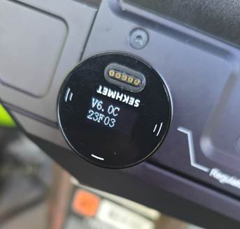

I have just purchased two of your pro gauges to help tune my FX rifles.
I have only tried one on my sub12 .177 FX Panthera so far, but it does not accurately record the shots so the data about consumption is no good. I shot 23 shots and it picked up the shot count as 6. I could be using it wrong but I don’t know how, it is in the bottle position and not the regulator.
I thought this might be a firmware issue (mine is on c6.0c 23F03 ) but the manual states I should use the data cable and not the charging cable, but both gauges only have a charging cable in the box?

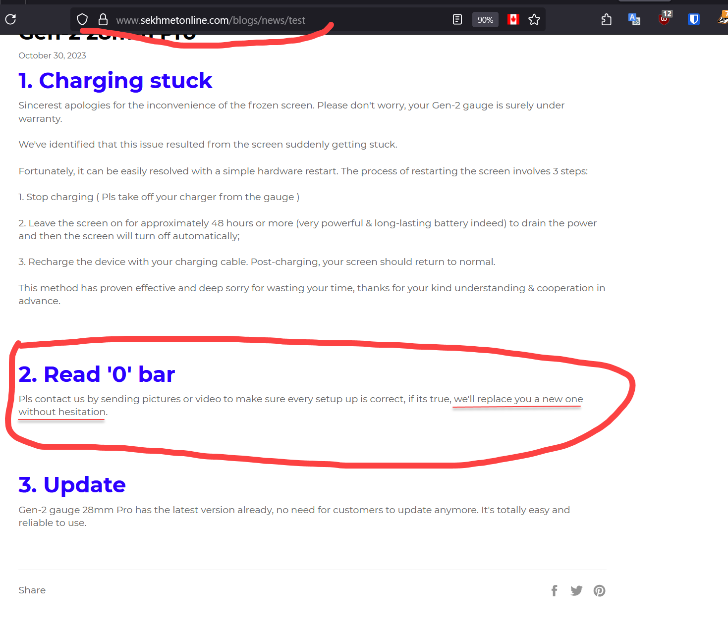

Yes, as mentioned in our conversation, draining the battery is the only correct way to solve it. I've also posted a Q&A on our website, here's the link for reference. As the screen stuck is a hardware issue, restarting will help everything get fine as always 😬
"Stuck screen is a hardware issue"
Sounds more like poor software to me.
@SekhmetAirgunAcc
So I just tried this on my 90fpe .25 and it was the same although it picked up more shots, it was still only half
