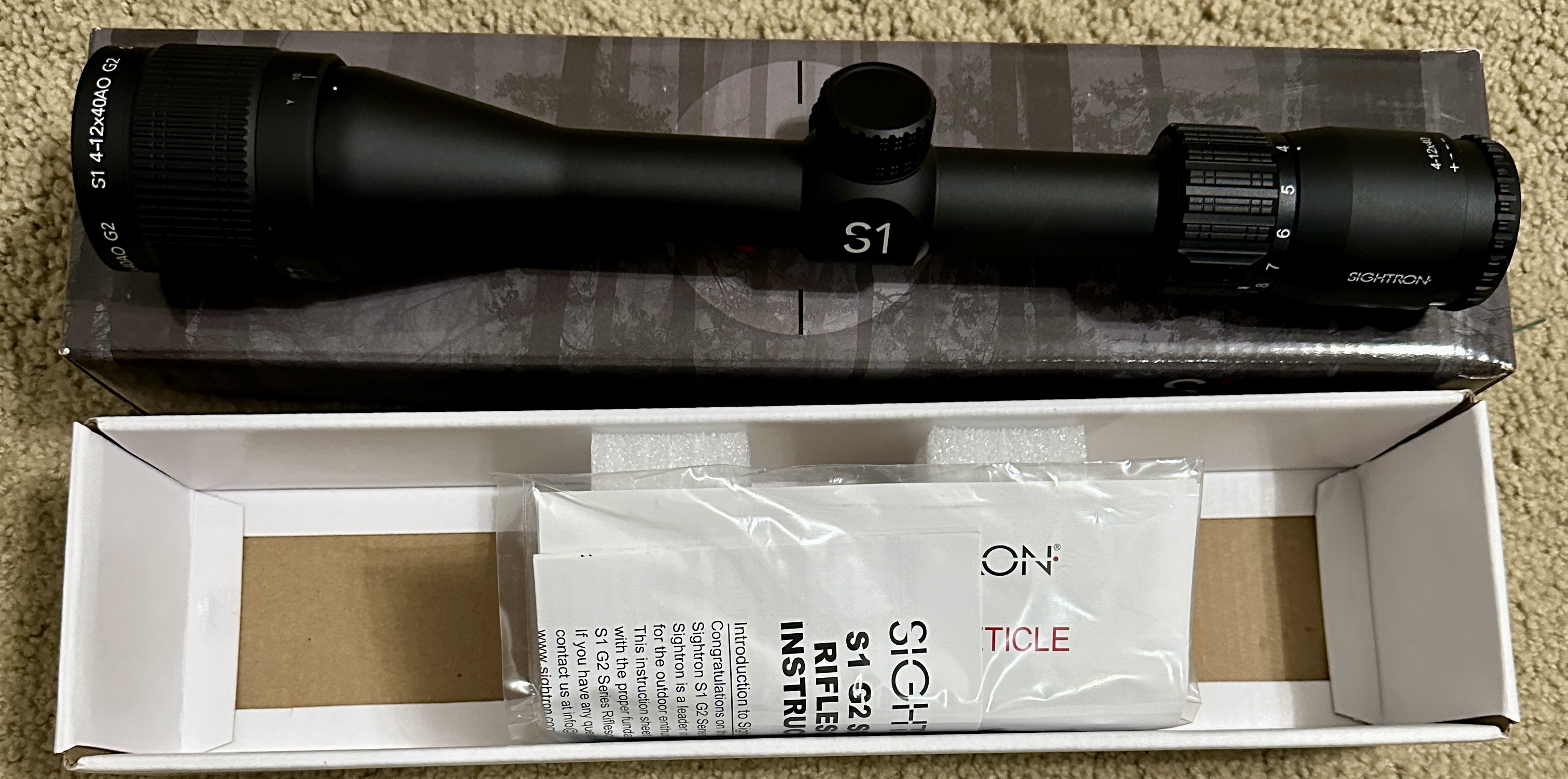

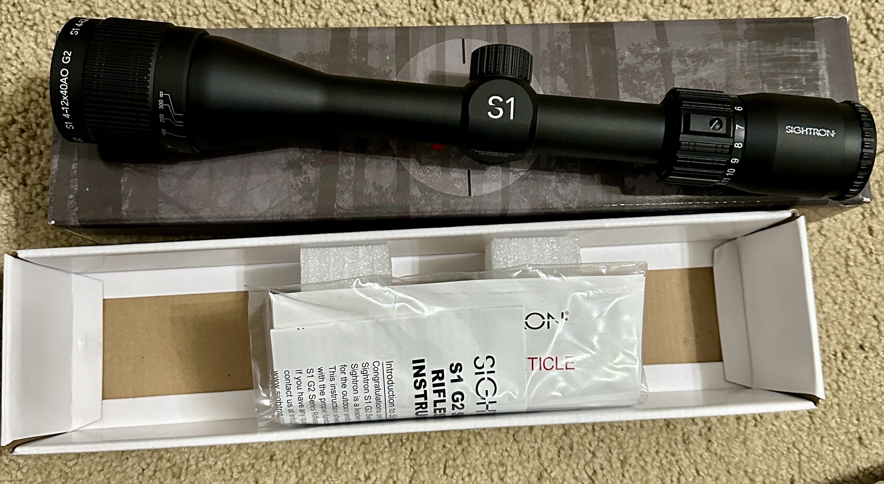

I just bought a Gen2 SI to use as a general scope on my 97K. I've never had a SI, made in the Philippines scope, so I thought I would try one. I haven't mounted it yet, but just looking thru it, it looks like pretty good glass for the money, and it has plenty of hold over lines in the reticle.
