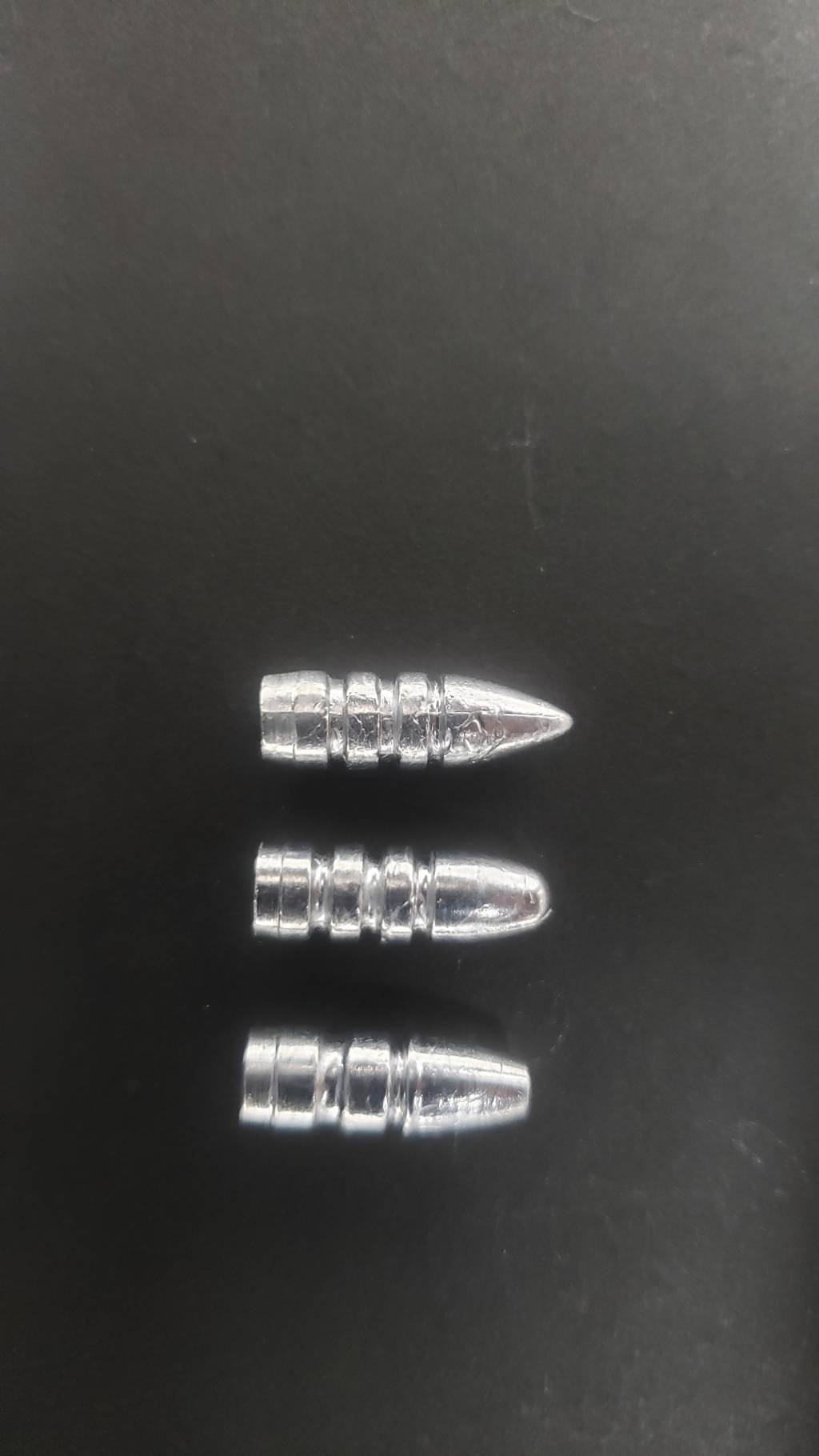

This is what I'm using the 3 are 60g -- 3/4" long..there is a Ebay seller of reamers or I could order from Pacific tools..I don't mind price I need perfection..😁..could you post a pic of what I need to order..thanks a lot for responding..👊..I need to purchase them n take the tools n barrel to the machinists so he could doit again..is a airforce gun ..when you incert the bullet if you pin the bullet in the rear you could move a bit up n down..it should not suppose to happen..he machine me a pellet barrel n it works great .. but the bullets are a bit loose..
