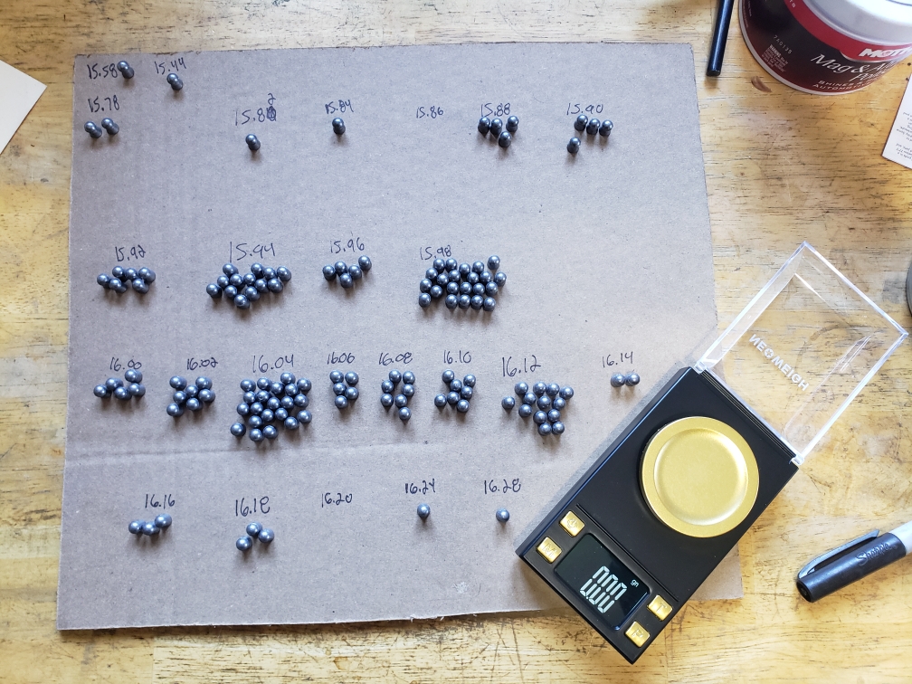

Shoot 20+ shot groups which each pellet and go from there. From there if you want to eliminate flyers, weigh the pellets. You'll be suprised how many pellets in a tin are waaaay off but you'll start to understand where they come from. From there its as simple as inspecting skirts for damage. Normally I just seperate these pellets into second tins but you could get a padded case to store your match pellets in. They typically hold 200 pellets each which is more than enough. Champions Choice sells them for like $14 or you can just buy match pellets from Pyramydair that ship in a case already.

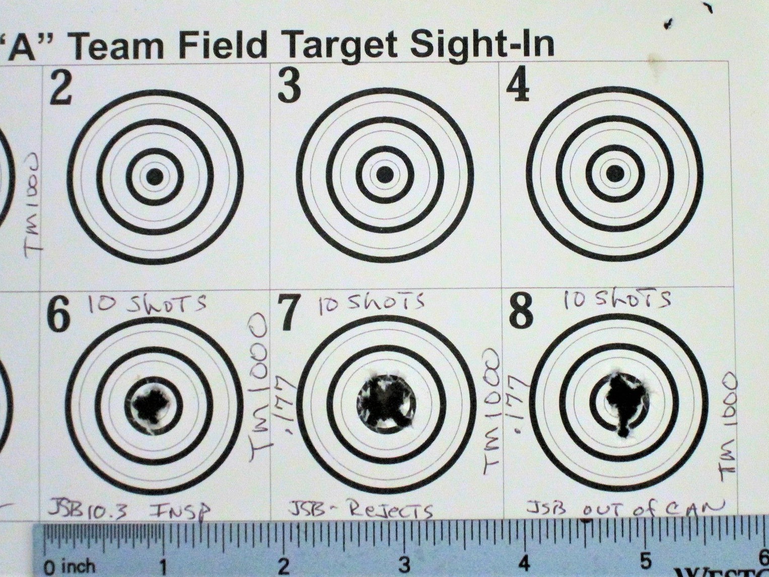

Test them all, and when you find a pellet that your gun likes, start weighing them and weed out the bad ones. Only shoot groups of pellets of the same weight. Following is a picture I've posted many times showing the difference between weighed and sorted pellets vs out of the tin.

I tried sizers. What I found is that pellets from the factory have skirts larger in diameter than the head. That makes sense since the skirt seals the air behind the pellet. If you push them through a sizing die, then both the head and the skirt comes out the same. IMO, I don't think that's the way to go. If you could just size the head, that would be better. Using a head diameter gage and separating them by size would be a better approach. Actually, I got lazy and only sort pettlets by weight. That seemed to be the most effective thing for me.

I just do 0.1gr increments and test from there. Its fast and keeps it simple. My main goal is really just to weed out the outliers that are 0.5gr or more out of spec

There's really no hard science behind it. Even as a retired FT competitor and serious springer shooter (I think most of us here are) I can still promise you that you missed many, many, many times due to inconsistencies in your ammo. Sorting out the obvious problems will do absolutely nothing to hurt your scores.

I'm not denying that actual shooting is the most important factor. What I am saying is that spending 30 minutes weighing 100 pellets for a match to make sure there isn't a pellet thats 0.5gr heavier than the rest is absolutely worth the effort. That pellet will be a flyer and as luck usually has it, it won't be a 10yd shot. It'll be 50 and it will matter.
