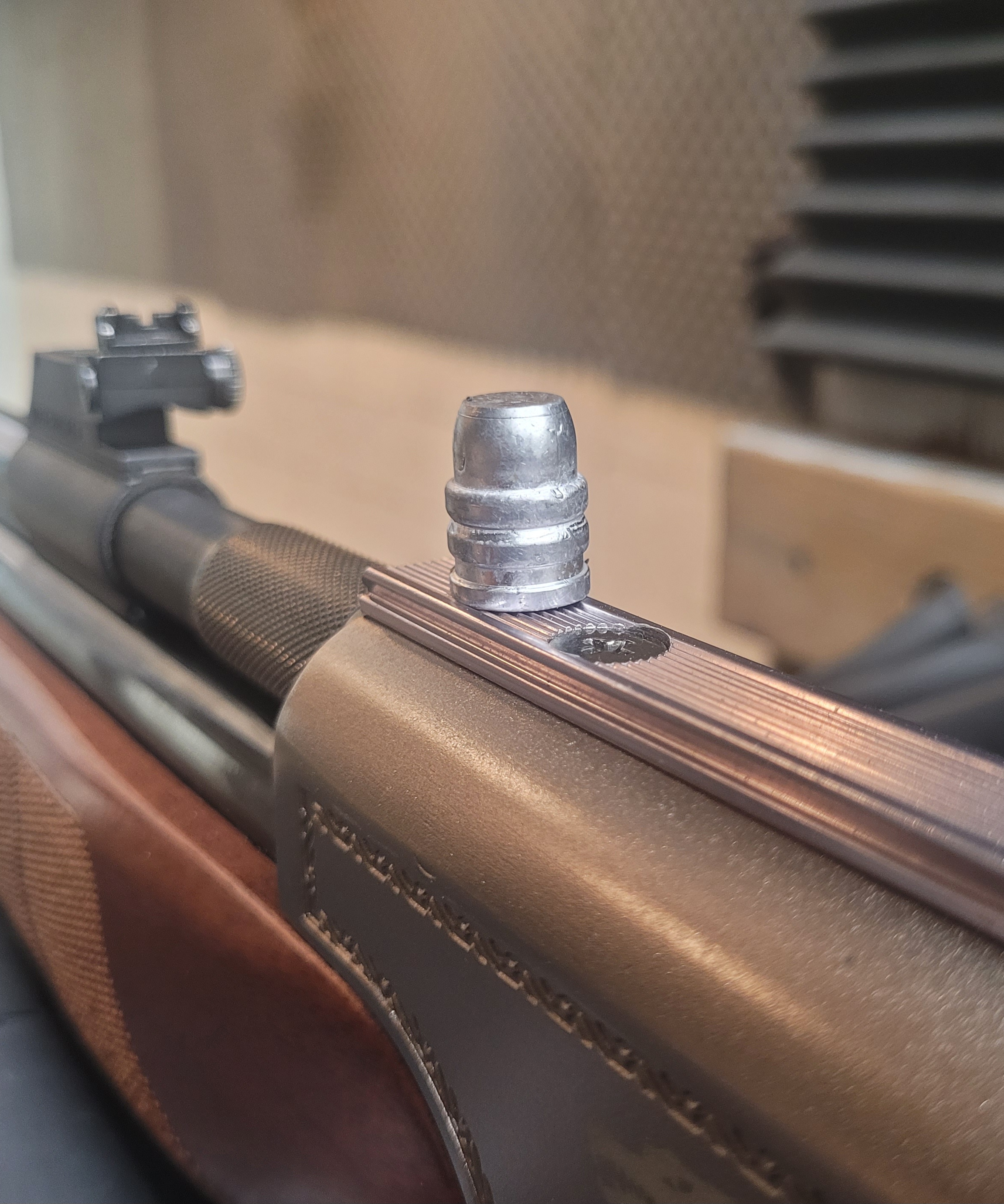

I have 200 shots through the rifle with various bullet designs. I find the throat/leade of the rifle very abrupt and pushing the bullet to engage often results in a crooked launch. Bullets that are .360 diameter and with no shoulder (not semi wadcutter)seem to enter the rifling better.

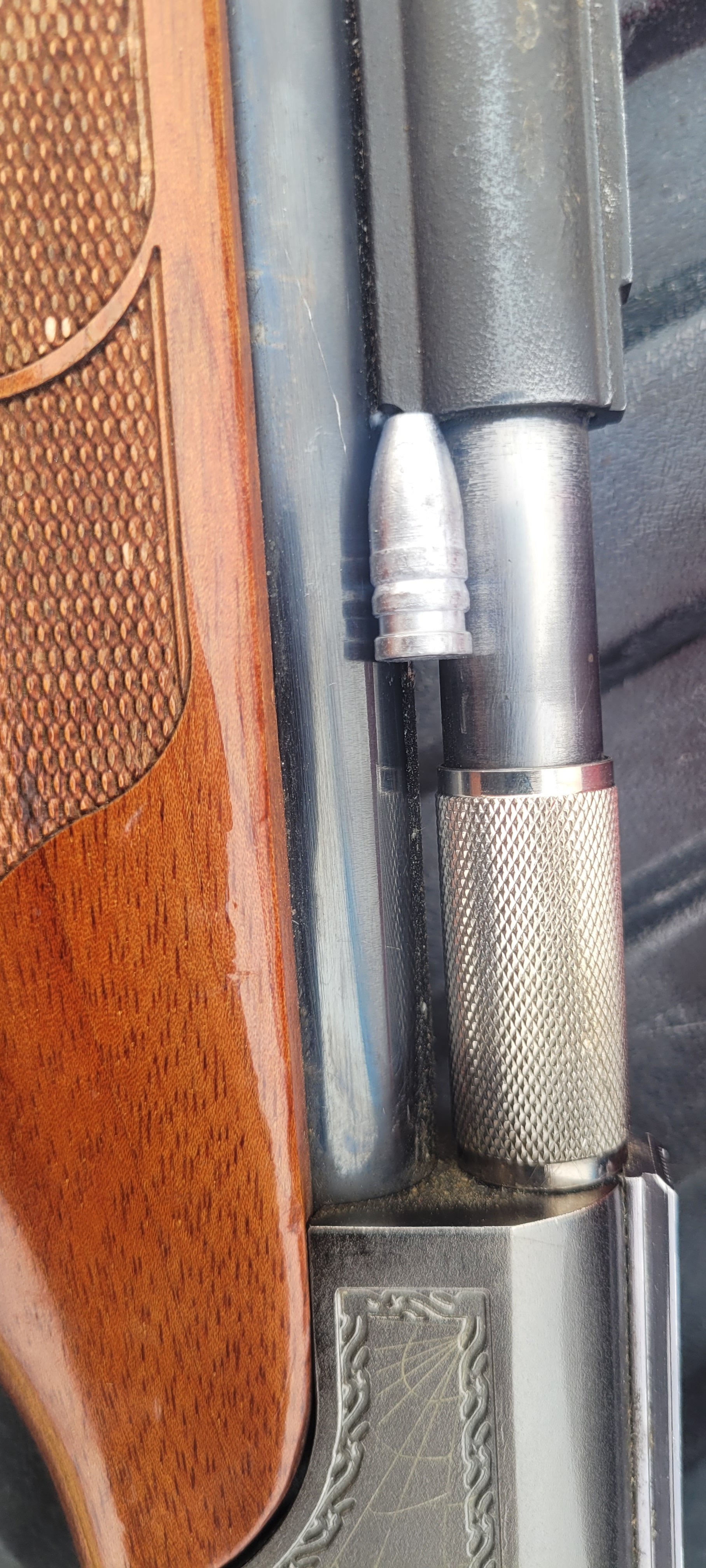

The trigger on these is a real challenge as it is heavy but also not very consistent. It is like two rusty files rubbing together. But I am getting used to it.

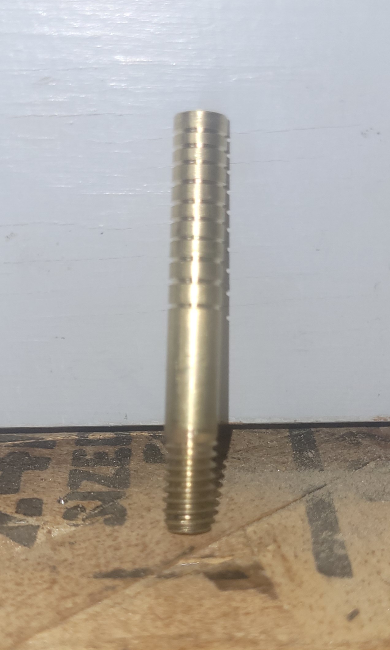

Also yesterday afternoon my cocking lever broke off at the threaded portion and was a challenge to get the stub out!
I whipped out a quick replacement on the lathe but will do a better one later on
