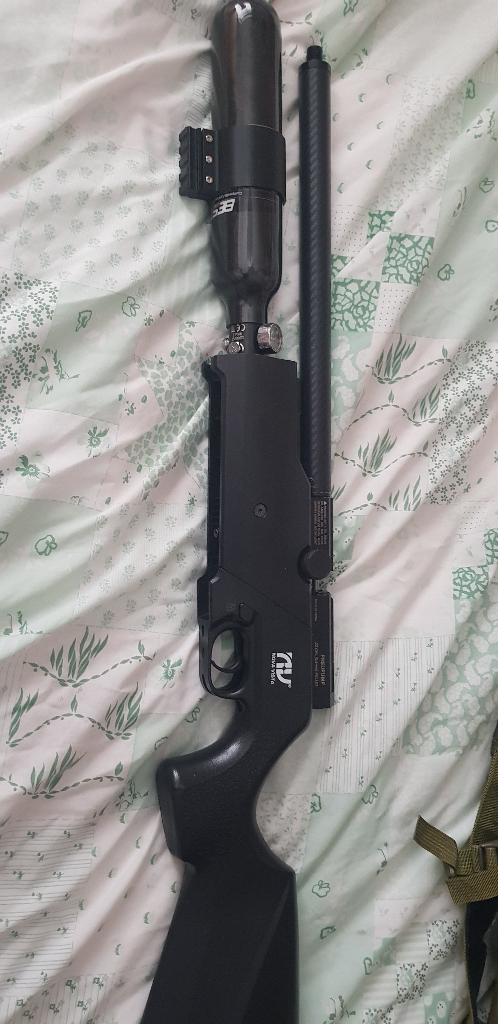

I removed pump completely and added a bottle instead.

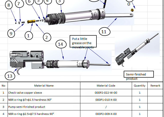

The seal in my pump is perfect. I oiled the s@#$ out of it and take 1 shot then do 5-6 pumps and repeat. The pump handle on my Aspen was locking up but it was the check valve not the pump seal. That's the problem I've had with mine from the day I got it. That's why I need to find 2 2.5x2.5mm Orings.
.id love to see a photo of the check valve part and the seal.
I drug my old crusty lap top out and got a picture of the assembly instructions showing the check valve.
