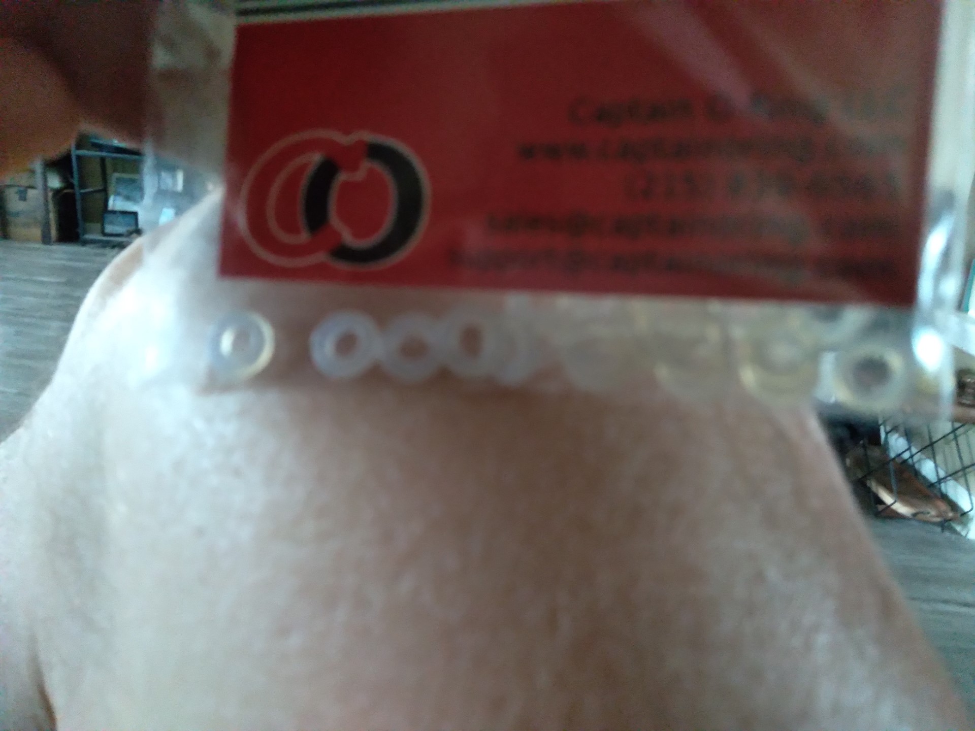

I have some seals coming this week..and will try them to fix the issue...the seals I ordered are of harder material..more durable and heat resistant and they came in a pack of 25 seals... Hoepfully it solves the issue concerning the piston pump seal. My Nova freedom is incredibly accurate , so I hope to solve the pumping arm issue/ piston seal issue. I am gonna apply a high performance synthetic lubricant mixed with graphite to the new piston seal and inside surface of the air piston chamber.

My piston seals just came in...From my research, these are the best seal/s to use...better hardness rating, heat/friction resistance. I will instal them and report back if my Nova rifle is working properly after installing these. If it fixes the issue , I will have several of these new seals left over to sell / ship at a inexpensive price to anyone that needs them.

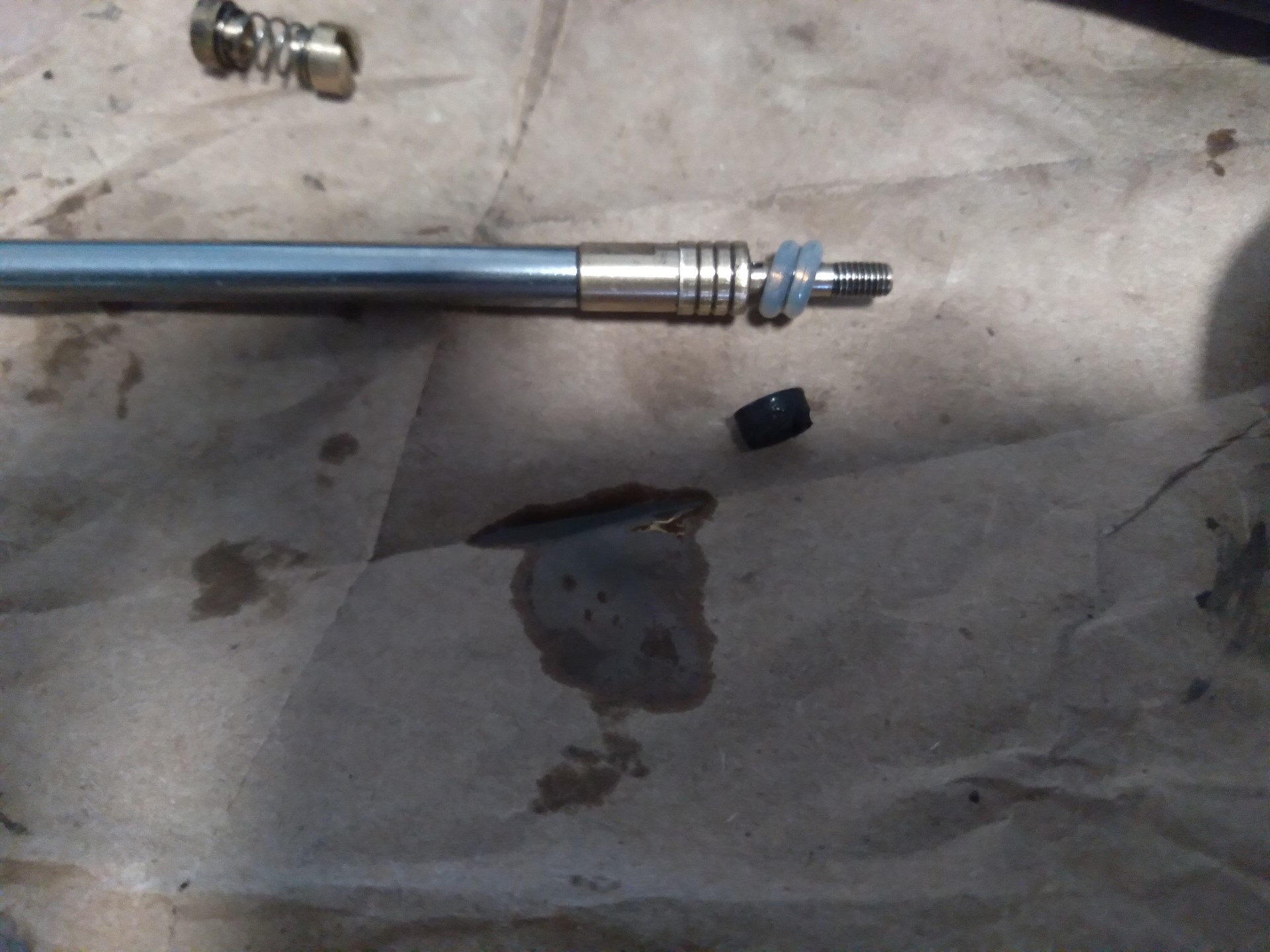

Good news and bad news. It looks like these aftermarket improved seals are the right fit. I installed them and my pump arm moves freely now. Unfortunately, it looks like I have a leak in the check valve seal because it wont build pressure. So I will have to tear it down again and investigate that issue.
If anyone has a issue with their pump arm freezing up , then it looks like these seals I ordered are the answer. They are supposed to be a much improved quality seal than the stock seal. I had read to install 2 seals just in case 1 seal starts to go bad, the other seal is a backup. Tearing down the gun is not hard..takes 1 hour or less and there is a video on it on youtube.
I had to order a pack of 25 seals even though I only needed 2 . If anyone wants me to ship them some of these seals, so you can try and repair your piston seal/ pump arm issues , send me a private message and I can ship them out to you for a few bucks but I can only ship within the U,.S. . I accept paypal.

The problem was the O-sleeve (not an O-ring) at the "small piston head" of the pump and the other problem was the poppet. Don't know if the poppet problem was due to debris from the "O-sleeve" or simply soft material the poppet was made of, but there were many posts claiming that the poppets were at least part of the problem due to the material used and I do believe that is true.

p.s. Here is what I ordered to replace the "small piston head" O-sleeve as the original isn't a ring. 2 of these O-rings to replace the "sleeve". As I recall, they worked, but not great. I would say it required about 25% more pumps to get the same pressure, but I forget.

Anyone that has sent me a private message to purchase some piston seals, I have replied via a private message , so check your messages. Id suggest to purchase at least 2 seals for each rifle you are gonna try to repair. I can only ship within U.S. and I only use PAYPAL . The seals im selling are supposed to be the best quality with a rating of 90A , compared to the stock seal which I think was only rated 70A. I can ship the seals for only a few bucks . I will take a photo of your shipment and send the photo to you, prior to me mailing it. FWIW...I have been on ebay selling for 18 years with 100% positive feedback if you want me to send you that info for reference. I wont be selling these small O rings on ebay though, because its not worth the hassle/ebay fees to sell something that im only charging a few bucks for.

The main reason why your pump isn't working and why the check valve fails is because small bits of rubber have broken off the flat 3rd stage pump seal and are sitting between the ball bearings and the check valve seal. There may also be some factory grit there as well.
It was almost standard procedure to take the 3rd stage pump completely apart, replace the flat seal with the 2 orings, I've had 2 buna-n 90D for 3 years now, as well as take the check valve apart and clean it well, re-oil, then put everything back. This is really important and necessary, even on a brand new gun!
After that, put in a peek or other delrin poppet and you'll be good to go! I only put a few drops of oil every 100 pumps.
