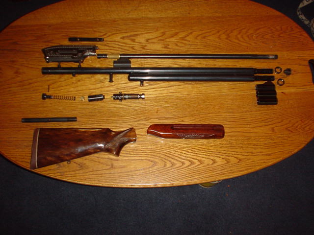

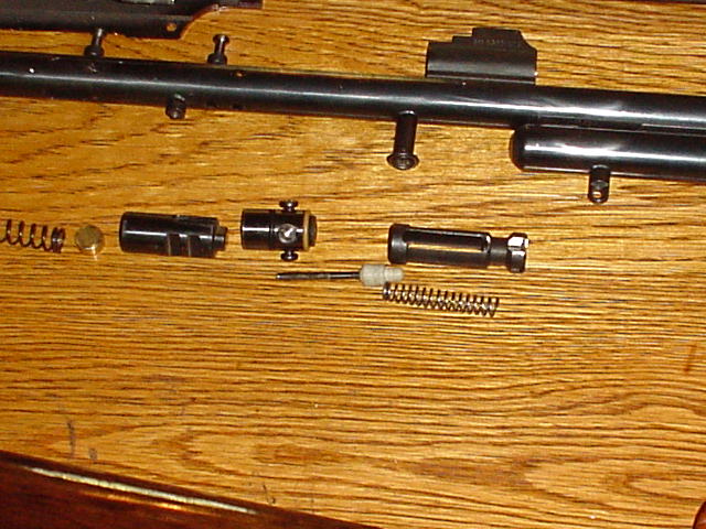

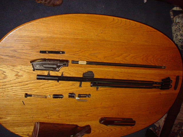

Really have not seen a new one but power level seems to seem the same as years ago with the "44 Big-Bore".
Light porting but more than anything there was only a small hole in the front of the valve body, very restrictive. Look at the valve on wood table carefully and you will note it is slotted as much as possible (show wood grain if your looking).
That alone is huge and your best use of time and money. You could google image search "QB78 valve mods"
THE largest restriction is the barrel sliding over that nipple on the receiver. IF you went to the needed effort to fabricate it so that the baller slide inside the nipple/transfer part max power would be achieved.
Chrony your rig, then just slot the valve's sides and reassemble. You will love the results.
