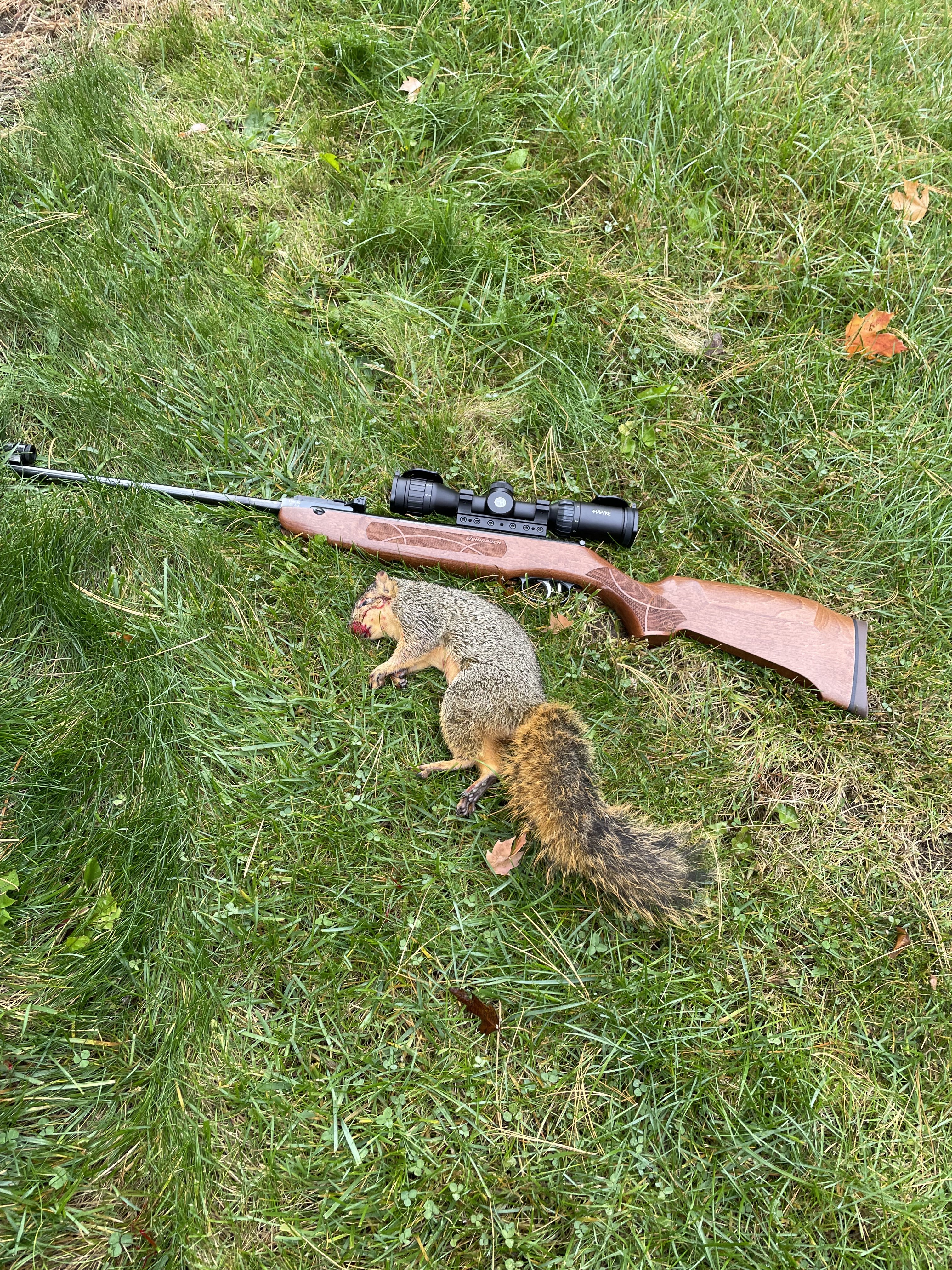

My HW30 is tuned to a massive eight foot pounds with the H&N Field Target Trophy .177's at the muzzle. I took this buck at thirty yards so figure six to five foot pounds probably. DRT.
