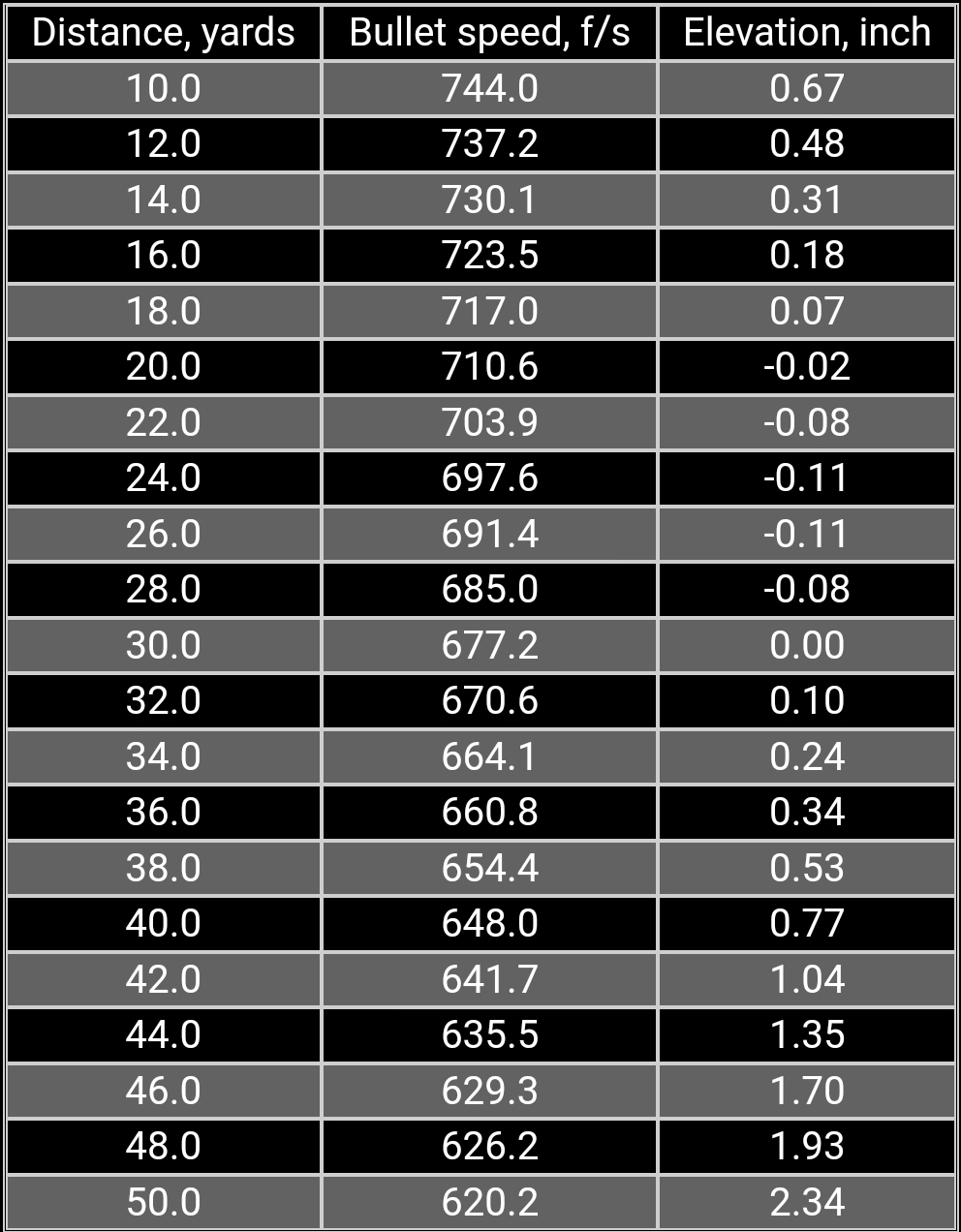

Zero your gun around 30yds to make your life easier. Here's a rough idea of holdover using my 11.5fpe 430L as an example.

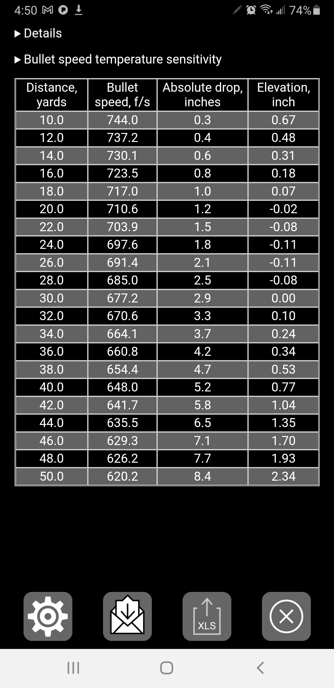

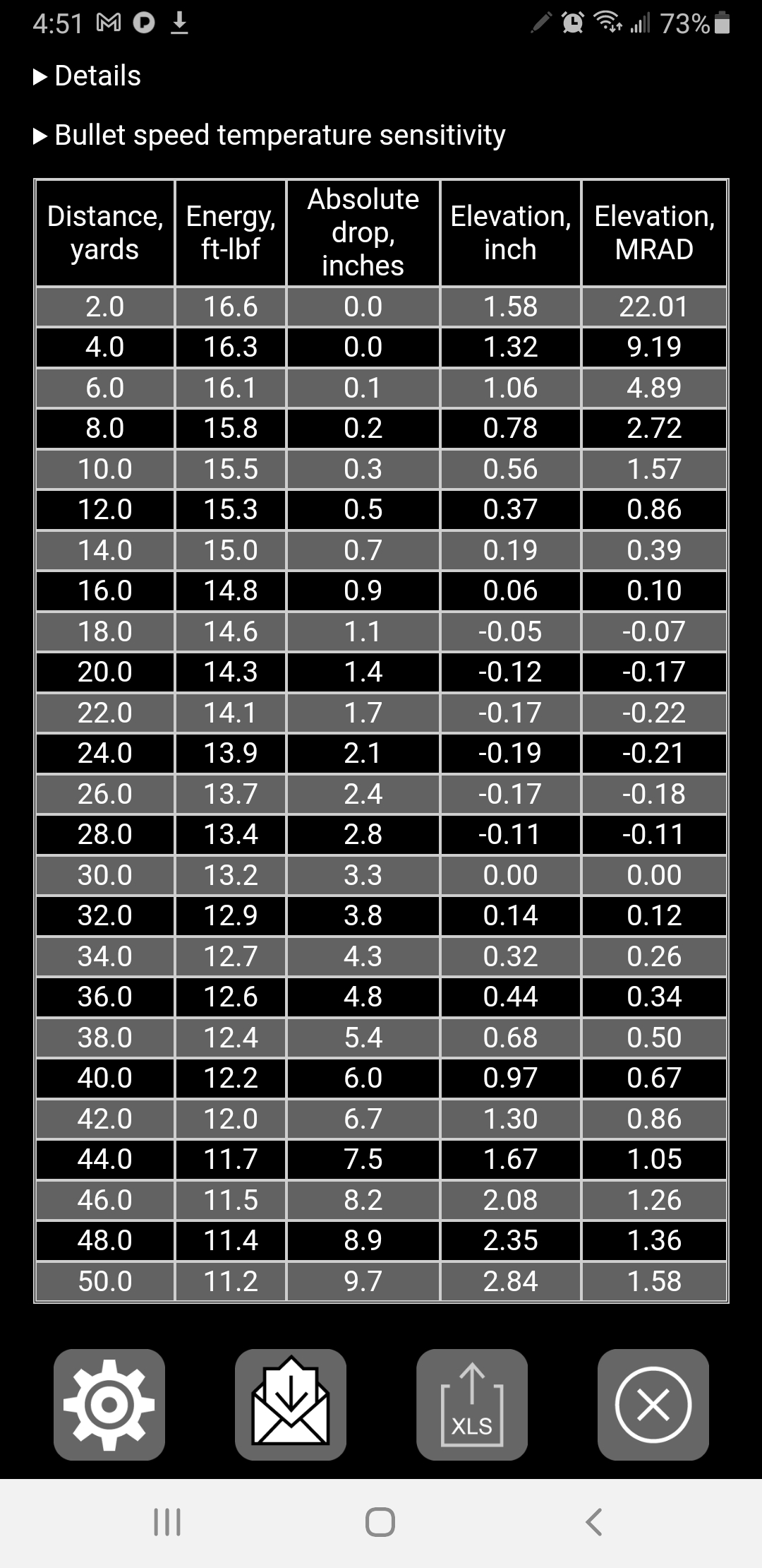

Also don't worry about "drop" so much. My 17fpe 97K has more total drop than my 430L at all usable ranges but is still putting out nearly 50% more muzzle energy.
HW97K .22 DROP
DIANA 430L .177 DROP
