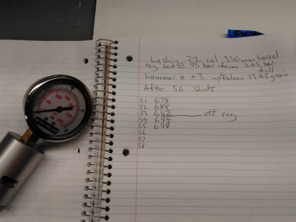

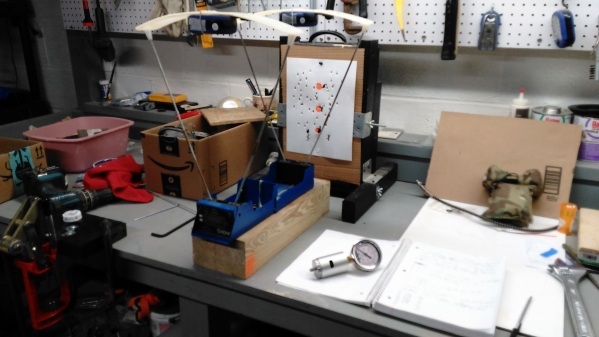

Decided to set my Leshiy up for low power to use inside farm buildings for pigeons and pest birds. I have the .22 cal. 350mm barrel in now and did an initial set-up with good results but it seemed the Huma regulator scale was not right on. So went ahead and ordered the Huma reg tester and decided to change to the analog manometer. With reg. tester it should be easier to set up the Leshiy more precisely for different caliber and pellet combinations. I went ahead and set the regulator at 95 bar and the hammer at plus 3 and that gave me between 13.6 and 13.8 fpe with the two pellet types tested. I want to see how many shots per fill I got so I shot 50 pellets at the target while watching the manometer. After that I proceeded to fire five more over the chrono. It finally came off the reg at shot 53 and that was from a 245 bar fill. That amount of shots will take care of a lot of pest shooting. Some pictures of my testing. Bill

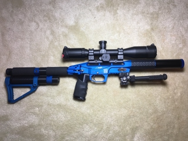

Toku you said you wish your was still quieter? Is that statement with the extended baffle kit in your pic? what FPS are you shooting?
Just wondering as mine is one the way and quiet is a need for me.
If you find it loud, give @STO a shout. He's made an insert for the leshiy. If it's anything like as good as the silencers I've bought from him, you'll be very happy 👍🏻
