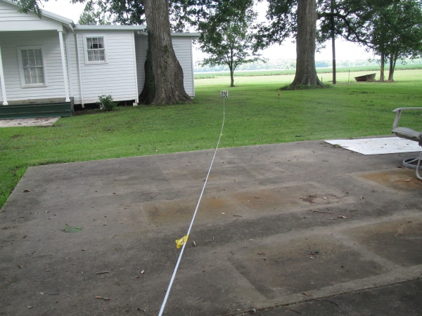

Since you also need a holdover chart for each distance. Put a cardboard box at the end of a 200 foot tape or a use a small diameter rope with yardages marked on tape with some targets on it and do the ranges and holdover at those distances at the same time. Don't forget to turn the power down to 16X for the holdover. OR, range at 32X, mark the wheel and then shoot for holdover, but at 32X the holdover will be 2 times as big as 16X, so write down half of the holdover if you use 32X or one third if you use 48X .
