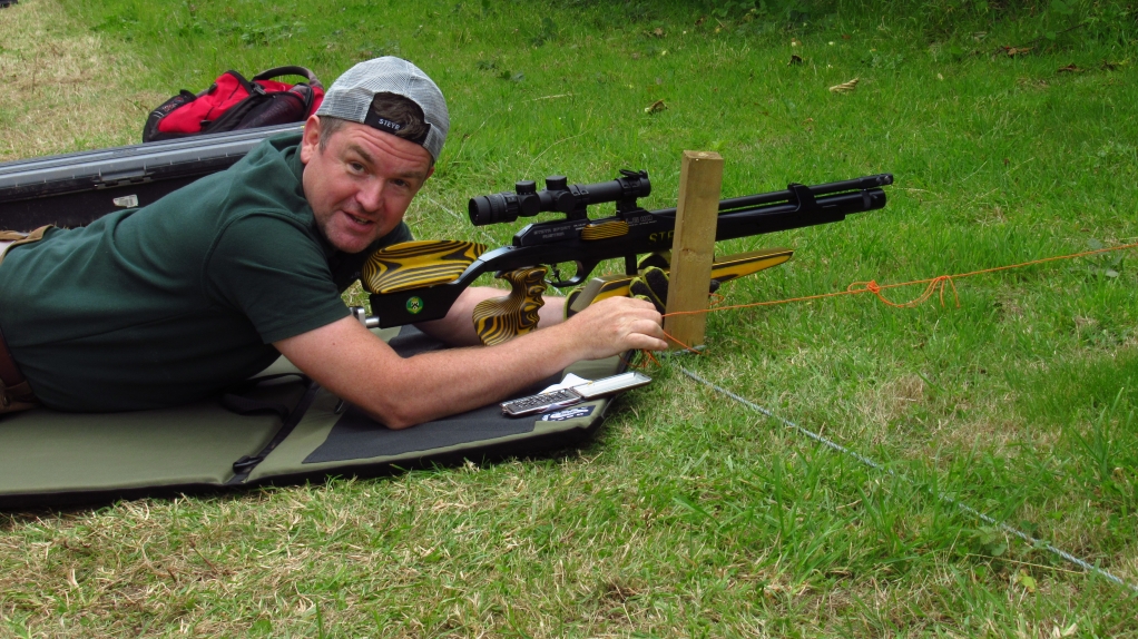

I shot a couple of HFT matches when I was in England. I used the same gun that I had just shot at the WFTF World match. I set my 6-24x50 FFP scope to about 10x, with a 23yd focus and zeroed at about 27yds. The fuzzy image was not the main problem for me. The main problem was the severe parallax error when out of focus. Without having perfect eye center on the scope, my POI was way off my POA. The large objective and large FOV are a disadvantage in HFT. Many competitors used 24mm and 32mm objective lenses which have a narrower eye position and more forgiving depth of field. You are not allowed to use ocular reducers or objective reducers. So a smaller objective lens is a desirable feature. That combined with a very consistent cheekweld (which I don't have). Other than that it was a fun game. But with 30 lanes and only one shot per lane, there is more getting up and down and less shooting.
This guy was one of the better shooters at an HFT match that I participated in. He only missed a couple. Check out the scope:
Hey Scotchmo,
Totally agree. There is a couple of work around for that situation if you're stuck with a larger objective. First is to install a kisser on your stock to help repeat position. The other is to mount your scope a bit more forward so that you encounter a black ring around the image in the scope. I employ this to great effect. If you are canted off to one side, up or down or whatever then it will show up here. Or buy one of the MTC scopes (which aren't all that expensive compared to FT glass). Thanks for the input. If you find yourself down this way, please stop in. I would love to meet up and do some shooting!
