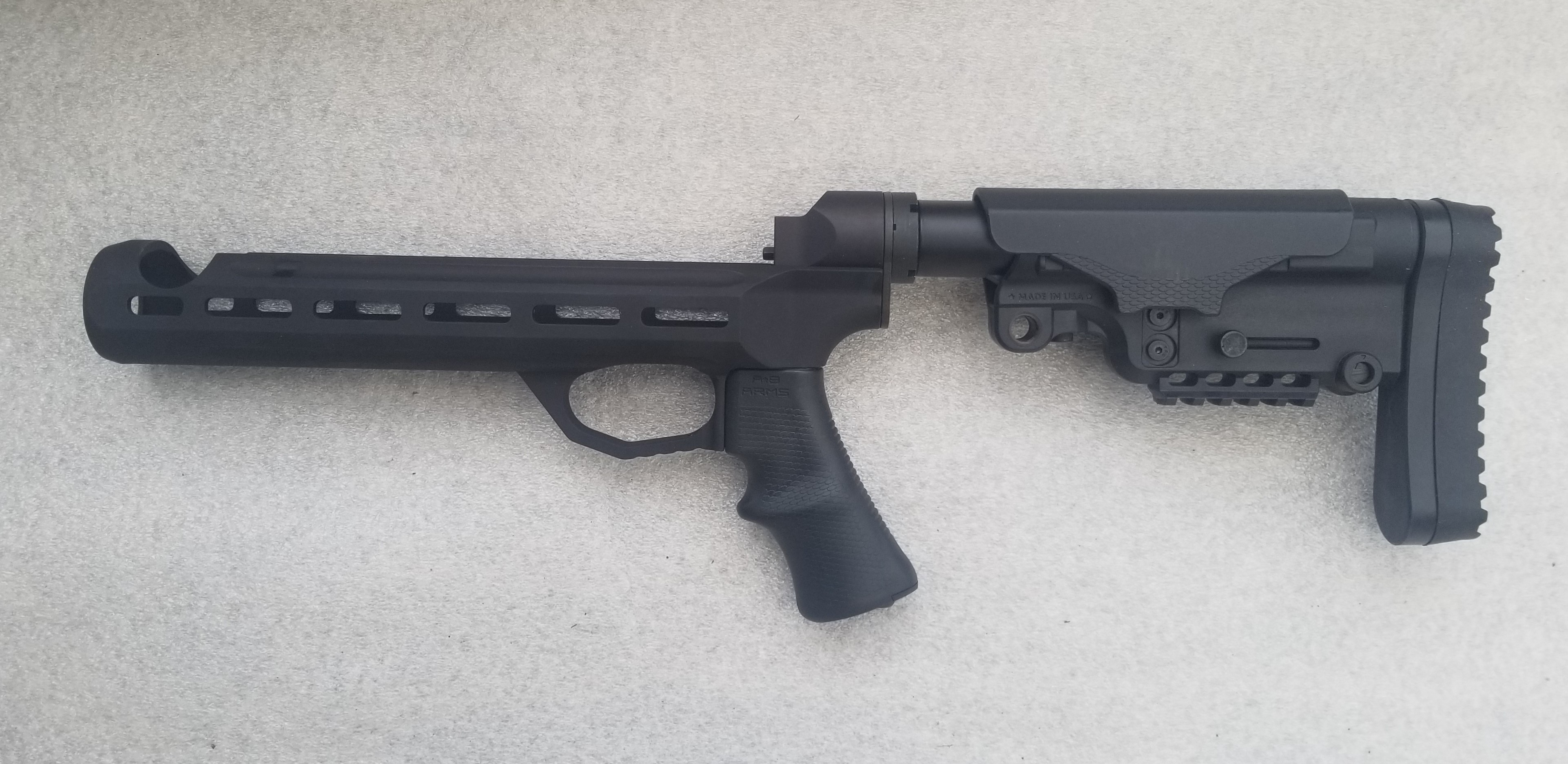

I vote for the
offers so many options for Benchrest shooting.
