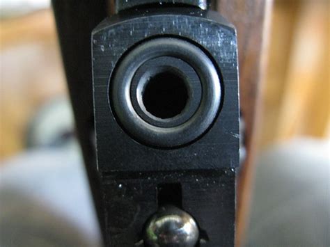

Severe accuracy problem
Could this be a problem?
Only the top is beveled

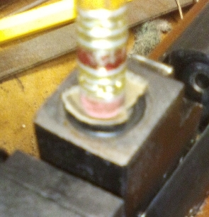

Looks better than some Dianas I've seen. Shouldn't be an accuracy concern.
I'd push a pellet through the bore, and see how it feels. Hopefully it has a choke of some sort at the muzzle, and if so hopefully it's not overly tight.
As for the barrel, I'd be most concerned with the crown, particularly on a Chinese gun.
I've worked on a couple of the XS25 rifles, and they both were pretty accurate after a little work.

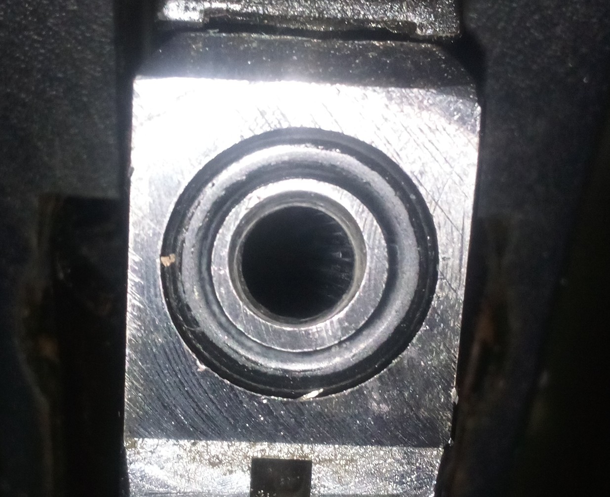

I tought if flying dragon gun he ( mike melneck ?) gave his lifetime gar run tee... Like thumper said as well some rws/dianas can be far worse / plumb sloppy.. i giess give a picturt of the crown end and see if somthing stands out ? Maybe take some steel wool and oil in the middle of 2 strings pull ot back and forth and polish the rifling to help remove and rough spots . Just dont use the steel wool dry, brass or copper is best but hard to find local here anymore.
Ya, a poor shooter aint much fun..

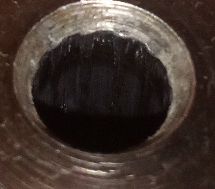

No expert here but that crown could use a polish.. looks kinda unfinished/ rough..
You could make a crown lapping tool and some grit paste and hand lap it pretty and maybe run some girt paste/ polish through the barrle some especially at that last inch of choke at the muzzle end...
No guarantee but some thing to try out ..

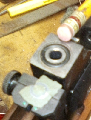

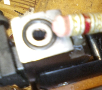

For these hatsans leades that has a sharp edge around the hole i used a #2 pencil eraser i shaped to bevel out that sharpness. Then spun it between the palms of my hands and cut w nice smooth bevel .
Ive used it .. just do a little test run and check results.. in the barrel bore id maybe use somthing else. Like metal polish or bore paste. But that crown face that compound should do .
Like i said im no pro just do and use what i got here available local at my own risk kinda thing.. heck i stooped to using brasso to clean a barrel out .. ( dont get that stuff on wood finish or any plastic/ seals/ orings ... That stuff cuts and fumes carry)..lol.
Anyway the rifling job you kinda want minimal removable more to a polish job you cut too much your too loose and could do more harm ( tolerance).
Good thing you were going to trash can that gun so its going to give you good experience in what you do to ot helps and thats great or your in the same boat ..
Dont think i never said oops on somthing i did... Lol. Thing is it wouldn't happen again and i now know better next time..
Should be some info at gta also on them guys recrowning or fixing up a crown and barrel polishing.. maybe help add some more ideas to your job.. lot more springer info to look at there. ( Plenty of them " experts" as well)🤤.
