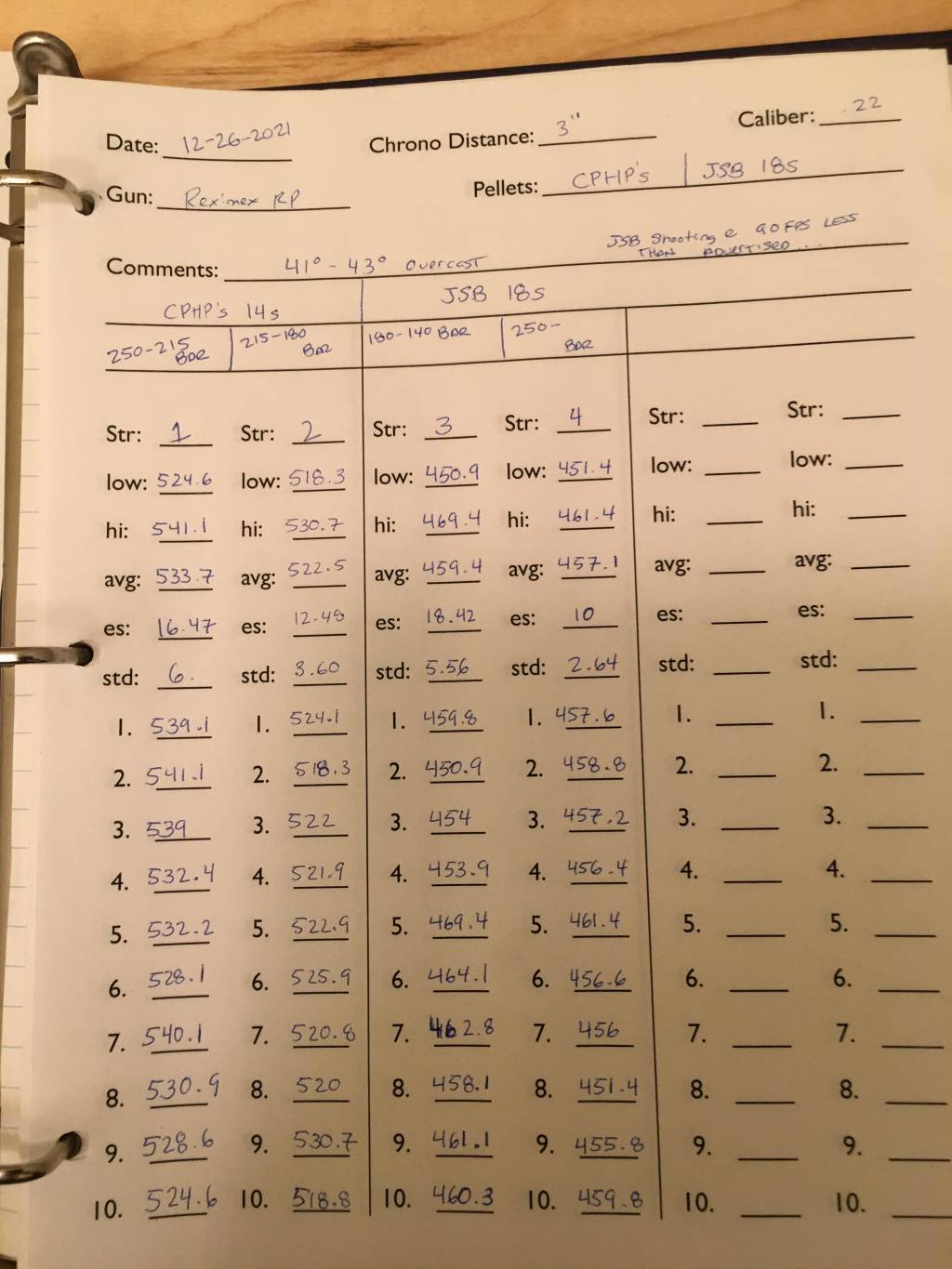

Alas she lured me with her sexiness, but she couldn't perform. I spent in inordinate amount of time sighting her in at 9 yards! She grouped really well, just not in the same place. Cleaned the barrel, switched out scopes, cleaned the barrel again. Still she would not group at last POA/POI. Groups great, just not in the same place. I pulled out my 1701p to see if it was me, at the same distance (9 yards) pellet on pellet with the 1701p. Giles gave it a great review and so did Airgun Bros. Definitely will be disregarding them going forward. Now to see how Aceros de Hispania and/or Reximex handle my situation. As I want a refund on this lemon or limon. Will chrono over the weekend to confirm numbers. But at the moment? Fellow AGN brethren beware!
she is shooting 90 FPS less than the 550 FPS advertised with the JSB Exact Jumbo 18s. Do any of you think that turning up the regulator will get me that added speed and more consistency. I will post up pics of what I'm seeing in the wandering groups.
