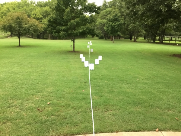

Second, based on your chosen magnification, you should practice/shoot as many different range distances as you can and actually verify where your pellet is hitting and where your hold-over should be on your particular reticle. Most competitive Field Target shooters will shoot in 1 or 2 yard increments up to about 35 yards and then 5 yard increments there after.

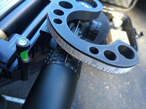

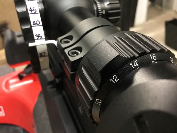

I start by installing a large side wheel on the SWAT turret. Then I put a piece of white electrical tape around the wheel. Using a 55 yard measuring tape (don’t use a range finder here.) I put target holders from 10 to 20 yards in one yard increments and five yard increments thereafter out to 55. The target holders have writing on them. Starting with the 10 yard marker, I focus the side wheel to where the letters of the words are sharp and clear. Then I mark the tape with that distance just above the pointer. I do this on each and every target holder.

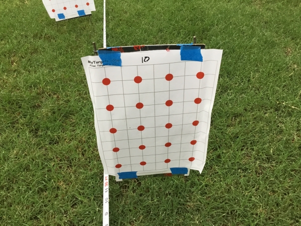

With zero set, I put targets with a 1” grid drawn, down from 10 to 20 yards in 1 yard increments. I then set my magnification at max (in my case x24)
i then shoot at the aim point. Then I look to see exactly where the point of impact is compared to point of aim. (I.e. 1-1/8 hold over)

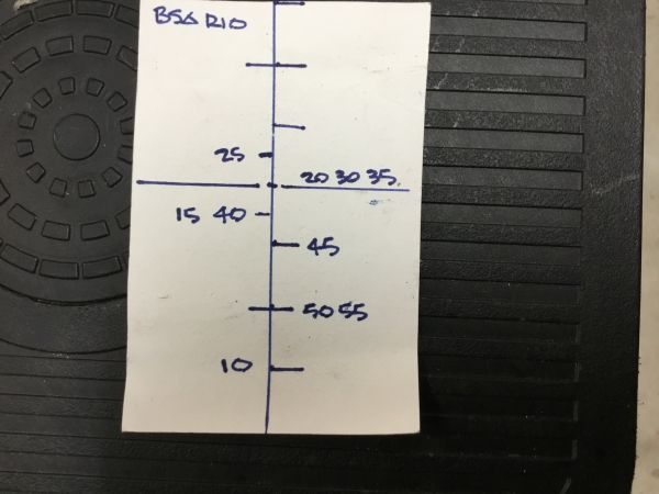

I make a range card with the image of the reticle noting where the point of impact is. I have many POI that are the same so I group them together.
Of course this was done on x24 and max magnification in HFT is x16. But remember, when using a FFP the hold over remains the same regardless of magnification. This is not true with SFP scopes. So now I can turn down the magnification to x16 and know the holdover is the same.
Basically, you can use the additional magnification to enhance the accuracy of the POI. Now you know the holdover is 1-1/8 mildot and not 1-1/2.

Like others said, you set it to 16x and don't touch it. You also don't click during the match.
You need to make yourself range card with picture of reticle and write down hold over points for 16x magnification. On left side from 10 yards to 0 and on right side from 0 to 55 yards.
You would look thru the scope at 16x at the target, move the wheel until target is in best focus, take distance reading from the side wheel and use appropriate hold over for aiming point.
I've made myself bigger 3-d printed comma wheel to get better resolution for distance reading, PM me if you would like 3-d file to print one for yourself.
