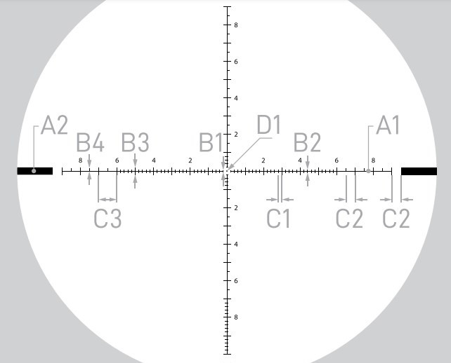

From what I see, most use SFP. I have seen FFP, this past weekend even. It is personal preference. Depends on what you like. Scopes should always be personal preference. What are you looking for in the reticle? If you like a larger reticle most of the time, and don’t want to do calculations when using the reticle, use FFP.
I actually prefer FFP all around, especially because it makes reticle subtension calculations faster. That being said, I use SFP in FT because of the higher magnification in Open class.

Some of the reasons for people not liking FFP is completely valid but they boil down to reticle design. Don’t write of FFP because some reticles are not to your liking, there are so many choices now with excellent reticles, plus personal preference also plays into this. I like a well designed Christmas tree reticle for HFT but many don’t. You really won’t know till you shoot a few matches with it.
Reticle in a FFP is important. I have always used a SFP scope because on the FFP most of the time I can't use the lower third power because the reticle can't be seen by my eyes. But for about a year I am using a FFP Athlon ares etr 3-18x50 It is a nice scope and the reticle can be used pretty good down on the low powers. A drawback is there is not a 16x graduation so I shoot it on 15x for HFT and at 15 the reticle is nice even for my old eyes. This is the best scope I have used for FT. Another drawback it is a big heavy scope, but my wolverine isn't a rifle I am going to be packing around anyway. I had it on my Taipan standard and it felt to big.
I recently made the change to FFP for HFT, I by no means have the experience that Motörhead has, but I like the scope, I like the size of the reticle when I’m at 16x, and for the money that I spent on it…I’m not in a rush to change back. I tend to only reduce it to 12x not any less, when shooting in the forced positions. Yes there is some wobbling, but I find that I can choose when to fire based on when I can repeatedly and predictably cross over the target zone, I time the shot with my heart beats, and breaths.
